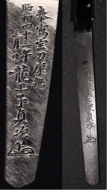

tagonagy Posted December 8, 2009 Report Posted December 8, 2009 I got a new sword that is signed "Ryu oji Minamoto Sadatsugu" I know that Takahashi Sadatsugu signed his swords this way. My question is whether the signature is authentic or Gimei. If it is Gimei, I plan on mounting this sword and using it for Iai. However, I don't want to risk it if this sword was really made by Sadatsugu. Any opinions? Quote

David Flynn Posted December 8, 2009 Report Posted December 8, 2009 I checked the signature against the one in John Sloughs book. Your one does appear to be gimei to me. However, I would compare more signatures first before I dismissed this sword. P.S. A gimei Sadatsugu was submitted at the Sydney Shinsa. Quote
ottou812 Posted December 8, 2009 Report Posted December 8, 2009 I wouldn't call it a gimei right away. John Slough's book has a mei from 1938. This particular one is Showa 35 which in 1960. John Slough's book doesn't have enough oshigatas for Sadatsugu. Quote
Mark Green Posted December 9, 2009 Report Posted December 9, 2009 Great looking sword. I would do some serious checking on this one, with people in the know! jmo,, Mark G Quote
drbvac Posted December 9, 2009 Report Posted December 9, 2009 I would certainly be in no rush to mount it for Iai either - even if gimei its a nice blade Quote

tagonagy Posted December 17, 2009 Author Report Posted December 17, 2009 I've looked through the web and my own books and found a mei of Sadatsugu's that I'm sure is authentic (the sword is from the Compton Collection). here is the mei of my sword. and the date. Any opinions? Authentic? Gimei? Quote
drbvac Posted December 17, 2009 Report Posted December 17, 2009 I put these together in order to make it easier to compare - Don't know - looks pretty good to me! Quote
John A Stuart Posted December 17, 2009 Report Posted December 17, 2009 Hi Brian, I see some differences even in the kakihan. I see some similarities too. I can't write my signature the same every time. So, not being well versed in this smith or even a calligrapher, it is impossible to tell. Even books devoted to one smith like say Okisato Nagasone make it hard to tell even with all the tell-tales. We had that very discussion not long ago. Do you think it is close enough? John Quote
drbvac Posted December 17, 2009 Report Posted December 17, 2009 Hi back John : Well agree with what you said, the experts should help, but at least the strokes seem in the right direction and within both mei seem to be the same weight etc, but - I can't tell well enough to be sure - that said I still wouldnt use it for practice! :? Quote
Jacques Posted December 18, 2009 Report Posted December 18, 2009 Hi, Please, have an attentive look at the quality of the yasurime and at the tagane makura. Quote
drbvac Posted December 18, 2009 Report Posted December 18, 2009 OK, I'll try to learn something - the yasurime are not as even or deep and at a slightly steeper angle on the blade in question, as to the tagane makura, I can;t tell whether considering the pictures and the angulation there is a big difference but would really like to read what you think? Quote
Ted Tenold Posted December 18, 2009 Report Posted December 18, 2009 As a point of consideration for folks when looking at any Gassan school sword; Gassan smiths are absolutely fastidious about their yasurimei and signature. It is not a matter of personal embellishment for them. As Jacques is elluding, one should really REALLY scrutinize everything to a fine degree with regard to these elements. Just a comment to help digest the images. Quote
drbvac Posted December 18, 2009 Report Posted December 18, 2009 Well then - as with the term "good enough" it probably isn't - or Close enough isn't (close at all )! Am I to understand with this school specifically it has to be very very close to identical to be acceptable, at least closer than many others, or in some cases individual smiths? I know I rarely sign the same way or even print the same but I guess considering the technique for cutting the mei there would be more attention to the details. Always interesting and educational - thanks Quote
Ted Tenold Posted December 19, 2009 Report Posted December 19, 2009 Dr. B., As occidentals we'd like to think that variations in signatures on swords should naturally carry variation, but signing a sword isn't like signing the monthly rent check. Inscribing a sword is the final touch on a very personal work. The sword is not *complete* without a properly finished nakago. Students are taught not only how to make swords, but in many schools they are taught specifically how to sign them and what with. Look at an Enomoto signature and you can see the striking influence of their Gassan education. Gassan Sadakatsu signed for his father for *decades* with only one known example of his own signature prior to 1918 that I know of, which I saw earlier this year and was a shoshin Meiji dated piece. Takahashi Sadatsugu was a student under Gassan Sadakazu *and* Gassan Sadakatsu. So how much variation should be reasonable? Very very little. When it comes to the Kao or monogram, even less so. Quote
nagamaki - Franco Posted December 19, 2009 Report Posted December 19, 2009 drbvac said: Inscribing a sword is the final touch on a very personal work. The sword is not *complete* without a properly finished nakago. Students are taught not only how to make swords, but in many schools they are taught specifically how to sign them and what with. Hello Ted, All, Please help me out here as the names ?? escape me at the moment, however, there is a famous story of a well known sword smith catching his neighbor, also a well known sword smith, forging his mei by simply recognizing the chiseling sound coming through an open window. That's how precise some these mei are repeatedly cut. Quote
