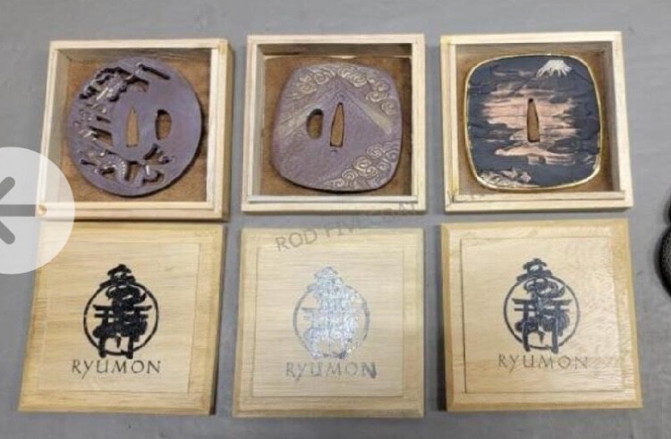

Pat5353 Posted June 17, 2024 Report Posted June 17, 2024 Allô is it real Japon tsuba or fake copie Chinese! Quote
ROKUJURO Posted June 17, 2024 Report Posted June 17, 2024 Patrick, the photo is not well focused, so details cannot be seen, but I think the 3rd TSUBA (on the right) looks non-Japanese to me. 1 Quote

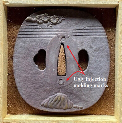

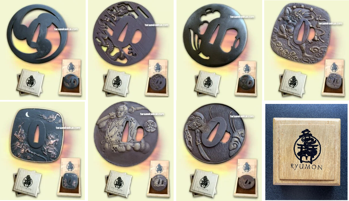

Jake6500 Posted June 17, 2024 Report Posted June 17, 2024 So this brand, Ryumon is a producer of kitchen knives and modern katana's. As far as I can tell they are a Chinese brand I think(?) based in Longquan, Zhejiang province. All of their products are modern ones with no historical value. https://www.swordsof...st.com/ryumon_1.aspx That said if you bought these modern Tsuba for display purposes and didn't pay too much, or bought them knowing they were modern pieces, I rather like them. 1 Quote
Spartancrest Posted June 17, 2024 Report Posted June 17, 2024 https://www.ebay.com/itm/235005954807 Like Jake has said - Chinese modern, If you paid the $55 ebay is asking you can buy real Edo [low end] for a little more money - [I suggest not through ebay though.] https://www.darkknig...ental-dragon-katana/ this shows the dragon tsuba made to fit replica swords. My advice if you see the box lid with RYUMON written on it - avoid!! What they don't show you in detail of the ura side! The company also doesn't mind stealing designs from Paul Chen Hanwei - modern copying modern. https://in.pinterest.../532621093405093939/ The Fuji-san one https://sbg-sword-st....com/product470.html Not very nice close up! Quote

Soshin Posted June 19, 2024 Report Posted June 19, 2024 On 6/17/2024 at 3:02 AM, Pat5353 said: Allô is it real Japon tsuba or fake copie Chinese! Expand All the above tsuba are poor quality modern Chinese reproductions. Quote
