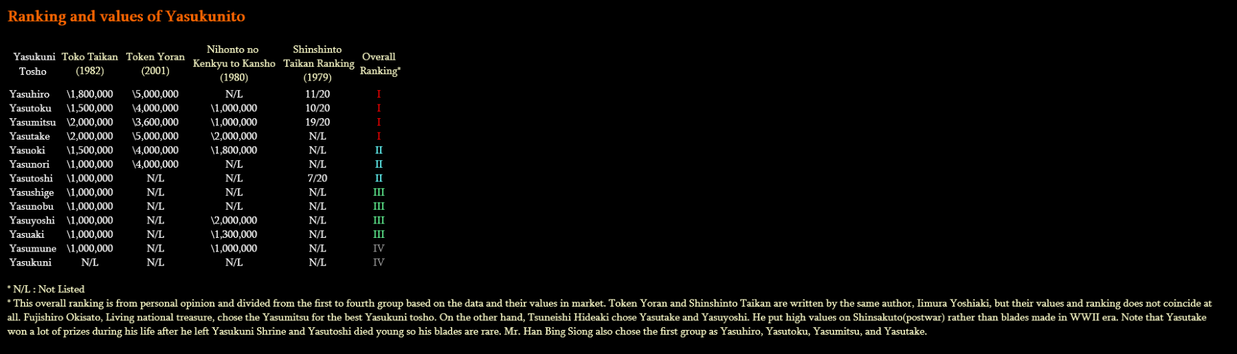

Volker62 Posted June 21, 2024 Report Posted June 21, 2024 on Imura Kashu ranking list Kajiyama Yasutoshi's rank is on number 7 surprisingly before all other's 1 Quote
PNSSHOGUN Posted June 21, 2024 Report Posted June 21, 2024 Another ranking of Yasukuni Tosho. http://www.jp-sword....kuni/yasukunito.html 1 Quote

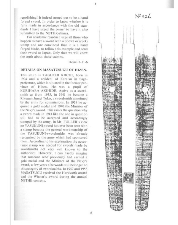

Volker62 Posted June 21, 2024 Report Posted June 21, 2024 maybe this makes things about Yasukuni clearer? a great collector here in europe and real expert once researched it. thank you Han Bing Siong 2 2 Quote
Brendan campbell Posted June 21, 2024 Report Posted June 21, 2024 This is a great read, well done for putting it on the site. I’m pleased to see I have a Sadashige just polished, in lida naval fittings and Norisada again new fresh polish. They have both turned out fantastic, I had a second Norisada , polished which I used in a deal for the Sadashige. 2 Quote
paul griff Posted June 21, 2024 Author Report Posted June 21, 2024 Excellent information in these posts..Thank you.. Paul. Quote
Volker62 Posted June 21, 2024 Report Posted June 21, 2024 with pleasure fellow collector's with the kind help of a well known collector from the Netherlands 1 Quote

Volker62 Posted June 21, 2024 Report Posted June 21, 2024 these excellently made blades simply lacked apprecation, even here in Germany by so called experts. 1 Quote
Volker62 Posted June 21, 2024 Report Posted June 21, 2024 it is thanks to collectors like Mr. Han Bing Siong that his research has uncovered what unfortunately despised for far too long Quote

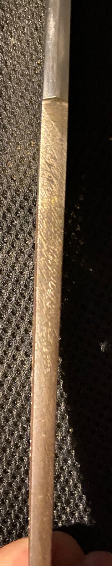

Nicholas Posted July 30 Report Posted July 30 @Conway S no stamps on the nakago at all. I believe it’s a gendaito. It looks like a good quality blade to me compared to the few examples I’ve seen online. Here are a few pics Quote
Conway S Posted July 30 Report Posted July 30 (edited) Anything on the nakago mune? I’ve viewed two in-hand and both had a sho stamp. The price wasn’t to my liking so I passed on them… hoping to have better luck next time. Congrats on the pick up! edit: May have been the Seki stamp I observed. Edited July 30 by Conway S Quote
Nicholas Posted July 31 Report Posted July 31 @Conway S Thank you. I haven’t seen many wartime Kanefusa gendaito Only Showato. Took a few pics with habaki off. No stamps whatsoever. Quote
