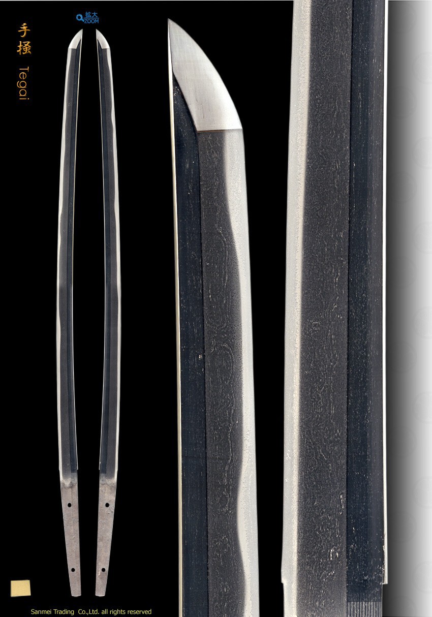

Scogg Posted June 19, 2024 Author Report Posted June 19, 2024 Thank you Jacques, that is a good observation. I'll be taking a take a close look this weekend. That Yamato Senjuin blade that you shared in a link earlier appears to have what looks like masame in the shinogi. Is that just a trick of the polish? The photography? Or my own inexperienced eyes? https://sanmei.com/c...27604_S2823_PUP.html Photo for reference: Quote
Jacques Posted June 19, 2024 Report Posted June 19, 2024 The hada of the Senjuin school is itame mixed with masame (sometimes hadatachi) the hada is the same in ji and shinogi-ji. 1 Quote

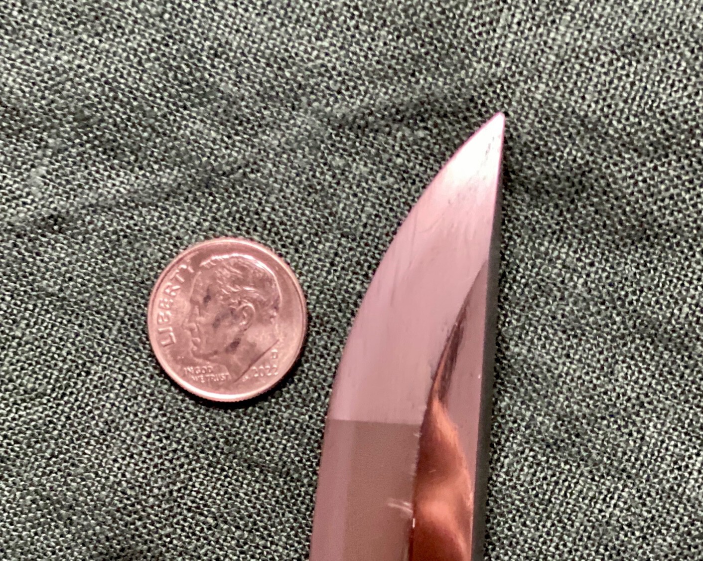

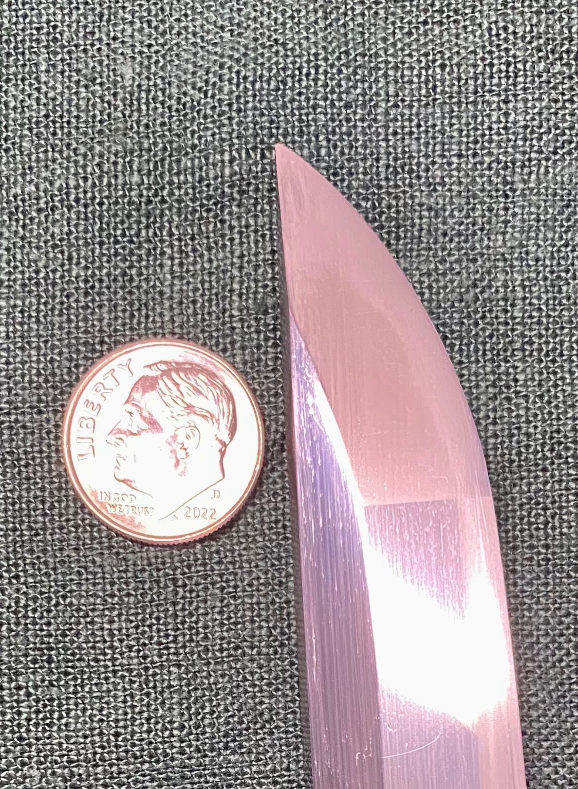

reinhard Posted July 2, 2024 Report Posted July 2, 2024 Hi Sam, When one gets stuck in kantei after having inspected sugata, hada and hamon, it is often helpful to have a close look at the boshi. It is often the most individual feature on a blade otherwise hard to pin down. Telling from your pics I see a pretty clear hakkikake/ kaen boshi. reinhard 1 Quote
Scogg Posted July 3, 2024 Author Report Posted July 3, 2024 Hi Reinhard, thank you! Good observation, and I agree, I also see hakikake boshi. I’m still stumped for now, but I am enjoying admiring the sword and looking into the possibilities. To address an observation made earlier in the thread: I carefully observed the shongi-ji, and am stumped if I’m seeing masame or evidence of burnishing from polishing. There is an open grain area that appears to resemble a continuation of the itame hada into the shinogi ji. I was unable to get a good photo of that, and I am unconvinced one way or the other. Thank you! Photos of kissaki near dime for scale, -Sam Quote
