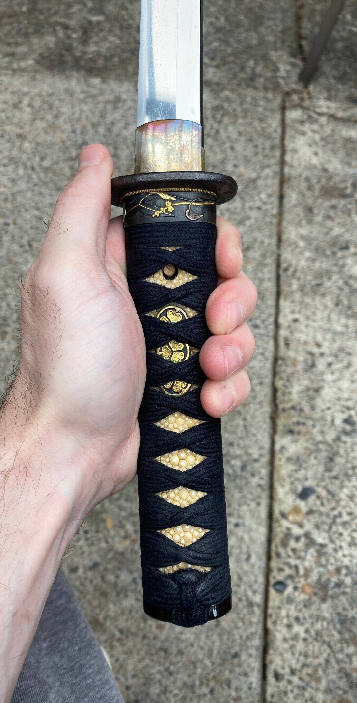

Scogg Posted June 16, 2024 Report Posted June 16, 2024 First of all, I like this sword. It checks many of my boxes. It reminds me of another wakizashi that I’m having professionally restored. It’s unpapered and mumei. I think KOTO and suriage. I’m getting Yamato vibes. Am I just seeing what I want to see, or am I on the right track? Nagasa: 51cm (20.2inch) Motohaba: 2.7cm Sakihaba: 1.75cm Kissaki length: 3.2cm Still working on photography. I need a lighting rig. Light and reflections seemed to be battling me on this one. It’s easier to admire and looks better in-hand. Cheers, -Sam 1 Quote

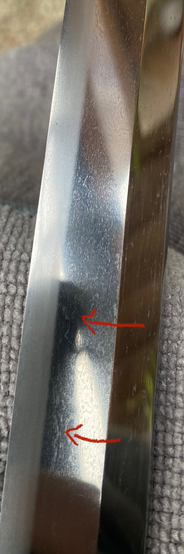

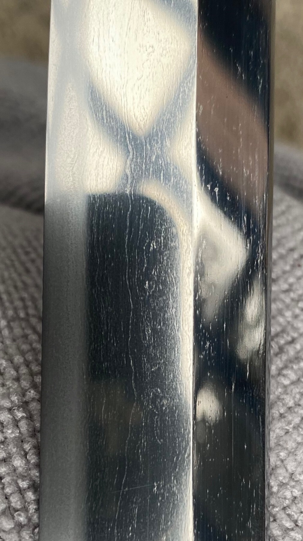

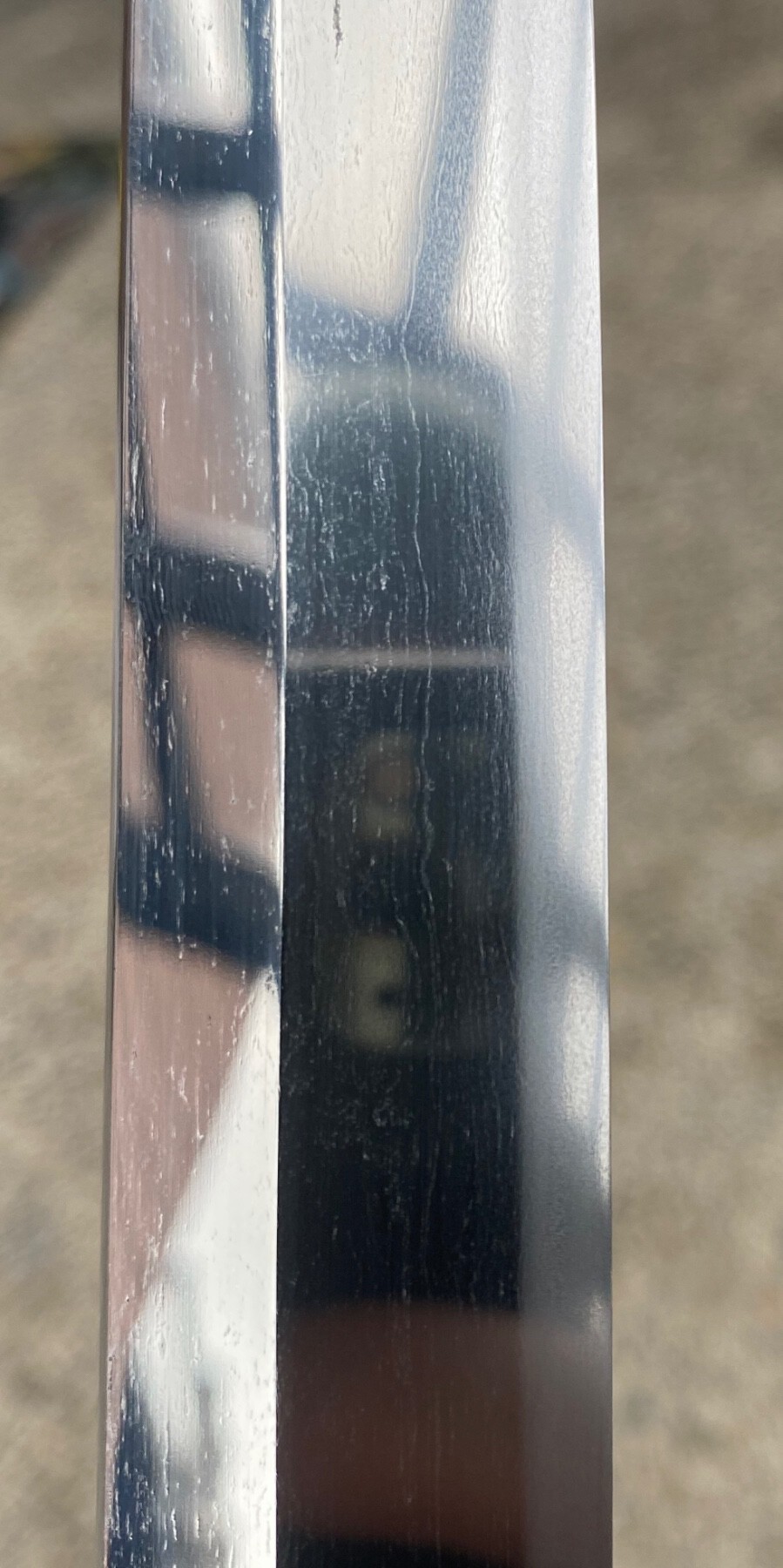

Scogg Posted June 16, 2024 Author Report Posted June 16, 2024 Has masame that’s more prevalent near the suguha hamon. Otherwise there’s some mokume and itame throughout. Some more closeup outdoor shots of the blade: 2 Quote
Lewis B Posted June 16, 2024 Report Posted June 16, 2024 Your blade is more like Yamato Shikkake than mine, which is papered for that den. The masame above the Hamon, which is absent for my blade, is a regularly cited feature. Would be interested to hear what others think. 3 Quote

Rivkin Posted June 17, 2024 Report Posted June 17, 2024 Yes, this is heavily Yamato blade with a strong presence of masame. Massive blade, almost straight, decent quality work. Its something interesting to look at hand. It looks like jigane is very consistent, quite bright, long masame, seen everywhere, no clear kizu. At the same time it does not convey a feeling of strong ji nie, its a bit less bright. Hamon shows good separation into lines, good flow but again it is not made from bright and large nie, but more ko nie. I suspect its kambun shinto Sendai or comparable smith. That would be my 50% bet. If not, its a high grade Tegai work... maybe 1380s. 20%. Kai Mihara... 30% probability. Shikkake needs periodic gunome. Mokume with sharp angles is usually shinto work in koto style. 1 1 Quote
Jacques Posted June 17, 2024 Report Posted June 17, 2024 I can't say for sure, as these are just photos, but it seems to me that there's a lot of open grain, which indicates a low level of quality. Quote I suspect its kambun shinto Sendai or comparable smith. That would be my 50% bet. If not, its a high grade Tegai work... maybe 1380s. 20%. Kai Mihara... 30% probability. Expand Since you don't know which school it is, you announce the schools at random, hoping that one of them will be the right one. Quote

Jacques Posted June 18, 2024 Report Posted June 18, 2024 I have a question: does this line run along the entire length of the blade and on both sides? Quote
Scogg Posted June 18, 2024 Author Report Posted June 18, 2024 Thank you @Jacques D., and good question. I took my sword out this morning to investigate the shinogi height, and also that line. The line appears on both sides where masame is most heavy, but not in the same area (they don't mirror each-other by any means). It does not extend the entire blade. It fades into itame/mokume after a few inches toward the kissaki. Upon inspection of the JI, it seems the masame is mostly toward the hamachi, and in the middle of the blade. Toward the kissaki it blends into itame and/or mokume with more intermittent masame. This is just my observation. More experienced eyes may vary! I couldn't get great photos, i'll have to wait for another nice day. Here’s a highlight from my previous photos where that line appears to end on that side. I know photos are not ideal for Nihonto, but the discussion does help me learn. Thank you! Quote

Char Posted June 18, 2024 Report Posted June 18, 2024 On 6/18/2024 at 1:29 PM, GeorgeLuucas said: Thank you @Jacques D., and good question. I took my sword out this morning to investigate the shinogi height, and also that line. The line appears on both sides where masame is most heavy, but not in the same area (they don't mirror each-other by any means). It does not extend the entire blade. It fades into itame/mokume after a few inches toward the kissaki. Upon inspection of the JI, it seems the masame is mostly toward the hamachi, and in the middle of the blade. Toward the kissaki it blends into itame and/or mokume with more intermittent masame. This is just my observation. More experienced eyes may vary! I couldn't get great photos, i'll have to wait for another nice day. Here’s a highlight from my previous photos where that line appears to end on that side. I know photos are not ideal for Nihonto, but the discussion does help me learn. Thank you! Expand In regard to that line for quick reference a yamato school Taima mukugitae construction? sold at auction yesterday at Aoi still retained Juyo status. 1 Quote
Jacques Posted June 18, 2024 Report Posted June 18, 2024 I asked this question because this line could be a sign of makuri construction. If so, this sword would be from the Muromachi period and not Yamato. 1 Quote
Scogg Posted June 18, 2024 Author Report Posted June 18, 2024 Interesting, thank you. Short answer is no, it does not extend the whole blade and is not the same on both sides. At least not to my novice observation. Muromachi would not hurt my feelings. This sword only put me back hundreds, not thousands. Muromachi was actually my first impression - but i'm not drawing any concrete conclusions until I get this sword into someones hands or Shinsa. What's your current opinion on age and school @Jacques D.? I understand photo kentai will be far from definitive. I appreciate your expertise and input, Cheers, -Sam Quote
Jacques Posted June 18, 2024 Report Posted June 18, 2024 I never kantei a sword without having it in hands. That said, yours could be sue koto and Mino would not be impossible it has most certainly been suriage (the photo of the nakago mune speaks for itself). Now, to be frank, it's not very high quality: there are too many open grains, which indicates a lack of mastery in the forging process. 1 Quote
Scogg Posted June 18, 2024 Author Report Posted June 18, 2024 Fair enough, and thank you! I think Sue Koto Mino does make sense. I appreciate the frankness - I wouldn’t be here if I weren’t prepared for that Thanks again, much appreciated! Slowly but surely I’m learning a little every day. Cheers, -Sam 1 Quote
