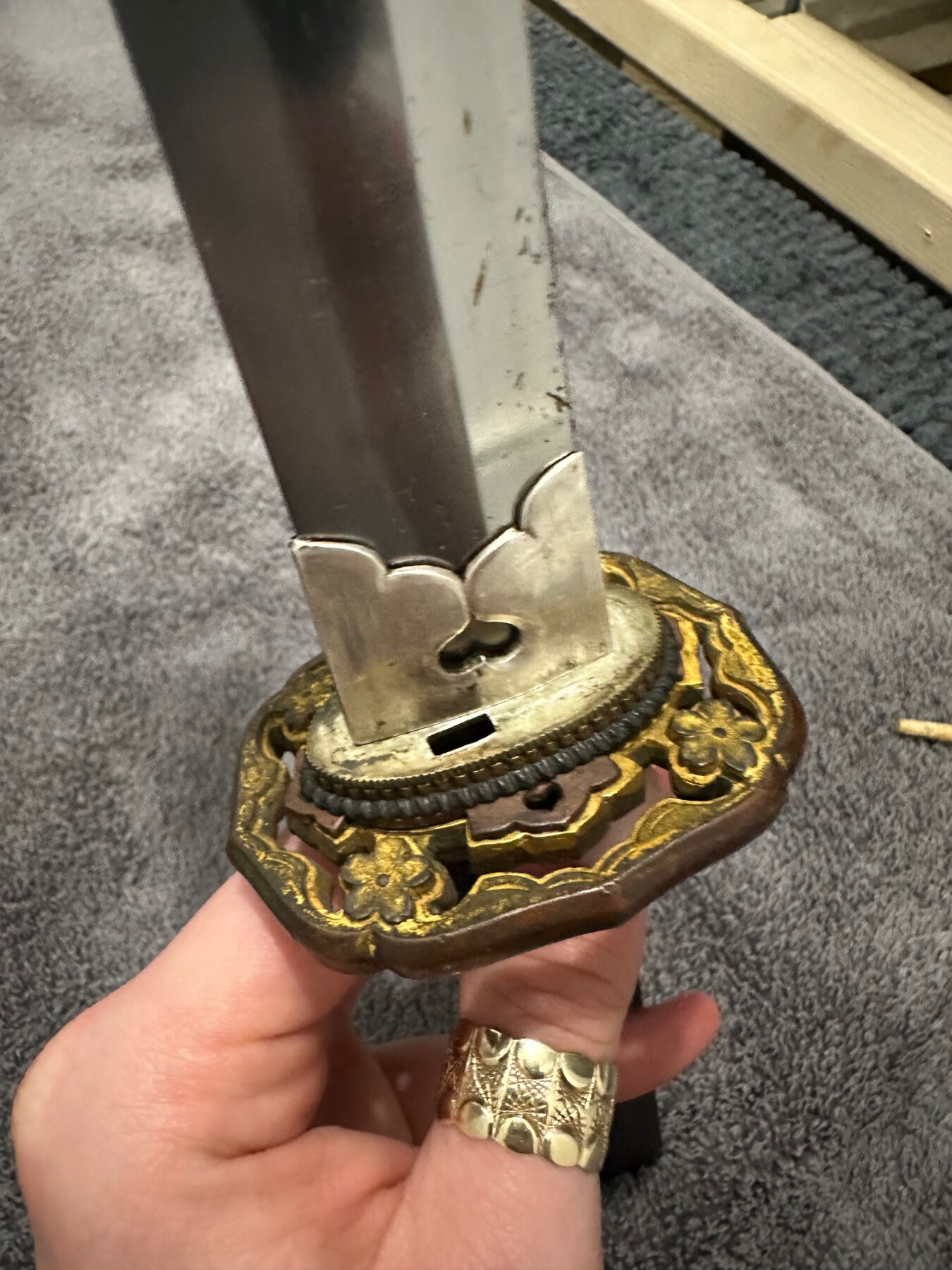

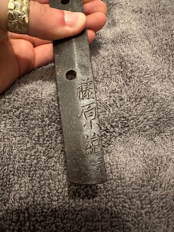

Myles Posted June 11 Report Share Posted June 11 Hey! I have a strong background on the sword already, circa 1680, indicates ties to a Major to Colonel ranking officer & ties to a samurai family emblem/clan (as seen in the images - silver emblem on the top mount) the swordsmith was translated to be Fujiwara Tsonayuki, as well as an element of the translation saying Kanji. Just after anymore information or conflicting opinions if you have any! As well as any further translation & valuation. Thank you in advance 2 Quote Link to comment Share on other sites More sharing options...
Ray Singer Posted June 11 Report Share Posted June 11 Myles, the reading should be 藤原綱行 - Fujiwara Tsunayuki. This is a Bungo Takada (Fujiwara Takada) blade, and is a suriage (shortened) blade from Shinto times (early part of the Edo period). Unsure what is mean by this: "an element of the translation saying Kanji" 2 Quote Link to comment Share on other sites More sharing options...
Kiipu Posted June 11 Report Share Posted June 11 Ray, I think they mean that the characters are written in kanji? Quote Link to comment Share on other sites More sharing options...
Myles Posted June 11 Author Report Share Posted June 11 I believe so yes, My main aim it the emblem/silver badge located on the top mount, what clan/family this belongs to so I can ascertain more history on the piece, Very happy with it overall - & what is advised to care for the blade, valuations etc anything there is I need to know really as I’m relatively new to the samurai sword world so far Quote Link to comment Share on other sites More sharing options...

ROKUJURO Posted June 11 Report Share Posted June 11 Myles, the silver MON does not necessarily have to do with a SAMURAI family. A family could choose a badge they liked in later times. Quote Link to comment Share on other sites More sharing options...
Ray Singer Posted June 11 Report Share Posted June 11 I wouid consider that this might not be a kamon, and is instead a surname. Naka___ (reading of the second kanji is unclear). 2 Quote Link to comment Share on other sites More sharing options...
SteveM Posted June 11 Report Share Posted June 11 中野 Nakano 4 1 Quote Link to comment Share on other sites More sharing options...
