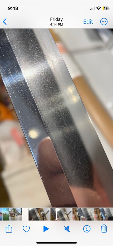

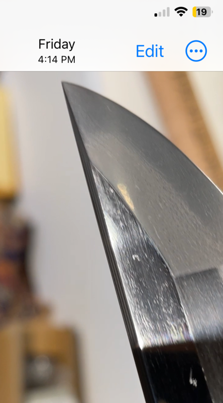

Lewis B Posted June 9, 2024 Report Posted June 9, 2024 Found this sword at the Japan Art Expo. Attributed to Yamato Shikkake with Sayagaki by Tanobe. Approx 70.6cm Nagasa, 3.03 Motohaba, 2.2 Sakihaba I won't have the sword in hand to take more detailed pics of the blade or nakago but these are a couple of screenshots from the video I shot. Hopefully I made a good choice and happy to receive your thoughts. 8 Quote
Rivkin Posted June 9, 2024 Report Posted June 9, 2024 I think its a good sword. Shikkake is overall a good school, jigane is nice, utsuri is nice. Hamon is not too active but also the light angle is kind of difficult (i.e. wrong) for this type of work - its best to photograph shikkake hamon in "white light", i.e. light source directly above the blade. It shows whether nie is fine grained, coarse, how long are nijuba lines etc. P.S. I think I know this blade. It was sold at auction in Japan about three years ago. 1 Quote
Jacques Posted June 9, 2024 Report Posted June 9, 2024 For what i can see hada is typical for Shikkake ha : itame near the shinogi and masame near the nioiguchi (the whole being slightly hadadachi). No utsuri in this school. Quote
Lewis B Posted June 9, 2024 Author Report Posted June 9, 2024 13 minutes ago, Rivkin said: I think its a good sword. Shikkake is overall a good school, jigane is nice, utsuri is nice. Hamon is not too active but also the light angle is kind of difficult (i.e. wrong) for this type of work - its best to photograph shikkake hamon in "white light", i.e. light source directly above the blade. It shows whether nie is fine grained, coarse, how long are nijuba lines etc. P.S. I think I know this blade. It was sold at auction in Japan about three years ago. Thanks. I appreciate the comments. The videography was less than ideal. And the lighting also quite poor. You're right the hamon is not the most active although it is possible to see sunagashi and short kinsuji in real life. This could be that sword. The papers are over 3 years old. It has 3 mekugi-ana and the nakaga is really clean with a nice even black yokan-iro. Tanobe gave it a positive sayagaki and told the dealer it had a good chance of passing Juyo (for what that is worth). Quote
Lewis B Posted June 9, 2024 Author Report Posted June 9, 2024 52 minutes ago, Jacques D. said: For what i can see hada is typical for Shikkake ha : itame near the shinogi and masame near the nioiguchi (the whole being slightly hadadachi). No utsuri in this school. So if I interpret your comment, with all other aspects being correct for the school, the utsuri is likely 'enhanced' as there are examples with that feature (see below) and will largely disappear the next time its polished? Andrew I. brought this subject up a couple of years ago saying swords were appearing with chemically applied utsuri. Being a surface treatment, they will disappear when the blade is polished as real utsuri extends deeper into the structure of the blade. Tanobe's reaction I would have expected to be less than complimentary as he would certainly have recognized this inconsistency within the school. If thats the case here then its not too concerning as the rest of the blade is in nice condition and without kizu. Although utsuri has been described in late Kamakura Shikkake blades like this Juyo papered one as well as several others. https://www.aoijapan...kkake-yamato-school/ Quote
Rivkin Posted June 9, 2024 Report Posted June 9, 2024 1 hour ago, Lewis B said: Tanobe gave it a positive sayagaki and told the dealer it had a good chance of passing Juyo (for what that is worth). Its hard to argue against such assessment but generally the current shinsa atmosphere is hard and shikkake is both not a famous school, i.e. the attribution does not advance Juyo chances, but its also highly competitive. They did good work and very seldom one encounters mass items like with Tegai. In 1970s this would be easily a Juyo. 1 1 Quote
mywei Posted June 10, 2024 Report Posted June 10, 2024 Looks like a good blade from the photos Re: Juyo, good length and if the pics are representative of the rest of the blade, worthwhile submitting at least but as stated above the bar seems quite high of late. Usually only one or two Shikkake pass each year (more likely if attributed to a smith like Norinaga) 1 Quote

Franco Posted June 10, 2024 Report Posted June 10, 2024 Greetings, Utsuri, ok. Please tell us exactly what kind of utsuri we're supposed to be seeing here? I see a light colored haze below the shinogi, but I'm not ready to call that utsuri. Regards Quote
Lewis B Posted June 10, 2024 Author Report Posted June 10, 2024 46 minutes ago, Franco D said: Greetings, Utsuri, ok. Please tell us exactly what kind of utsuri we're supposed to be seeing here? I see a light colored haze below the shinogi, but I'm not ready to call that utsuri. Regards I agree, there is some further investigation needed here. The dealer called it utsuri (and it does have some characteristics such as the fading in and out depending on the light and angle of viewing) but to my eye its just too intense, especially as I now know, for Shikkake. I read Markus Sesko's treatise on utsuri and I will use this a basis for further investigation. I don't think it was the chemically applied as a means to deceive as the jihada stands on its own. The togishi I showed the video to suggested the polish might have accentuated this effect, so further study is necessary and to provide a plausible explanation. The jihada in the screenshot is representative of the entire blade and its consistency is what caught my immediate attention. There were no ware that I could detect unlike the 'good in parts' Ko Uda I inspected. Quote
Franco Posted June 10, 2024 Report Posted June 10, 2024 Hello, Thank you for this explanation. Yamanaka does not describe Yamato Shikkake swords as having utsuri. Earlier swords are described as having ji-nie and chikei. Regards Quote
Jacques Posted June 10, 2024 Report Posted June 10, 2024 10 hours ago, Lewis B said: So if I interpret your comment, with all other aspects being correct for the school, the utsuri is likely 'enhanced' as there are examples with that feature (see below) and will largely disappear the next time its polished? Andrew I. brought this subject up a couple of years ago saying swords were appearing with chemically applied utsuri. Being a surface treatment, they will disappear when the blade is polished as real utsuri extends deeper into the structure of the blade. Tanobe's reaction I would have expected to be less than complimentary as he would certainly have recognized this inconsistency within the school. If thats the case here then its not too concerning as the rest of the blade is in nice condition and without kizu. Although utsuri has been described in late Kamakura Shikkake blades like this Juyo papered one as well as several others. https://www.aoijapan...kkake-yamato-school/ Shikkake School never produced utsuri it's a mistake in the description (usual for this site) here a list of schools which produced utsuri NIE UTSURI Awataguchi Rai Taima Hôjôji SHIRAKE UTSURI Kanabo Sengo (faible) Shiga (Yamada Seki) Akasaka Senjuin Zenjo Seki Kanemoto Seki Kanesada Hachiya Kanefusa Kanetsune Gassan Fujishima Uda Motoshige Omiya (faible) Kongobei Miike Yukihira Takada Naminohira JIFU UTSURI Ohara Ukai MIDARE et CHOJI UTSURI Ko Bizen Ichimonji Osafune Yoshii Hatakeda Wake no Sho, Nitta no Shô BO UTSURI Osafune Aoe, en Nanbokuchô avec quelques éléments midare Yasuyoshi (Sa) Mihara DAN UTSURI Niô 2 1 Quote
Rivkin Posted June 10, 2024 Report Posted June 10, 2024 Looks like classic shirake utsuri. Yes, unusual for the school but definitely not unknown. Generally in Yamato utsuri is not too common and if present it tends to be Senjuin, Hosho or at least Tegai. For Shikkake and to some extent Taima shirake utsuri by itself can throw kantei to things like Uda or Hokke but the blade here has strong mainline Yamato feel. Quote
Lewis B Posted June 10, 2024 Author Report Posted June 10, 2024 10 hours ago, Rivkin said: Looks like classic shirake utsuri. Yes, unusual for the school but definitely not unknown. Generally in Yamato utsuri is not too common and if present it tends to be Senjuin, Hosho or at least Tegai. For Shikkake and to some extent Taima shirake utsuri by itself can throw kantei to things like Uda or Hokke but the blade here has strong mainline Yamato feel. Beginning to agree with your assessment. I found this Shikkake with an almost identical whitish area under the shinogi, albeit a little less intense. https://www.invaluab...ana-195-c-10840c2ab4 Quote

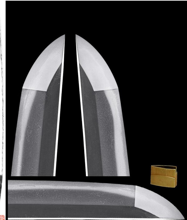

Franco Posted June 11, 2024 Report Posted June 11, 2024 Could we please see images of the entire sword? Thank you. Regards p.s. after viewing this video over and over it reminds me of only one other sword I've seen, a tanto. 1 Quote
Lewis B Posted June 11, 2024 Author Report Posted June 11, 2024 26 minutes ago, Franco D said: Could we please see images of the entire sword? Thank you. Regards p.s. after viewing this video over and over it reminds me of only one other sword I've seen, a tanto, which wasn't a Yamato Shikake blade. Yes definitely. As soon as I collect it from a dealer in Utrecht on Saturday I'll post pics showing the sugata. Please let me know if you remember the attribution of the Tanto. The TH papers clearly attribute the sword to Shikkake as does Tanobe's sayagaki. The jihada and sugata are VERY similar to some other (not all) Shikkake blades including Juyo ones I've seen online. I think this sword will be a very interesting subject for further study. 32 minutes ago, GeorgeLuucas said: Color me jealous... Lovely sword Lewis! It checks many of my personal boxes. Thank you for sharing! Cheers, -Sam Thanks Sam. I immediately appreciated its quality as soon as I set eyes on it. I would be lying if I said Tanobe's positive response to the blade didn't influence the decision to purchase it to start me on my nihonto collecting journey. 3 Quote

Jacques Posted June 11, 2024 Report Posted June 11, 2024 It doesn't look like an utsuri to me, but an uchiko applied a little too violently and having attenuated the nugui. But without having the sword in hand, I can't be sure. 2 Quote
Franco Posted June 11, 2024 Report Posted June 11, 2024 1 hour ago, Lewis B said: Please let me know if you remember the origin of the tanto. The tanto was attributed to Ko Uda. This blade was excellent and unlike any other Ko Uda I've ever seen. 1 hour ago, Lewis B said: The TH papers clearly attribute the sword to Shikkake as does Tanobe's sayagaki. Regards Quote
Jussi Ekholm Posted June 14, 2024 Report Posted June 14, 2024 I would agree with Jacques that I don't think it is utsuri. However I cannot explain what it is or what creates an effect like this. However it is nice looking sword in overall. 😊 1 Quote
