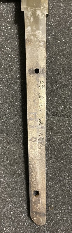

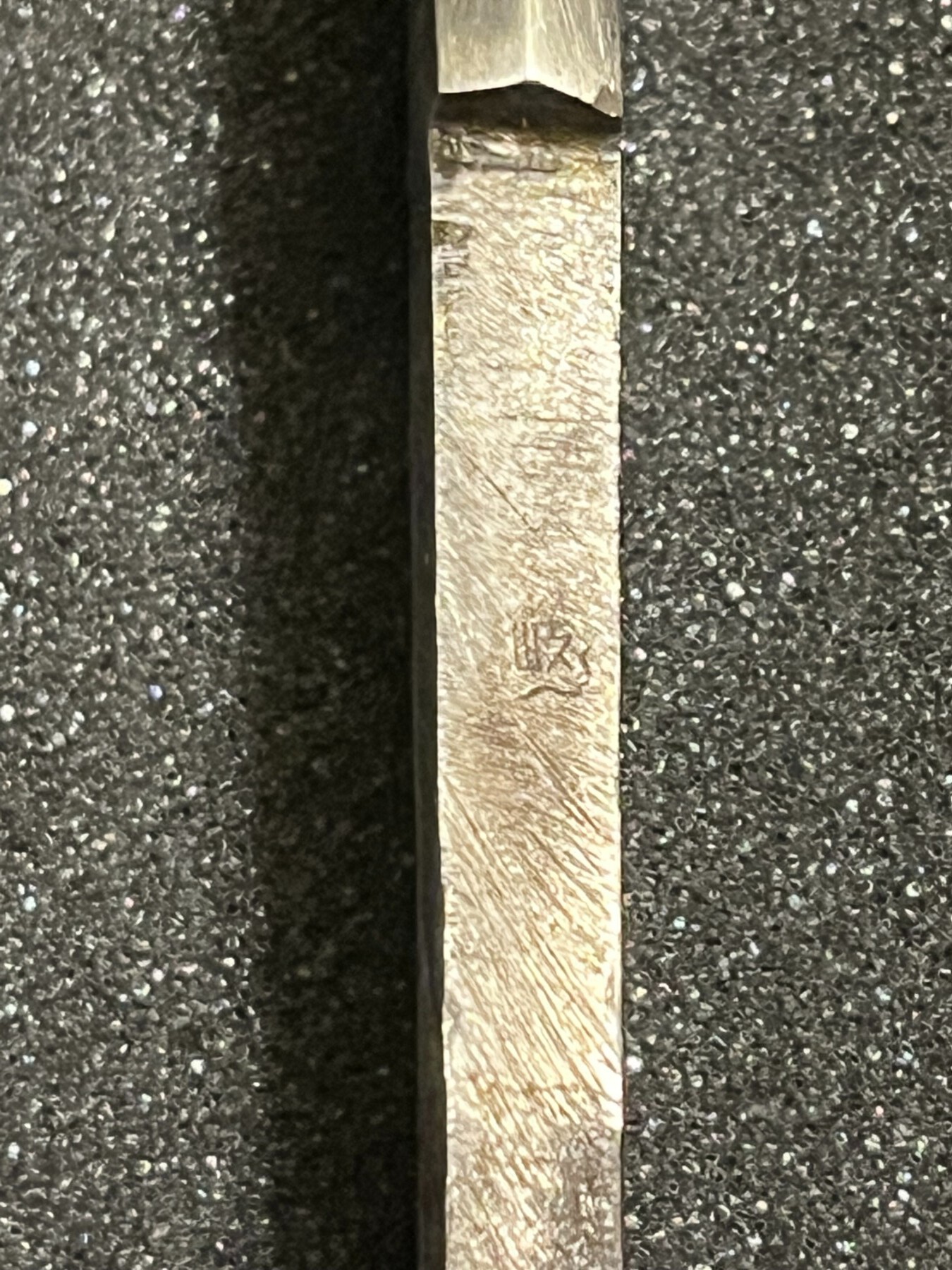

I just got a blade with a gifu stamp on the nakago (tachi mei) AND the back edge. Never seen that before. This is on a type 3 RS. Dated June of 1945 (Showa Ni Jyu Nen Roku Gatsu) 昭和二十年六月 <-- latest date I have owned.
Looks like Yoshisada?  I only have 1 other June 1945 with Gifu.  It is the latest date on file for the stamp.

Have you ever seen the Gifu stamp on the mune?
