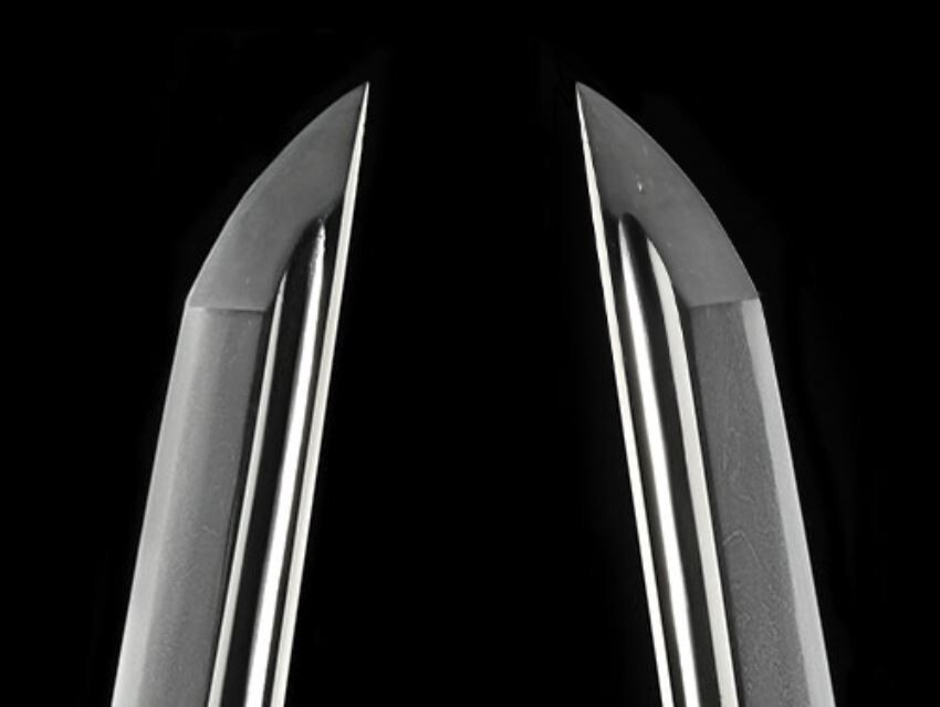

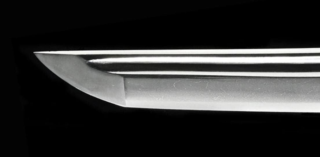

nulldevice Posted June 6, 2024 Report Posted June 6, 2024 I'm looking at this late-kamakura era tachi and it seems to me that the bohi extends past the ko-shinogi. Does this look like the kissaki has been reshaped? Something just looks weird about the bohi to me. Most of the hisaki-agaru bohi I've seen don't extend past the shinogi in the kissaki like this one does. Quote
Ray Singer Posted June 6, 2024 Report Posted June 6, 2024 Yes, the kissaki has clearly been reduced. This is not how the kissaki was originally structured, however it is also not a very significant problem in terms of the importance of a sword. You can see a similar feature in the tokuju Enju Kunitoki from the Compton collection. 6 Quote
nulldevice Posted June 6, 2024 Author Report Posted June 6, 2024 On 6/6/2024 at 3:54 PM, Ray Singer said: Yes, the kissaki has clearly been reduced. This is not how the kissaki was originally structured, however it is also not a very significant problem in terms of the importance of a sword. You can see a similar feature in the tokuju Enju Kunitoki from the Compton collection. Expand Thanks for the confirmation! Good to know that it's not considered a major flaw. Quote
Grey Doffin Posted June 6, 2024 Report Posted June 6, 2024 Looks like at least a cm of the original kissaki is lost. Odds are good the boshi is gone also and you're seeing a cosmetic boshi, added by the polisher. Many tachi from Kamakura and earlier have this problem. It isn't fatal but isn't insignificant either. Grey 3 Quote
Matsunoki Posted June 6, 2024 Report Posted June 6, 2024 On 6/6/2024 at 5:26 PM, Grey Doffin said: It isn't fatal but isn't insignificant either. Expand Grey, just seeking clarification/education here. I always thought (wrongly?) the total loss of a boshi was considered technically fatal. Is it forgiven if the sword is historically significant? I know several important swords have this damage but are still (very) important swords. I’m just confused. Thanks. C. Quote
Jacques Posted June 6, 2024 Report Posted June 6, 2024 On 6/6/2024 at 3:54 PM, Ray Singer said: Yes, the kissaki has clearly been reduced. This is not how the kissaki was originally structured, however it is also not a very significant problem in terms of the importance of a sword. You can see a similar feature in the tokuju Enju Kunitoki from the Compton collection. Expand I would like to know what makes you think that this kissaki has been reshaped? Quote
Brian Posted June 6, 2024 Report Posted June 6, 2024 On 6/6/2024 at 6:00 PM, Jacques D. said: I would like to know what makes you think that this kissaki has been reshaped? Expand Because the hi cuts right through the ko-shinogi. Now hi that go far forward are not that uncommon. But breaking the ko-shinogi is. And it is not that aesthetically pleasing. Which implies either the kissaki was taken back to where it is now, or the hi is atobori. But why would someone do that, knowing it looks odd? Hence the most logical explanation is the kissaki was shortened. And since we can't see the boshi...that is a valid supposition. Doesn't mean it's 100% correct, but it is a completely valid assumption. Are you now going to go searching for as any swords as you can with extended hi? 5 Quote

Ray Singer Posted June 6, 2024 Report Posted June 6, 2024 On 6/6/2024 at 6:00 PM, Jacques D. said: I would like to know what makes you think that this kissaki has been reshaped? Expand This. 3 1 1 Quote
Jacques Posted June 6, 2024 Report Posted June 6, 2024 That's a good point, but wouldn't it be a fault in the engraving of the hi in the case of an atobori? As far as I can see, the proportions of the kissaki look just right. As always, without seeing the blade.... Quote
Ray Singer Posted June 6, 2024 Report Posted June 6, 2024 No it would not be the case of a smith or horimono-shi intentionally running past the ko-shinogi. There's no reason to do that, and it's not something that would happen by accident. The kissaki has been lowered to a degree where the bo-hi runs into the kissaki itself. 4 1 Quote
nulldevice Posted June 6, 2024 Author Report Posted June 6, 2024 I imagine that intentionally starting the hi on the angled part of the kissaki and not following the shinogi would both be unaesthetic as well as difficult to drag the carving knife from an angled portion on the blade onto the shinogi-ji and then follow the shinogi down the rest of the length of the blade. It just seems impractical to me. Unfortunately the pictures available of this blade don't clearly show the boshi. They state it is sugu yakitsume but its hard to tell from the pictures. If the blade was shortened from the tip and the kaeri was lost, can you really state that its yakitsume? I won't claim to know better than the folks who have this blade in hand. The pictures just don't answer those questions for me. Quote

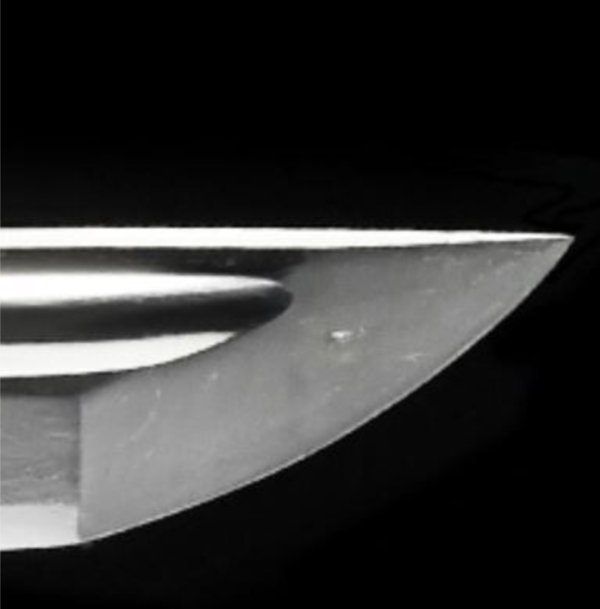

Brian Posted June 7, 2024 Report Posted June 7, 2024 It's fairly obvious that the kissaki was reshaped. Note the transition and dip in the area circled. Also, could be imagining things, but I see what could be the boshi on the left side, thin and likely left over from what was much more originally. Quote
Bugyotsuji Posted June 7, 2024 Report Posted June 7, 2024 Does anyone else see a difference in the angles and lengths of the Yokote on either side? 1 Quote
Gakusee Posted June 7, 2024 Report Posted June 7, 2024 On 6/7/2024 at 7:13 AM, Bugyotsuji said: Does anyone else see a difference in the angles and lengths of the Yokote on either side? Expand Yes Quote
Jacques Posted June 7, 2024 Report Posted June 7, 2024 What surprises me is that the polisher didn't adapt the koshinogi to the hi. I've had kissaki repaired, and you can't tell it's been done. Once again, judging by photos is nothing more than the art of divination. 2 Quote
Franco Posted June 7, 2024 Report Posted June 7, 2024 On 6/7/2024 at 9:27 AM, Jacques D. said: What surprises me is that the polisher didn't adapt the koshinogi to the hi. Expand Each case is going to present its own challenges. The bo hi do not appear to have been perfectly symmetrical and lined up to each other on both sides. One side seems to run slightly deeper towards the tip than the other. Then, there has to be consideration for the distance from the tip to the ko shinogi across the top in relation to the placement and length of the yokote combined with how much boshi there is left to work with. Not an easy or simple task for the polisher especially if the hi are not perfectly aligned and now run into the kissaki. There is that, plus, we don't know what other challenges there may have been from previous polishes for the current polish/polisher. An excellent polisher will attempt to correct all previous polishing mistakes. There is only so much metal to work with. Regards 2 Quote
