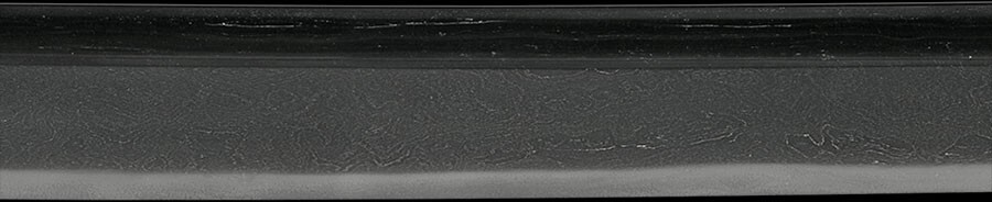

Those images are exactly what I'm looking for , especially the detailed shots under different lighting conditions. I wonder what aspect of the blade moved it into Den territory.

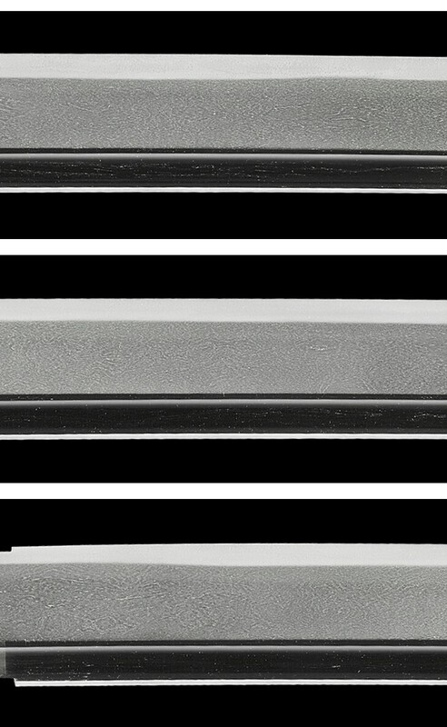

JT24 - Soshu Yukimitsu
image.thumb.jpeg.b380361e218da163e3580d7c5d092ba8.jpegimage.thumb.jpeg.ed32aa3df34a4af477f22e33fb08b222.jpeg
JT8 - den Yukimitsu
image.thumb.jpeg.aaa7ff9a1ea45c924b4bc0080df8c787.jpegimage.thumb.jpeg.e2f842c6830a45ca661bbff4b66a240a.jpeg

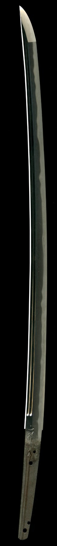

JT20 - den Soshu Yukimitsu
5.thumb.jpg.6be3cdaf3e351a0f7a37f8b1c978caa8.jpg6.thumb.jpg.ed1a01a6b8f8b9e03081613337490f23.jpg7.thumb.jpg.5fcbf99d9cce056428fc52ab807a9537.jpg

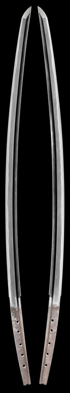

JT - den Soshu Yukimitsu
10.thumb.jpg.16f309364a751d4f9aee0e87295eb571.jpg9.thumb.jpg.a641f69ea6f34ae9362a8c93e49142c1.jpg8.thumb.jpg.5868ff3398fdcff626de97098e061f7e.jpg
JT67 - Soshu Yukimitsu
