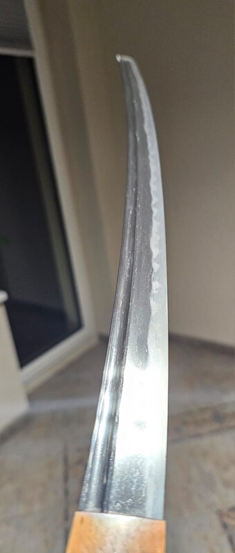

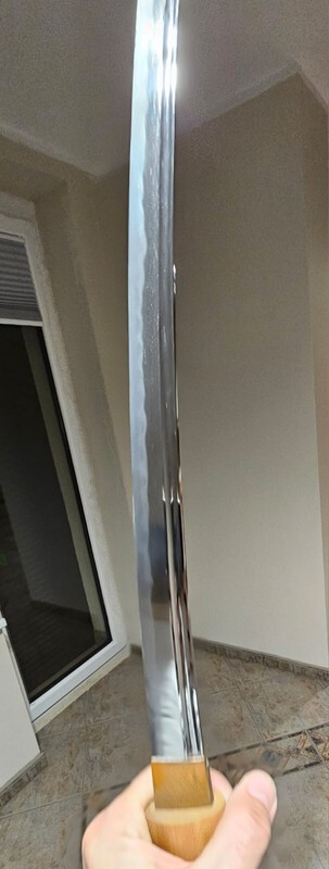

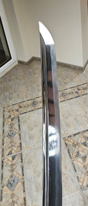

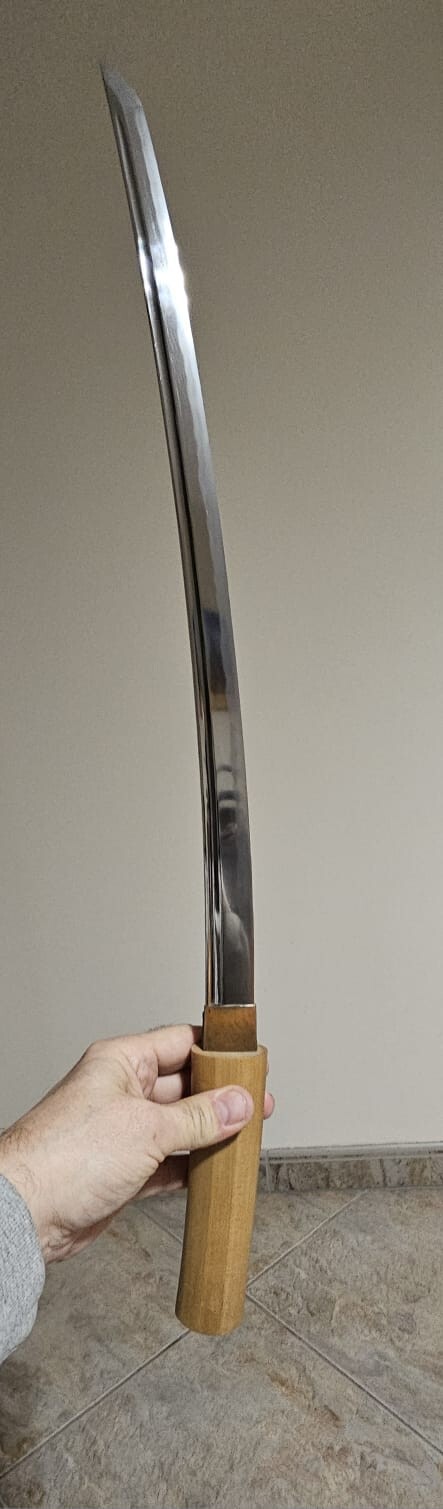

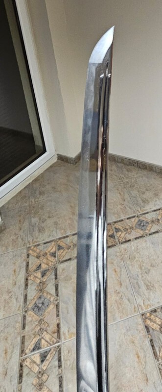

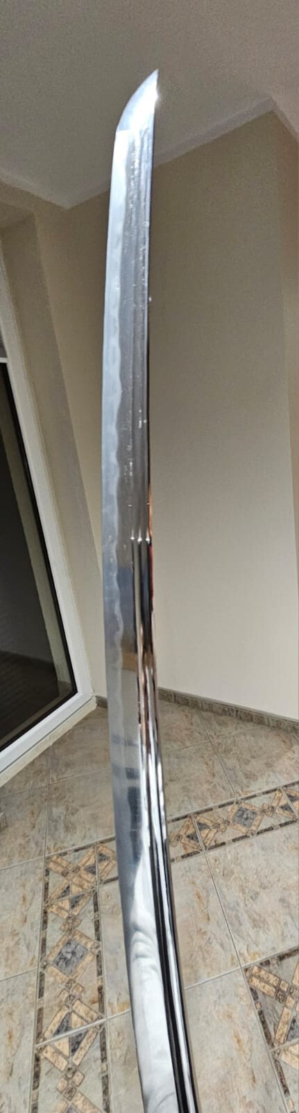

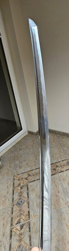

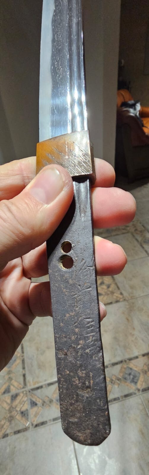

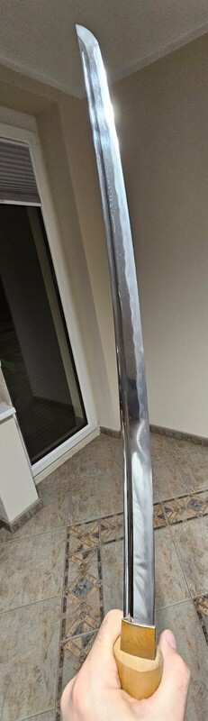

2devnul Posted June 4, 2024 Report Posted June 4, 2024 Hello, Please help on identifying this Bizen Osafune? Could it be Kiyomitus? Any ideas which one? Currently sword is getting its Koshirae renovation so I don't have access to it. But please let me know if specific pictures could help, I will do my best to deliver. What is the meaning/purpose of 4 dots on Nakago? Nagasa: 49.7 cm. Sori: 1.5 cm. Moto-haba: 2.7 cm. Saki-haba: 1.7 cm. Moto-gasane: 0.7 cm. Saki-gasane: 0.5 cm. Quote
lonely panet Posted June 4, 2024 Report Posted June 4, 2024 The mei is very far off any sort of quality you see in bizen stuff. They are well known for long, neat, attractive well cut mei. Its ubu so the mei should be intact So the potential for a later gimei is likely. Crabclaw is commonly associated with sukesada group 1 Quote
2devnul Posted June 4, 2024 Author Report Posted June 4, 2024 On 6/4/2024 at 8:06 AM, lonely panet said: Crabclaw is commonly associated with sukesada group Expand Hi, thanks for quick feedback. Not sure I understand this sentence. Are you referring (Crab-Claw?) to 4 dots I asked about? On 6/4/2024 at 8:06 AM, lonely panet said: So the potential for a later gimei is likely. Expand Quote
lonely panet Posted June 4, 2024 Report Posted June 4, 2024 Crabclaw is the style of hamon. Could be gunome in there too. Its got a bizen style nakago and sakizori. A very nicely shaped katateuchi.. . I would say its definitely osafune bizen school. Dates approx 1500s. Iv attended a oshigata of something i to compare 1 Quote
Mark S. Posted June 4, 2024 Report Posted June 4, 2024 It would have to be signed: “Bizen ju Kiyomitsu” Without digging through my books and looking through all Kiyomitsu, I am not sure if any Kiyomitsu signed this way. Usually there is a Kuni or Koku and Osafune included in one form or another, but I don’t remember ever seeing just “Bizen ju”. If I squint and stare real hard, I ‘think’ I can see the following strokes (in red) of “mitsu”. Unless I could find a mei example that was just “Bizen ju Kiyomitsu” I would assume gimei. 1 Quote
2devnul Posted June 5, 2024 Author Report Posted June 5, 2024 Hello, Thank you gentlemen for your comments. To bad if it is Gimei, still, I think it is very nice ~1550 Koto Bizen Osafune. I will share photos after Koshirae renovation soon. Still an open question, what are the 4 dots on Nakago? Does it mean anything? Quote

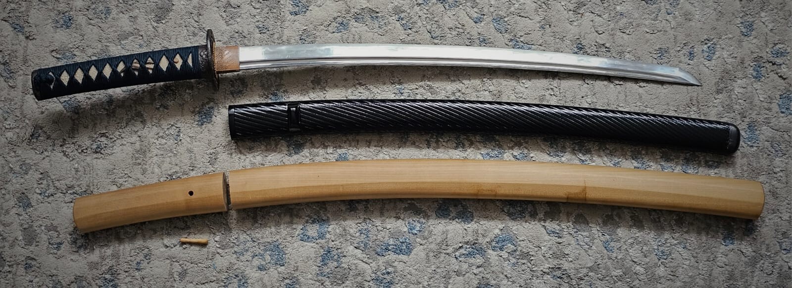

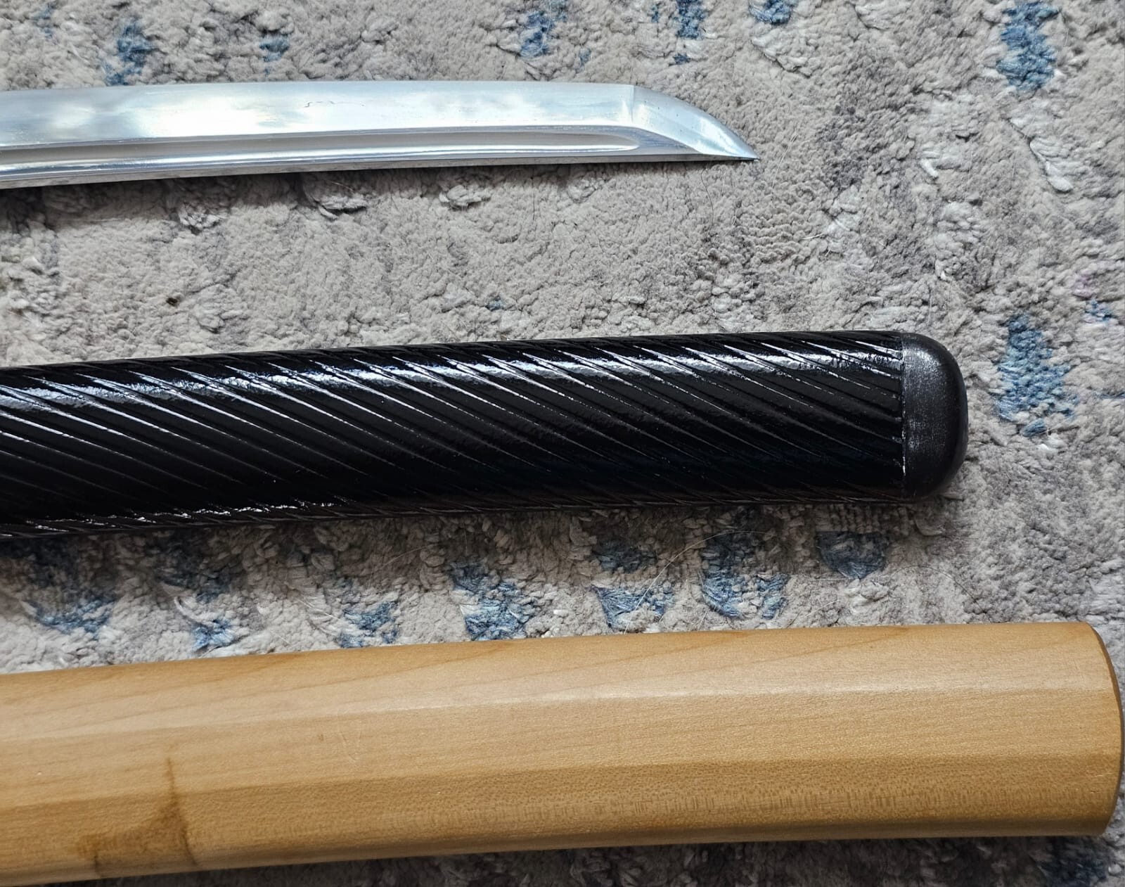

2devnul Posted June 9, 2024 Author Report Posted June 9, 2024 Koshirae renovation completed. Fuchi/Menuki/Kashira/Tsuba stayed original (late Edo), Samegawa/Magnolia wood/Silk Tsuka-ito/buffalo horn imported from Japan and replaced. What do you think? 6 Quote
Alex A Posted June 9, 2024 Report Posted June 9, 2024 Someone thought the blade worthy enough to add bo-hi. 1 1 Quote

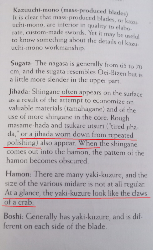

Alex A Posted June 10, 2024 Report Posted June 10, 2024 Connoisseurs describes Kazuuchi-mono as having a surface where shingane appear due to economizing on materials. That does not sound like the type of sword you want to cut a Bo-hi on. Also describes them with "rough masame" hada. There were real junk blades, the kind that went of to China. Lets not forget that they were ALL handmade, from junk to average to decent to good. Its not like they were all stamped out on machinery . Someone had to pay, request to have that bo-hi cut. Your never going to know the story behind it. I cant see a certain general or whoever demanding that all the mass produced waks for his army of Ashigaru have a customized B0-hi Have a Sue Seki tanto here with Bo-hi, cant see it saving much weight. Perhaps with the spoils of war someone decided to upgrade it, A newly promoted Ashigaru to the position of Samurai, who knows. The Nakago on the blade above looks to have seen a bit of an hard life, so in that respect i find it a bit difficult to judge. Seen Nakago just like that on blades dated to Eisho. If you read Aois write-ups they often describe Eisho as non mass produced , made during peaceful times. Some just look a bit rough with use. Not bothered looking into the mei, who knows, it may have been unsigned originally. If so, there's a thousand reasons a blade could be unsigned, even blades that were not mass produced. This is the thing about stuff that was made over 400 years ago, its not all black and white but plenty of grey. Decent sword. like the koshirae. 1 1 Quote
Jacques Posted June 10, 2024 Report Posted June 10, 2024 Brian How many swords have you held ? What's the difference between a simple practical sword and a chumon uchi one ? Quote
Jacques Posted June 10, 2024 Report Posted June 10, 2024 Quote Connoisseurs describes Kazuuchi-mono as having a surface where shingane appear due to economizing on materials. Expand I would add that shingane and kawagane are both tamahagane. Quote

2devnul Posted November 25, 2024 Author Report Posted November 25, 2024 Hi, Digging out this topic as my research in order to find the meaning of dots on Nakago resulted in failure. I have several theories on what this could be, but still, these are just lose thoughts. Maybe someone on forum has any idea? What are the 4 dots on Nakago? Does it mean anything? Quote
