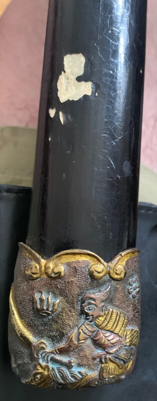

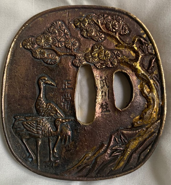

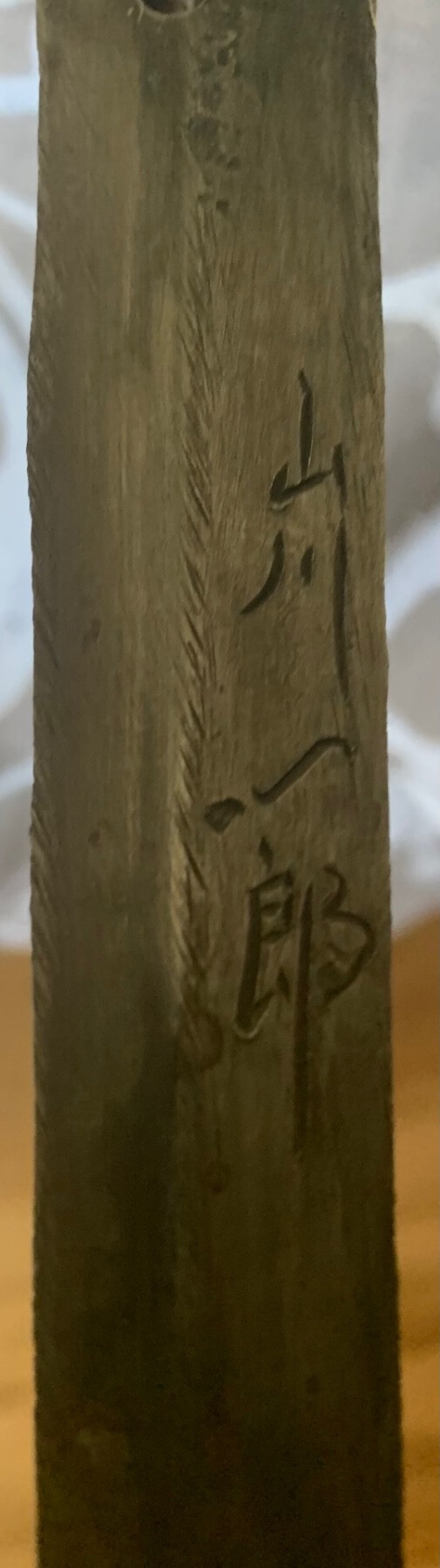

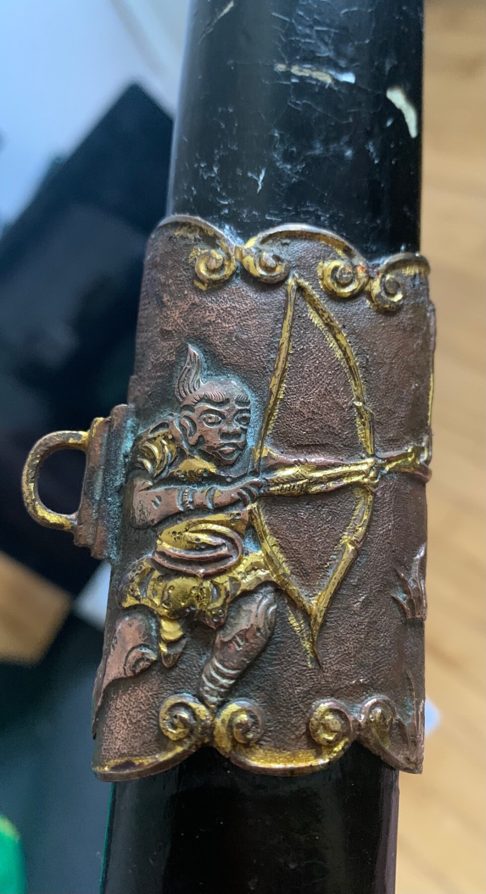

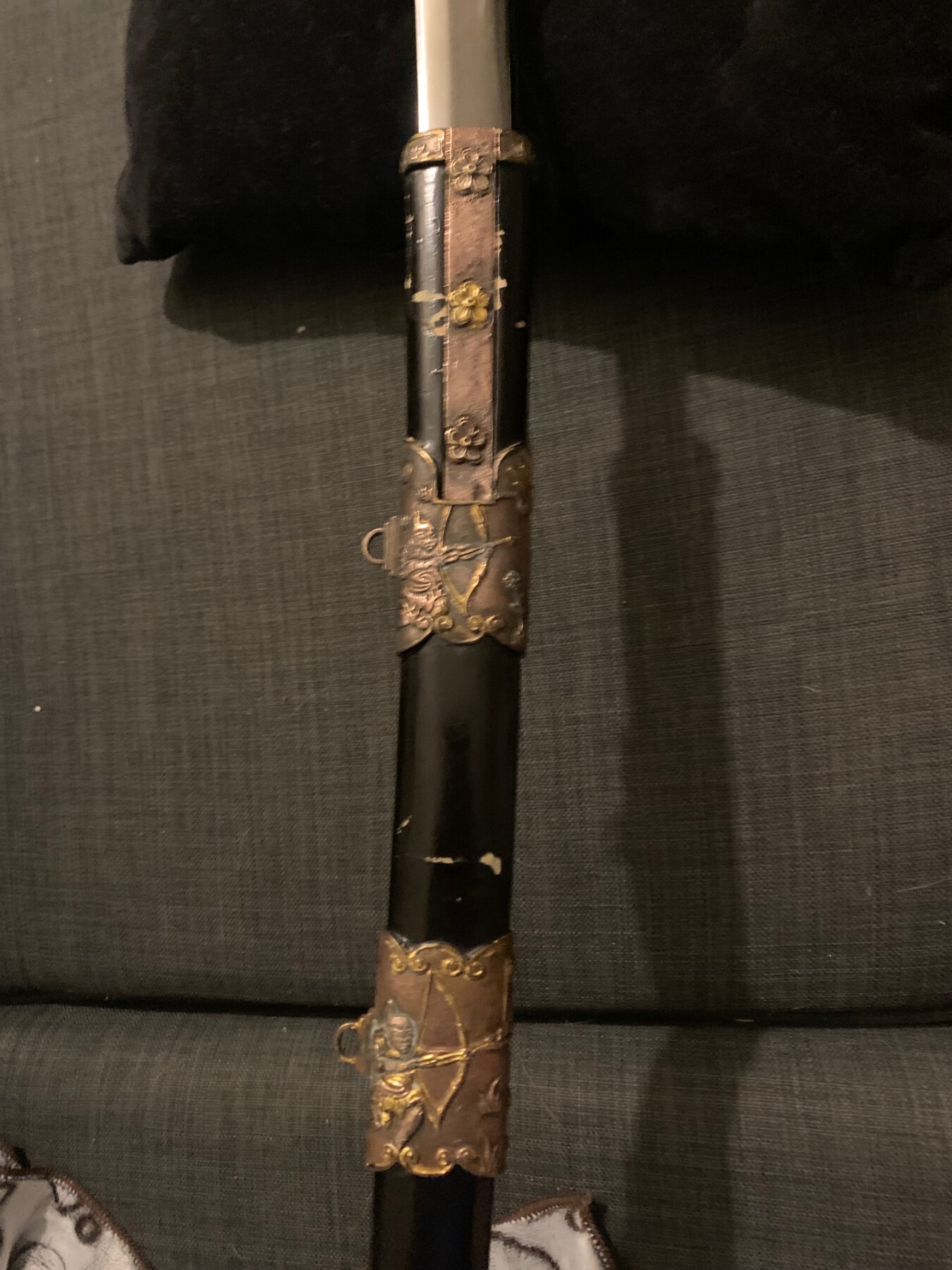

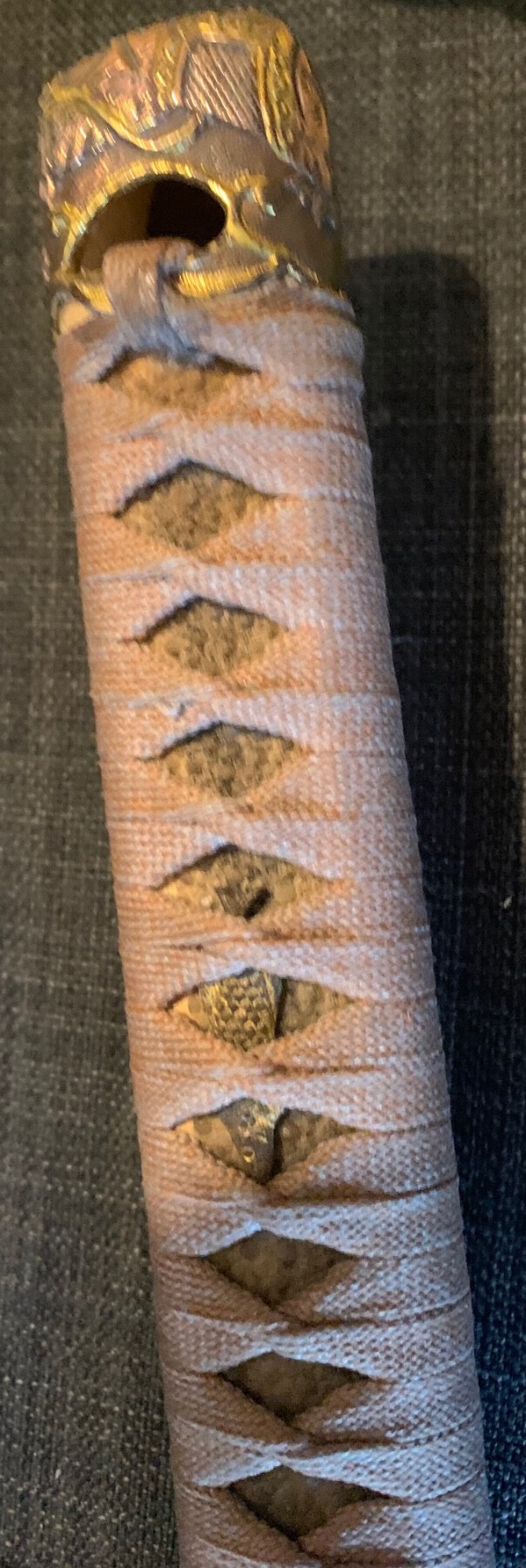

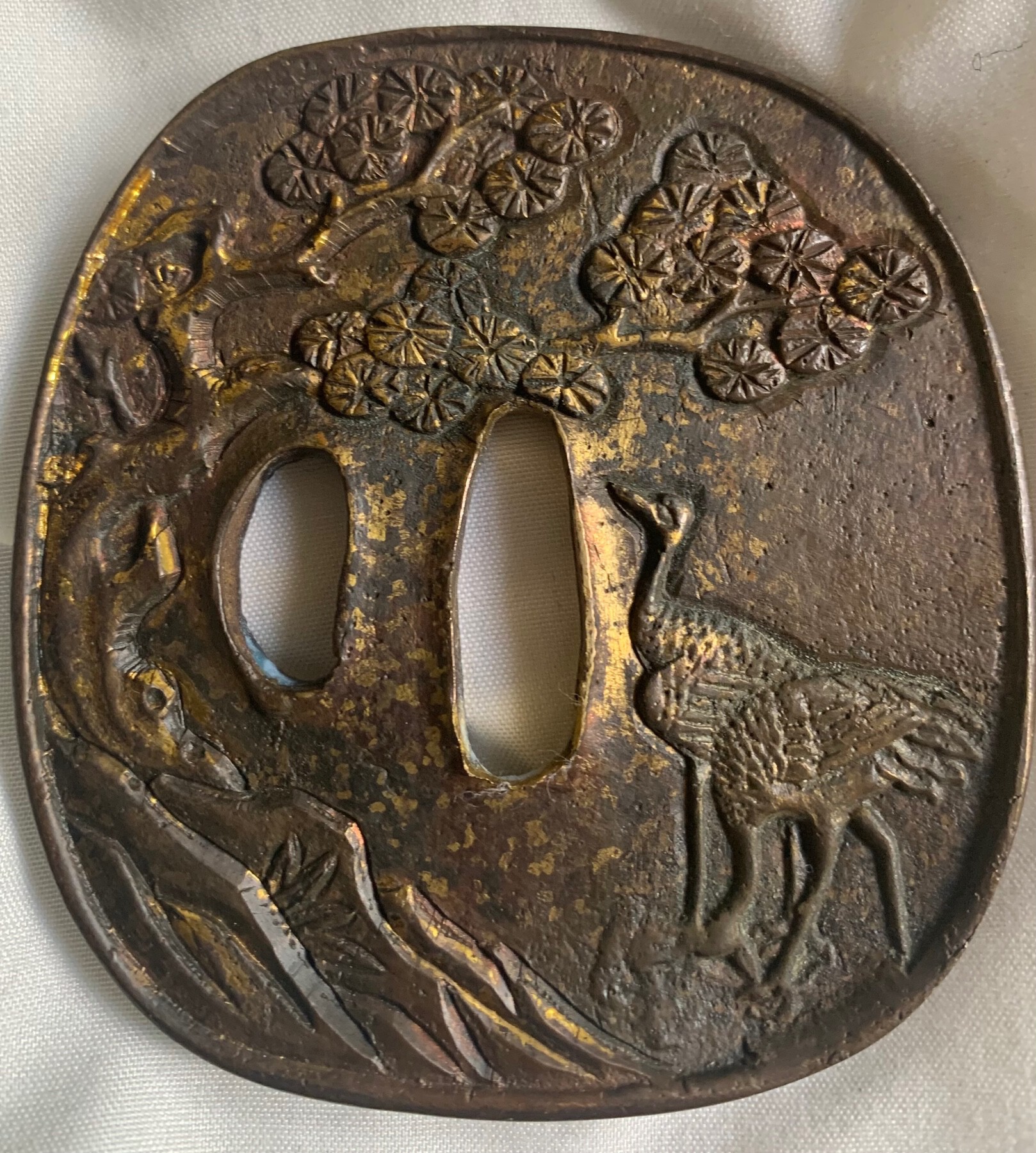

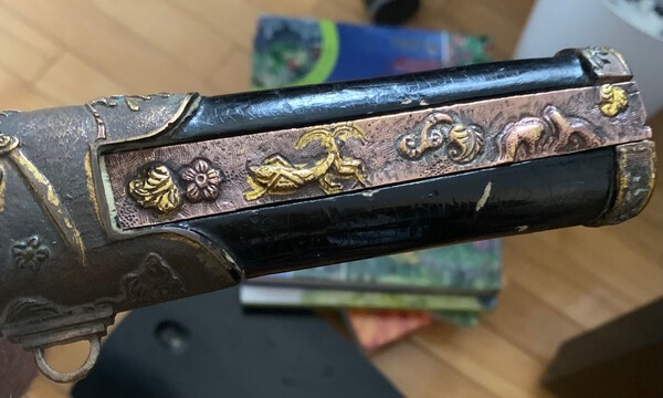

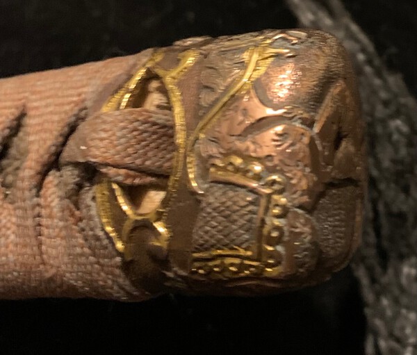

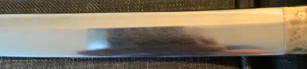

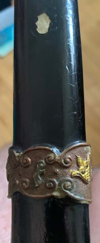

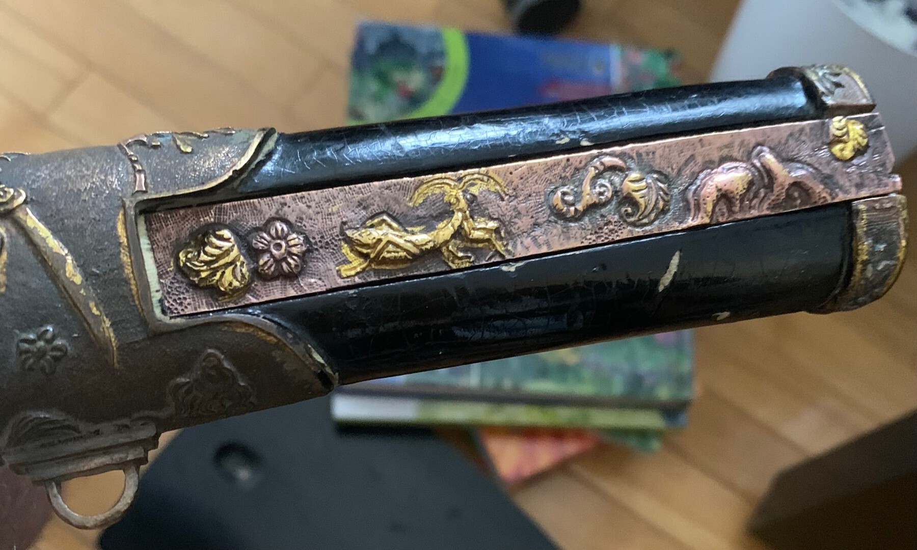

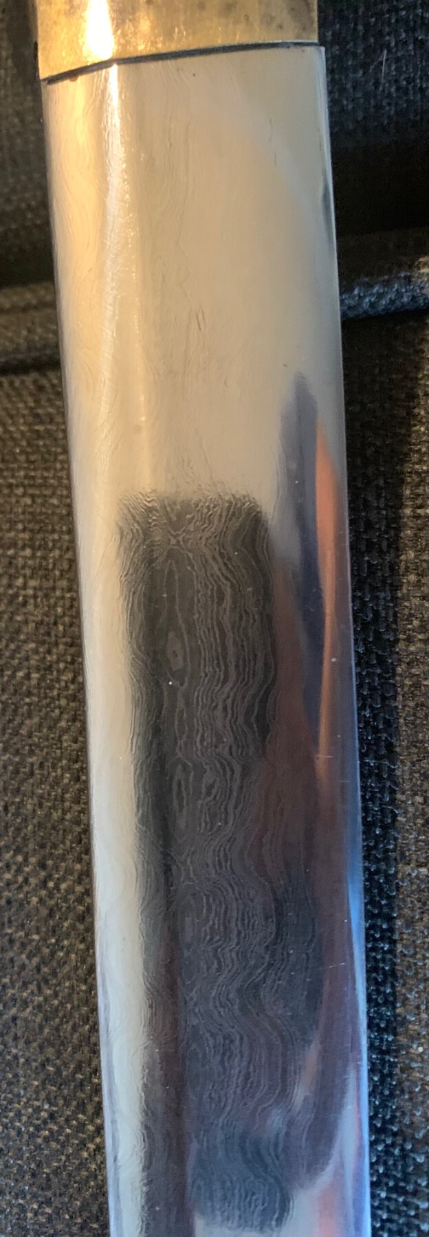

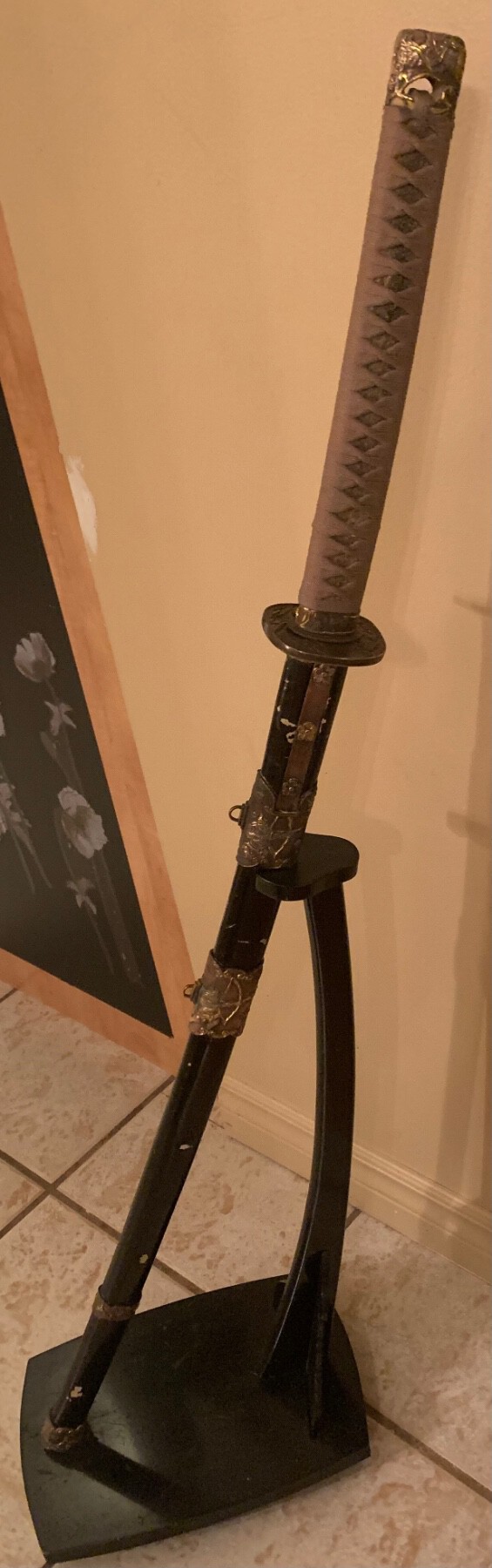

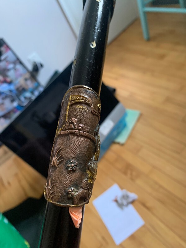

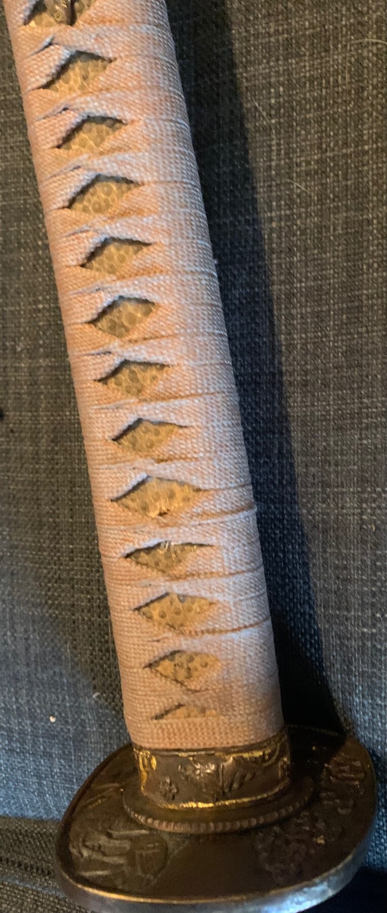

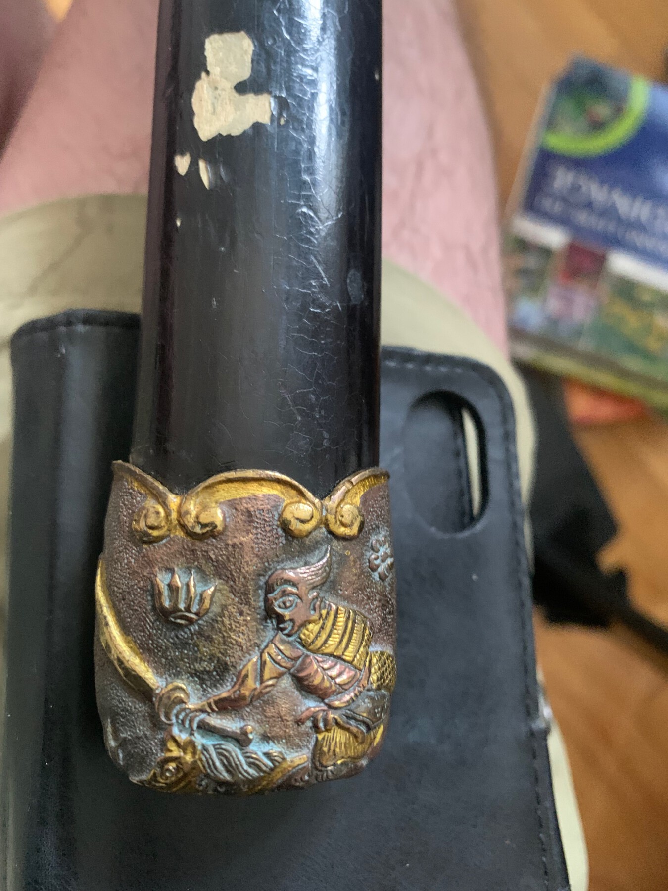

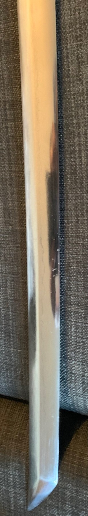

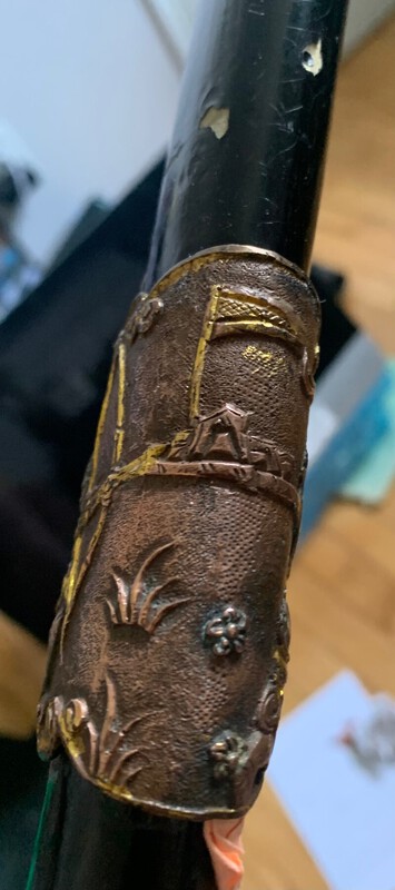

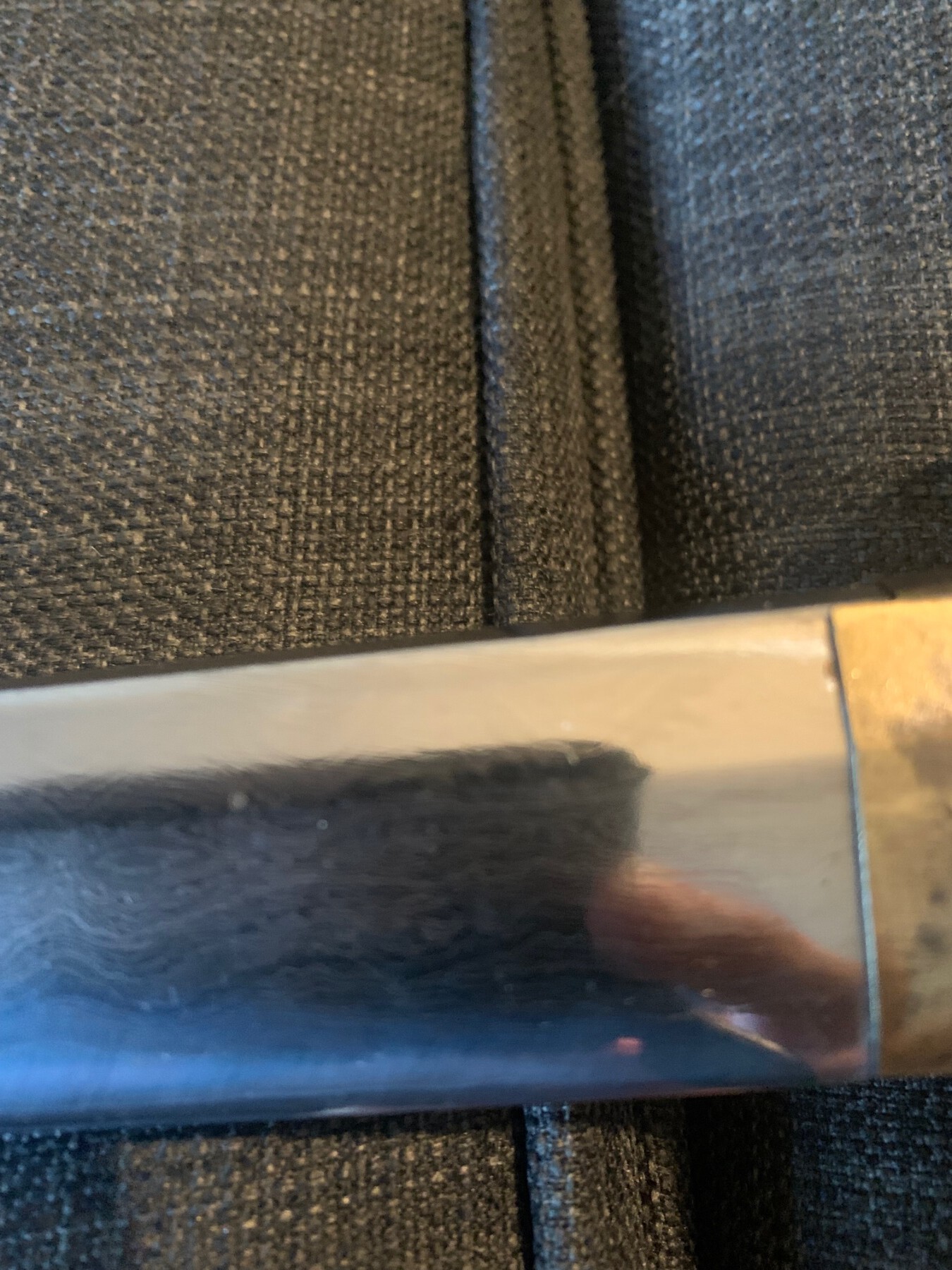

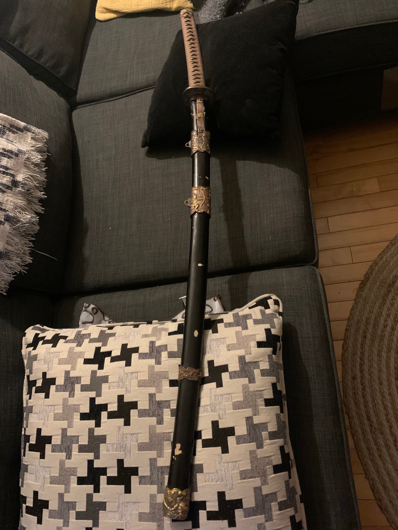

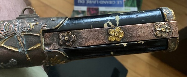

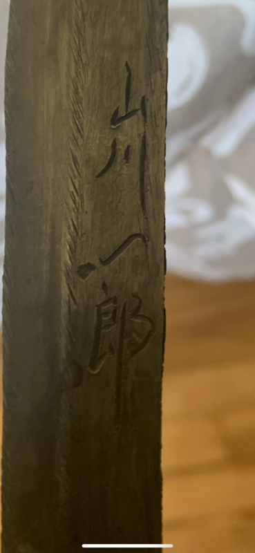

          I am new to this site which I discovered by chance because I bought a Japanese sword in a clearance sale and I know very little in this area but I have always wanted to own one of these swords that I found fascinating in terms of history and its great samurai who possessed these swords with honor and dignity. I am sending you some photos a strange thing there are several incrustations of gold powder on several of the scabbard and on the tsunami and note that the self is signed and the tsunami too and I have the impression that on the scabbard a story is written there. Thank you for your help if you have any information.

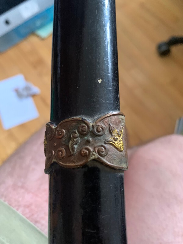

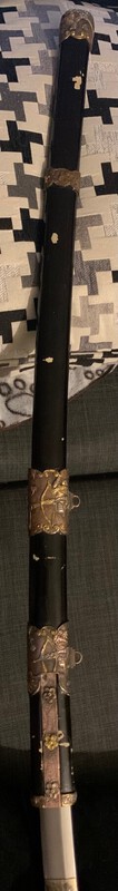

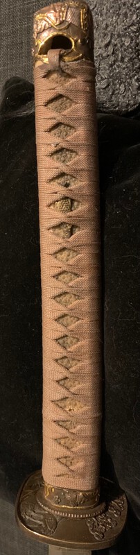

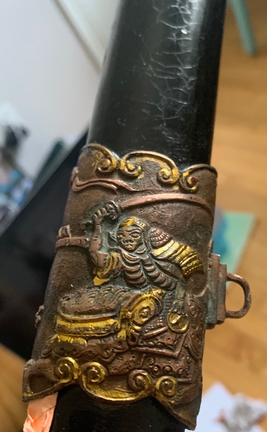

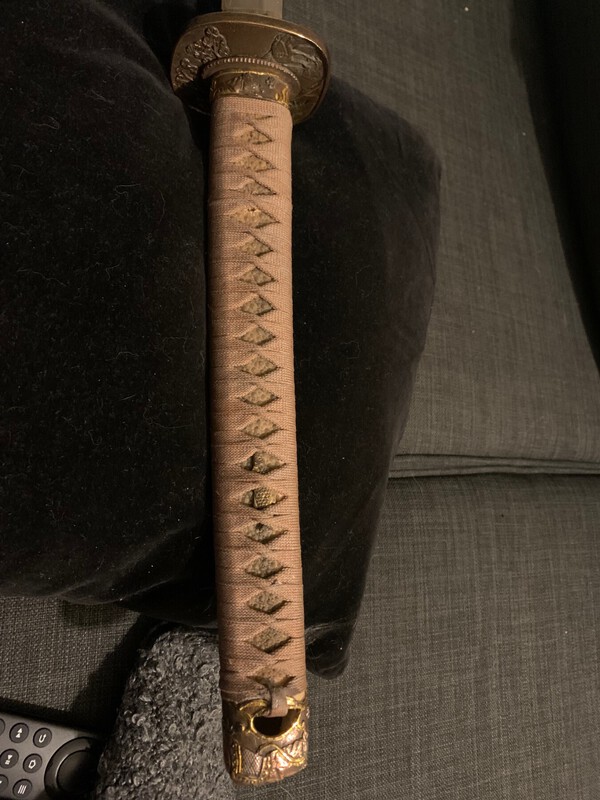

Your sword appears to be in tachi mountings worn with the cutting edge facing down. I don’t know much about mountings but they look older and I’m sure some people here can tell you more about them.
As for the blade, a few things look off to me. The lines are all rounded over and not as crisp as they should be. The ridge (shinogi), tip (yokote) and some other parts of the geometry look rounded and incorrect. Almost like someone rounded and softened all of the edges that should be very crisp and clean on a traditionally made Japanese sword.

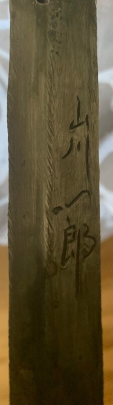

The other things that concern me are the condition of the tang (nakago) which has very rough file marks inconsistent with the work of traditional Japanese swords and the grain of the blade steel (hada) which looks more like a modern Damascus type pattern than a traditional grain pattern seen in Japanese swords. I’ll defer to other peoples opinions on this for confirmation but maybe it’s the poor polish, but it looks unlike the blades in and out of polish that I’ve personally seen.
More pictures of the entire blade bare blade to show the geometry and a picture of just the tang zoomed out a bit more to show the entire signature, mounting holes, and butt of the sword are welcome in making a better declaration but this blade looks off to me with the pictures provided. I’m still new so I’m open to being corrected if I’m wrong.
Agreed. A poorly rendered fake.
Hopefully not too much was spent on it. This site has a lot of available resources for you to study. And when you're ready, reputable sellers who can hook you up with a genuine article.
