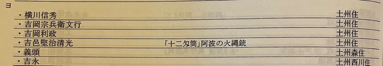

土州住吉岡利政, with an old Kanji character 邱 丘 (?)for Oka (hill).
"Do-shu ju Yoshioka Toshimasa", a listed smith. (Yoshioka Toshimasa, living in the old Han region of Tosa)
The cutout for the pan looks too small to have been originally for a matchlock, so rather than a conversion, this may be a later-generation original percussion gun from the late Bakumatsu.

Compared to the huge knowledge base of Japanese swords, little is known about gunsmiths, and smith name lists are very rare.
As to 'conversions', Roman, most appraisers and dealers are not aware of the very slight difference.
There were two types of these, and at the new Nagoya 'Touken World' you can see a rack of each. The first are originally matchlocks, and there is a long shallow cutout in the right rim of the stock for the pan and lid. Conversions usually have the remnants of this long cutout, which is no longer necessary. Has yours had a later plug of wood fitted in there?
Then there is the type that is to all intents using a tradionally-made matchlock stock and barrel, by the same smiths, except made solely for a percussion lock system. The cutout there is only large enough to take the nipple surround.
Your pictures are rather dark, but from what I can see the latter looks the more likely candidate. It's a small difference, I agree.
In my experience there are matchlock purists, who attempt to reduce a percussion gun's working parts back into a matchlock, so to such people this difference would be meaningful. History buffs might also enjoy seeing the evidence of overlap, two phases of Japanese gun history. In general though, it's horses for courses.
