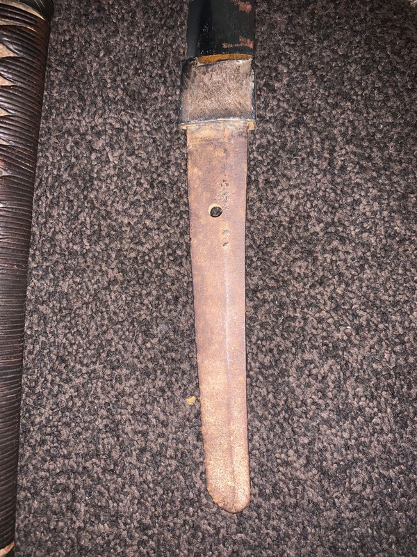

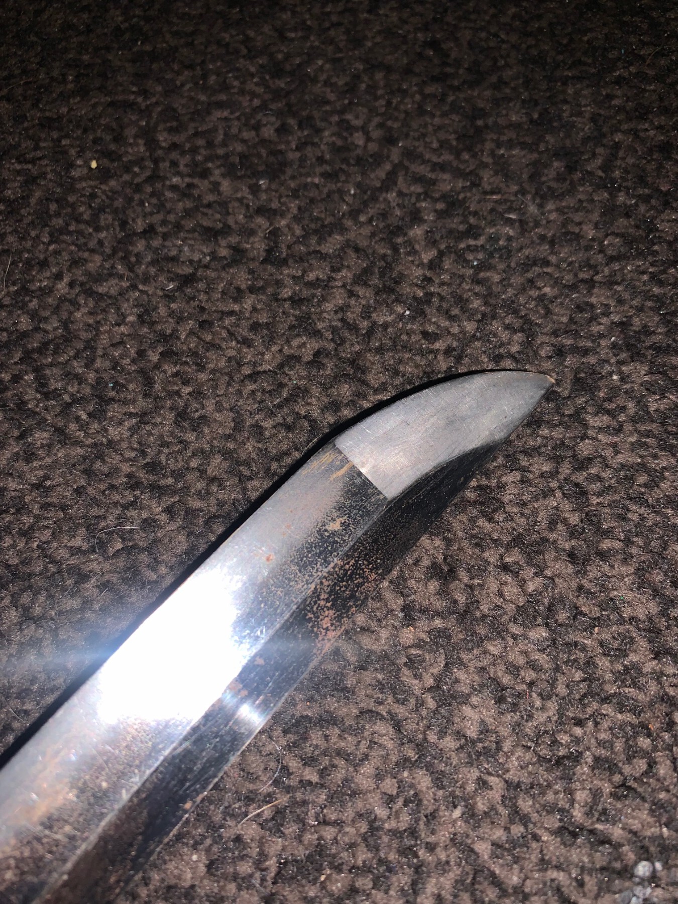

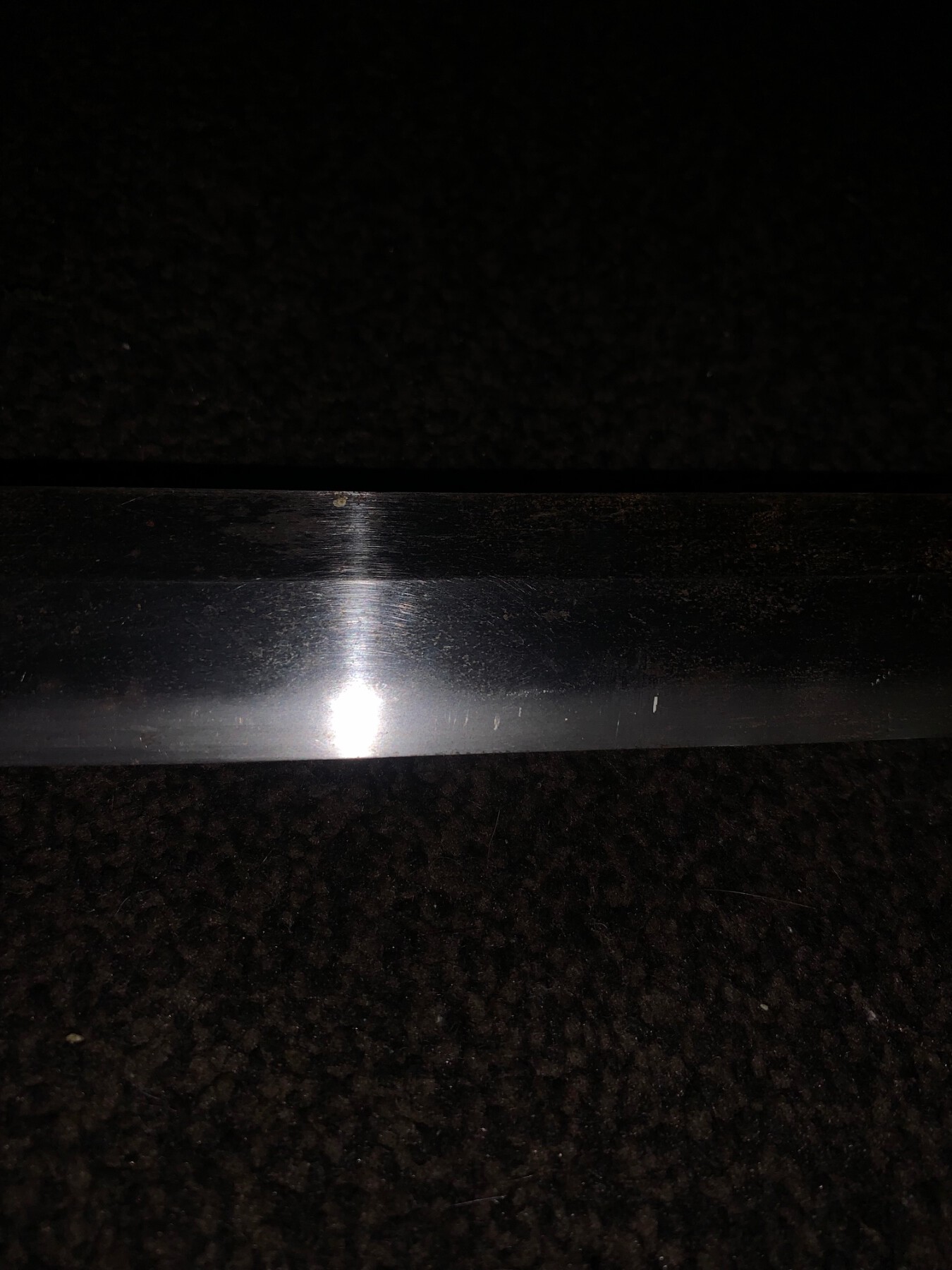

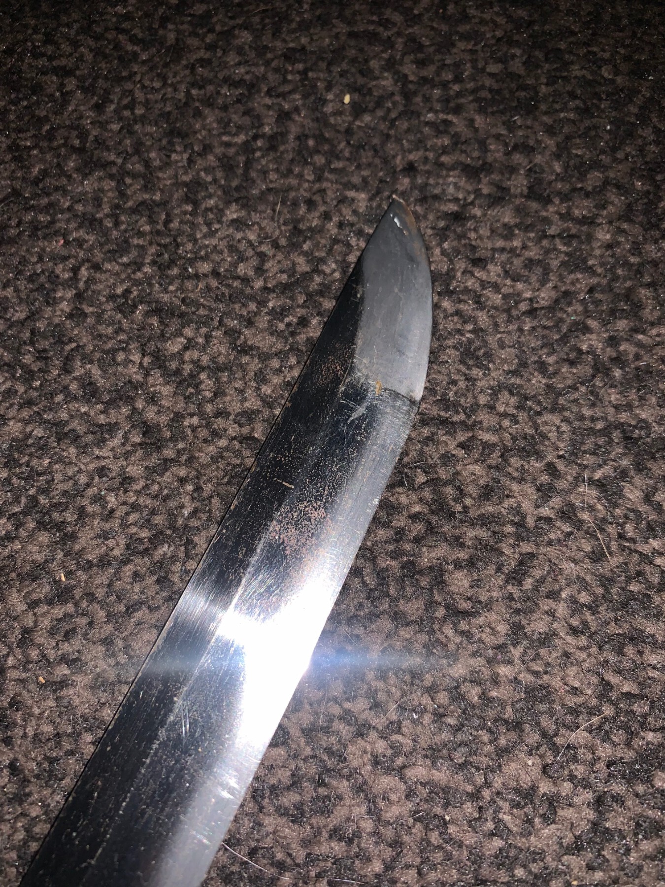

Hello. I am new to this site but I am seeking some info on a recent purchase of a katana I believe is a nihonto. The nakago is not signed which I know doesn’t help at all. But I know not all nihonto were signed. I have good feelings about it. I’ll attach some photos and possibly a video. If anyone can help me determine its age/worth and origin that would be fantastic. Thank you.
Real Nihonto, but it has active red rust. You need to make sure you apply a good oil to help stop further damage. Do not do anything else to try and clean the blade. This is a project for professionals only.
I use 100% Tsubaki oil for my swords. This is easily found on Amazon. Note that some Tsubaki oil offers come with something called a “Rust Eraser.” Under no circumstances should you use this on a Japanese sword!

Definitely a real Nihonto, possibly Edo period sometime, and anything else would be just a wild guess.
Grey
Thank you very much! I asked a few buddies of mine and they were saying the same thing. This was an offerup purchase for $80!! I guess the guy didn’t know what he had.

It appears that the nakago on this sword may have been cleaned at some point adding to the challenge of correctly dating this sword.
Regards
