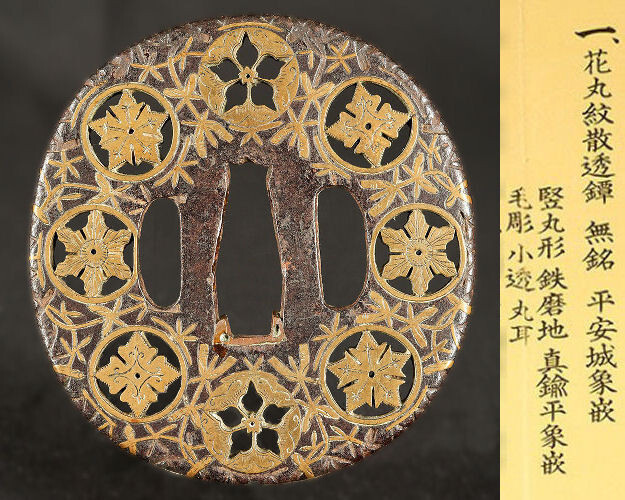

Justin Posted May 30, 2024 Report Posted May 30, 2024 Hi everyone, Hope you’re having a great day. i submitted the below tsuba to shinsa recently and it received Tokubetsu Hozon with a ‘Heianjo Zogan’ attribution. I thought it might come back as Yoshiro (or more optimistically Yoshiro Naomasa). https://tosogucollec...heianjo-zogan-tsuba/ I know Yoshiro is a branch of Heianjo, however would there be a reason the NBTHK stopped at just Heianjo? Thanks in advance for any feedback. Justin 5 1 Quote

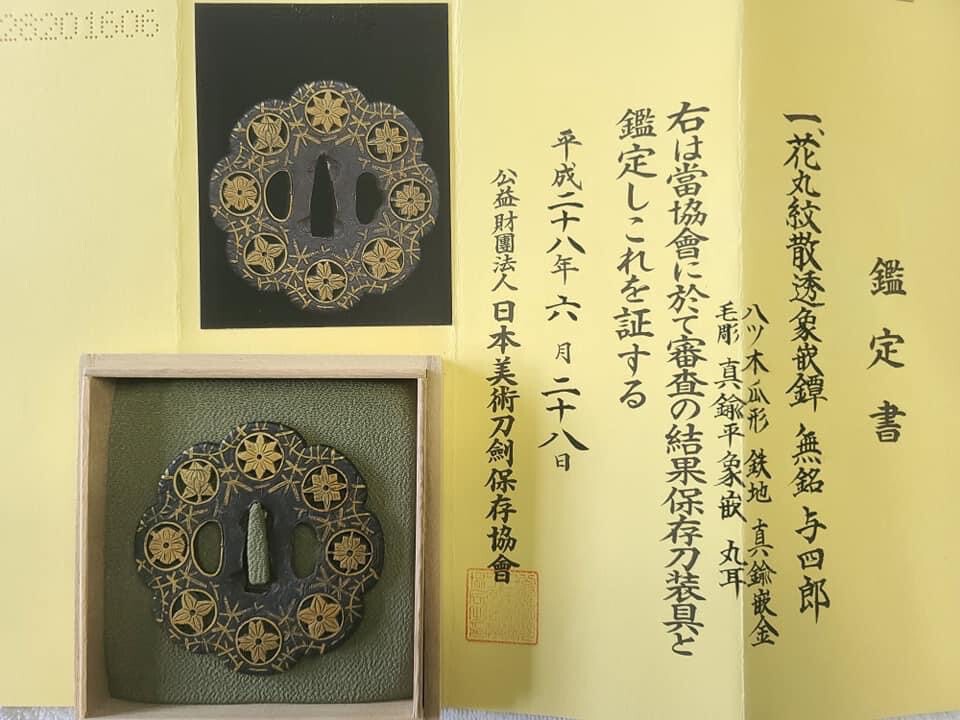

Justin Posted May 30, 2024 Author Report Posted May 30, 2024 Thanks Luca. I noticed this tsuba for sale with a paper from 2016. This says Yoshiro. i see my tsuba as more ‘Yoshiro’ compared to this one. Perhaps NBTHK has had a change of policy and only assign Heianjo Zogan now? 5 Quote

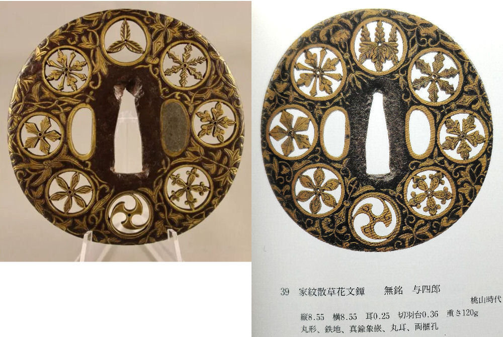

MauroP Posted June 1, 2024 Report Posted June 1, 2024 All right folks, first of all I want to assure that no intended disrespect to NBTHK shinsa activity from me. Simply I feel sometime confortable in expressing a different opinion. Here below another tsuba attributed to Heianjō-zōgan, showing a quite typical decoration with ranma-sukashi usually associated with Yoshirō-zōgan tsuba. I fully agree with Luca when he says that the tsuba we are dealing about is a "manual piece". Indeed here below the tsuba submitted by Justin paired with a very close example described as Yoshirō, taken from "Tanoshi Shinchū Zōgan Tsuba: 100 Tsuba" by Ōtani Sadao. 3 Quote
