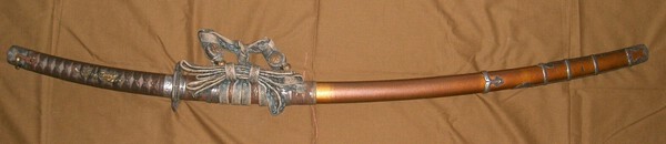

Handachi koshirae is essentially half tachi, all the mounts of the tsuka and say look like tachi mounts but the koshirae will have a kurikata and no hangers.  It may also have provision for kodzuka and kogai which is not usual for a tachi. (See below).
WWII gunto mounts are reminiscent of tachi mounts but quite distinctive, (see below). it would be possible to find a handachi mounted sword converted for use in WWII.
Derek, tachi mounts are essentially for use with armour, there are types for specific activities and ceremonial events including court activities.  A rough distinction would be between early tachi koshirae which are for use in combat, sophisticated and high quality tachi koshirae produced during the Edo period and a relatively commonly encountered type with brass mounts,often engraved with floral designs and silver plated, that are usually assumed to have been manufactured in the late 19th century or early 20th century. (See below)  For a high end example see here, https://nihonto.com/6-03-18/
