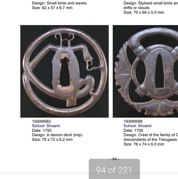

Steves87 Posted May 12, 2024 Report Posted May 12, 2024 The Birmingham has one in their collection, this is a partial shot from Grev's book 2 2 Quote

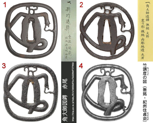

MauroP Posted May 13, 2024 Report Posted May 13, 2024 No. 1 – My recently acquired tsuba with an old tokubetsu kichō paper; attribution to Echizen school and described as folded bamboo (oritake sukashi tsuba - 折竹透鐔). No. 2 – Described as Tsuno Daishi sukashi tsuba (角大師透鐔), attribution to Ōno school. No. 3 – Tsuno Daishi no zu tsuba, attributed to Akao school from a well known Japanese blog (https://blog.goo.ne....c75e22236e977277602d). No. 4 – Subject described as bamboo object (take chōdo - 竹調度) and very precisely attributed (albeit mumei) to Kishū jū Sadanaga in “Tsuba: Ishō to Waza no Bi” by Hayashi Eiroku, p. 88. Already mentioned here above is another similar tsuba reported in “The Birmingham Museum & Art Gallery Tsuba collection” by Grev Cooke, p. 94, attribution to Shōami school. So what’s really depicted in these tsuba? Maybe a bamboo talisman representing Tsuno Daishi? Still looking for answers on the subject (no hope to know which school produced the tsuba...) 4 1 1 Quote
