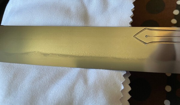

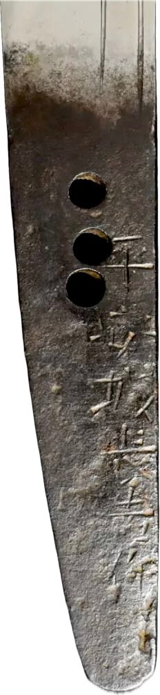

Hello gentlemen. I recently acquired a tanto signed "Heianjyo Nagayoshi" obviously gimei, but the quality looked interesting. And a little bonus: a Torokusho Showa 26 certificate.
The price wasn't too high, so I decided to take it as a study blade.
Once in my hand, I have a feeling of Oei, or perhaps fine nanbokucho.
I'm not in favour of signature overpressure but this time I think it could be beneficial for the blade (only fools don't change their mind).
I'd like your thoughts on this piece?

Thanks Brian. Yes a tanto with a nakago with a nice black patina, a Showa 26, and a good polish. Despite the fake signature, the quality takes over. The question, is it so easy to remove the signature and what would be the result of a shinsa according to you?
You made a nice find. I feel the research on the signature, and the whole item, is also warranted as there are several generations of Heianjō Nagayoshi. Here is quote from Seskos swordsmiths (I am not sure about the original source of this following information) for 4th gen Bunmei era Nagayoshi
Quote
tantō have a rather narrow mihaba and no or very little sori, the jigane is a dense and beautifully forged itame which can also stand out, the hamon is a suguha mixed with ko-gunome in nioi-deki, but also a gunome-midare in ko-nie-deki is seen
I know it is said in most (pretty much all) sources that there are no extant blades by 1st generation. However there is a 1339 dated katana in the collection of Kunōzan Tōshōgu Museum.
For me it is way too difficult to differentiate various Muromachi period Heianjō Nagayoshi. However there is some variation in signatures that are authenticated.
To my eyes, that Mei looks to have been on that nakago for a very very long time. Personally I wouldn’t dream of removing it . Jussi’s advise above is spot on (as usual!)
I do see a lot of resemblance of Kinju in that hada. That’s just a total rookie statement
I love the quality and I wouldn’t remove the signature unless shinsa is mandatory for you

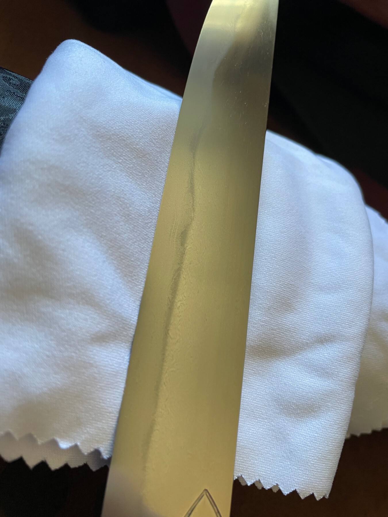

Yes, indeed, Jussi. That's what I saw, and I have to admit that a lot of the characteristics match, the Jigane is really magnificent.
As for the signature, even if it looks old compared to the patina of the whole, it seems clumsy to me. The problem is that there aren't many examples of signatures from any generation on the net. Does anyone have a book with more examples?
Another interesting Kantei point that I hadn't noticed at first (shame on me) is that the Sengo school is known to have an identical or almost identical Hamon on omote and ura.
After checking, can we talk about quasi-symmetry in this case?
