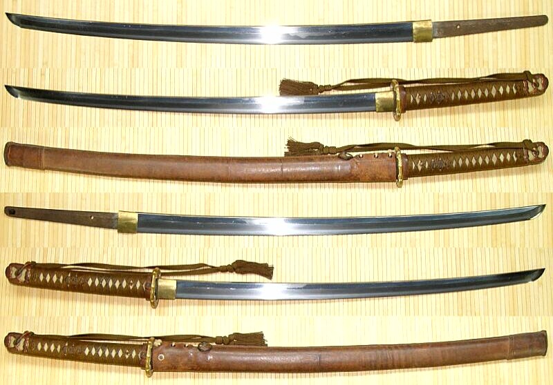

Hello!I just bought a showato in guntokoshirae and now I have a few questions.The seller told me it's rated two million Yen according to TokoTaikan but what does it mean bad,average or good?Question no two.When he(the seller)imported it from Japan for me It had the Torokusho attached to the saya when it arrived.I thought only real nihonto could recieve one.Altough he said mine were handmade but it's still a shomato with a sekistamp.Can someone explain?Now the final question at least for this time I would be very grateful if you guys could help me translate the mei I know that some kanjis mean Yasutsuna,I presume it is the ww2 seki smith Ittosai Yasutsuna but I need help with the rest.I'm a complete stoneageman with computers so I haven't learned how to attach pictures yet, yes there still some of us left on the planet:) But there are great pictures of my sword at http://www.nihonto.nu under sale 1200 Euros page three listed as Gunto Yasutsuna.Sorry for the extra work.Hope my english is understandable It has passed a "few" years since school,seventeen more precisely.Best regards Daniel

It's a Showato, not a Nihonto.
How it got a Torokusho :dunno: especially for a Showato.... :?:
And if the Torokusho is original the sword has not left Japan on a legal way.
Handmade yes but not in a traditional way from Tamahagane,
Especially with a Seki stamp on it.
And that Nakago doesn't seem to belong in Toko Taikan.
I may be wrong so correct me if I am!
Best regards, John

Hi Daniel,
Your sword seems to be a Showa gunto made in Seki by Asai Yasutsuna (that is what his mei says)...he is the same man as the Ittosai Yasutsuna you mentioned. He started at Seki on Showa 16th year.8th month.18th day (18th August 1941). He was a WWII Seki Tosho. I looked up Toko Taikan and he is definitely not there. Perhaps you need to ask the seller where he got the 2 million yen reference from? I am not really familiar with gunto prices except on ebay, but since yours is clean, complete and in good order, I suppose you paid the current price. As for the paper that came with it, if you could post a pic of it perhaps we could comment, but I don't know of any shinsa passing a Seki stamped blade as Nihonto...but, you never know.

Hi Thanks for helping me out.Just to clear some things out.I´m aware that my sword is a showato and I have never believed it to be anything else and I am very satisfied with the sword :) .The guy I bought it from was very clear that it was just a showato,so I haven´t been tricked he´s an honest seller.Don´t want people to get wrong ideas.The reason for my questions were just curiousity about my sword.For example if the sword also had a date written exept for the signature Yasutsuna.Concerning the registration card i just felt it to be strange how my sword could have one.Of course the card could possibly be something else.But it seems identical to other cards I have seen on the net.Hope you´ll have some patience with me tough this is my first sword(but not the last,lucky for me my wife doesn´t read this)I paid about 1200 Dollars for I think that´s a reasonable price I wasn´t looking for a bargain.
Hi John and Daniel....the first character on the sword and the torokusho is Asa...his family name is Asai...you must be getting old John, I gave the mei in the post above.
The paper merely gives the mei, the length and the sori...no date or other detail that I can see.

Once again thank you for helping a newbie like me.So it was a torokusho like I thought.Very strange indeed,now we have a Sekistamped Showato with a Torokusho guess we'll have to call in our dear friend Sherlock Holmes
