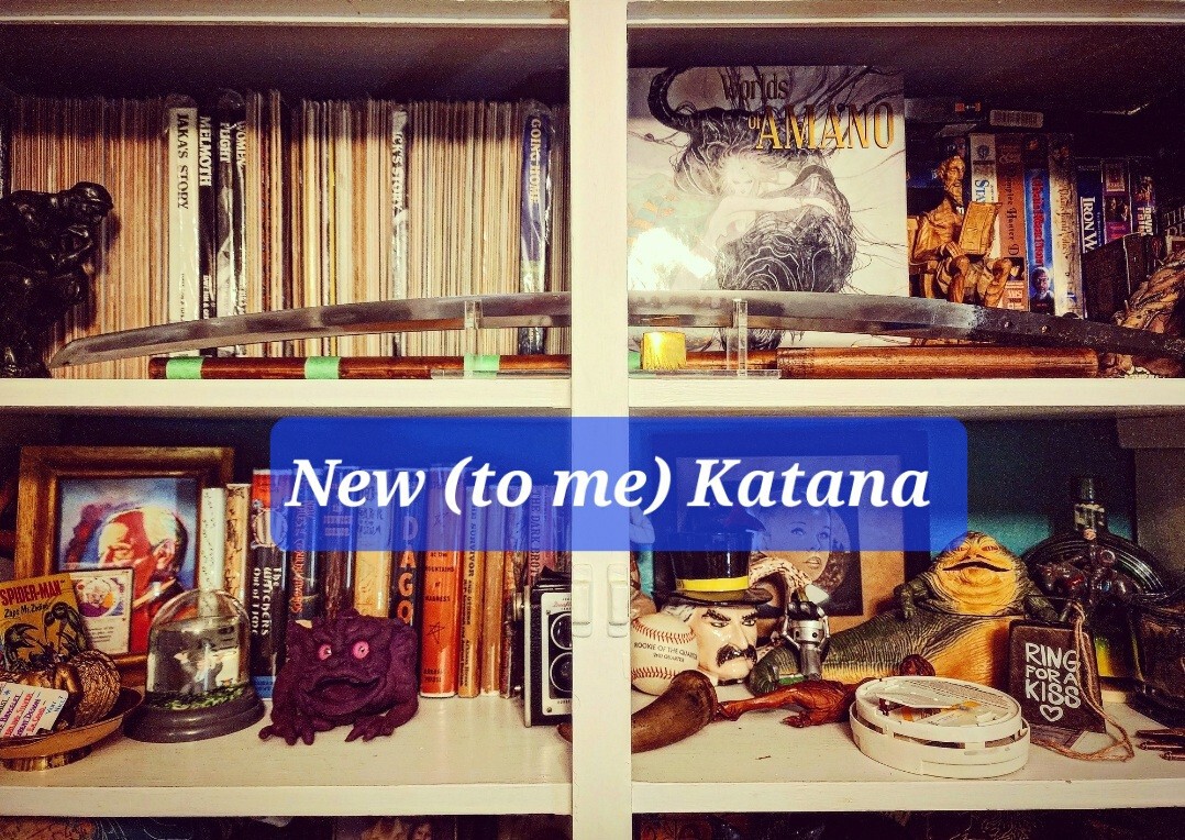

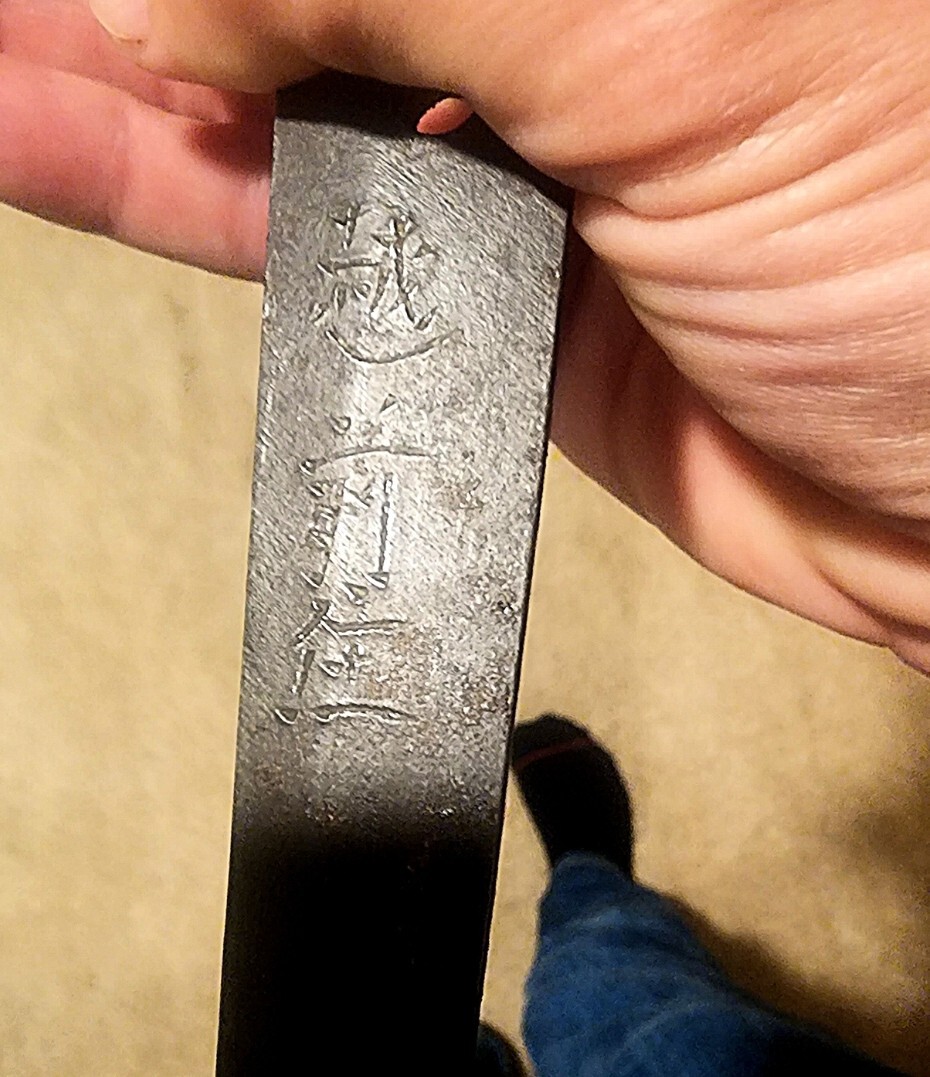

waljamada Posted May 6, 2024 Report Posted May 6, 2024 I'm glad this came up. I used rice glue to put a split shirasaya back together but now it's a bit too tight for the blade. I knew the best fix would be to re-split it and then reglue and not use clamps this time to hold it together while it dries to give that little bit of extra room. I've just been displaying the blade in a glass case out of shirasaya in the meantime. Below is the blade and shirasaya just because. 1 Quote

Grey Doffin Posted May 7, 2024 Report Posted May 7, 2024 Hi Adam, About your idea to not use clamps. I've made and repaired furniture for 50 years and one basic rule is, you don't have to use clamps if you don't use glue. I think you'll regret your plan. For clamps when reglueing shirasaya, I use masking tape over paper bands that tighten as they are slid up the saya, augmented with strips of cotton sheet wrapped tightly over all. The tape paper bands work well to keep the 2 halves aligned and leave no trace when removed. Grey 1 Quote
