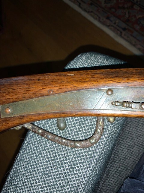

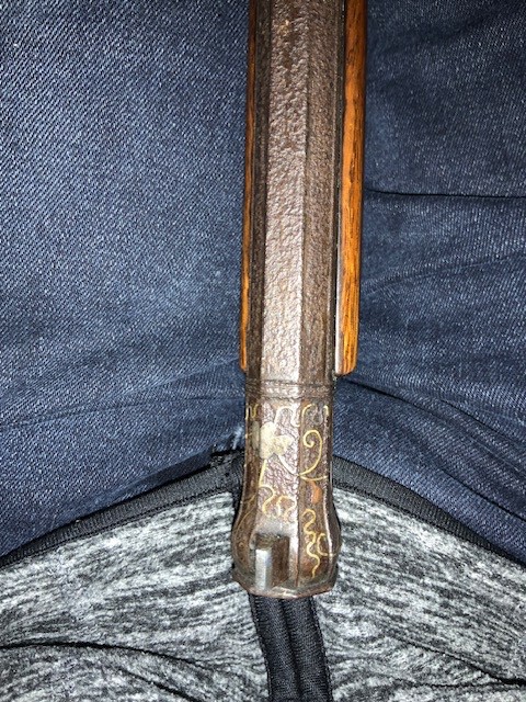

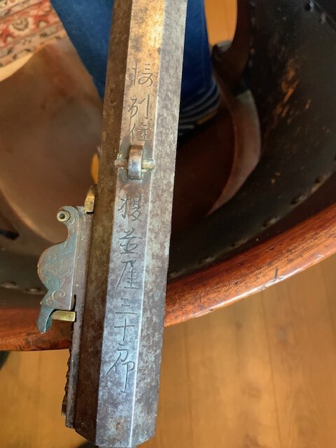

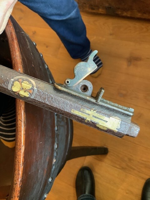

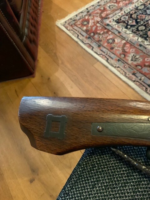

wakiboy Posted May 7, 2024 Author Report Posted May 7, 2024 Back with some more pics. Hope these help ian 1 Quote
tbonesullivan Posted May 7, 2024 Report Posted May 7, 2024 Oh wow! That's definitely a nice one. I also was not aware until this point that Tanegashima muskets had signatures on the bottom of the barrel. Guess I'll have to pull the barrel next time one comes across my desk. 1 Quote
wakiboy Posted May 7, 2024 Author Report Posted May 7, 2024 Hi David I’ve never had one myself and had no interest until a friend got this one and to be honest I’m surprised by how well it’s made and the quality of the barrel, I hope one comes your way soon 🤞 Ian 1 Quote
Bugyotsuji Posted May 7, 2024 Report Posted May 7, 2024 摂州住榎並屋三十郎 Sesshū Jū Enamiya Sanjūrō Funky writing! One of the roughly 200 Edo Period gunsmiths from the famous Osaka House of Enami(ya). This example definitely has extra design features, probably a special order. 3 1 Quote
wakiboy Posted May 8, 2024 Author Report Posted May 8, 2024 Thank you Piers I couldn’t make head nor tail of the Mei, the whole thing is very ornate compared to others I’ve seen. Thanks again 🙏👍 Ian 1 Quote
