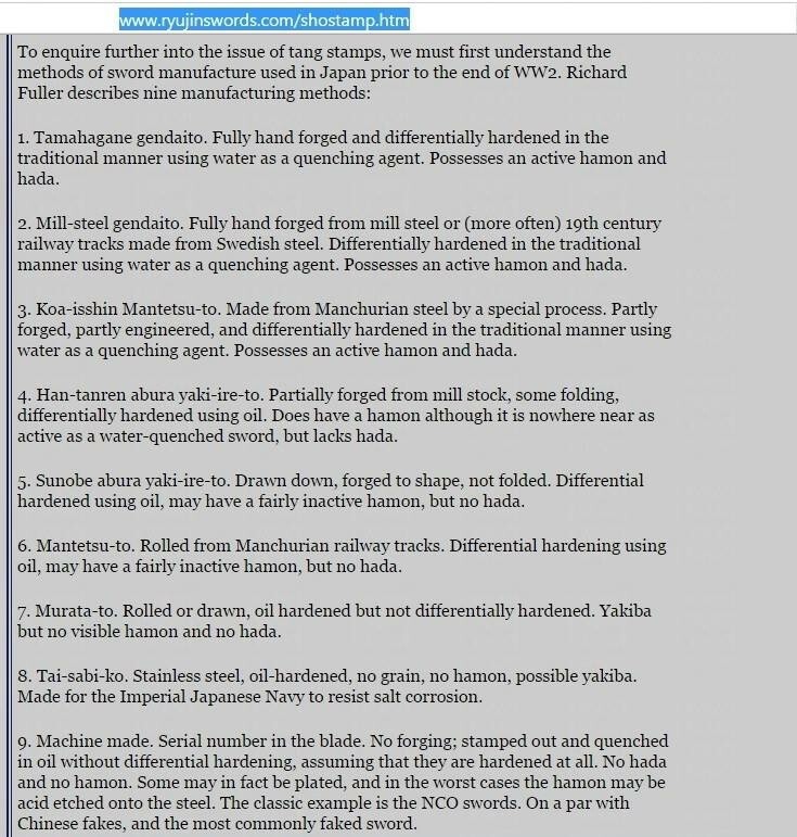

Hello! Some additional information. The  stamp above the mei is the Sho stamp and indicates the blade is most likely an oil quenched showato. It also appears the tang may be bent at the machi?? Could be the camera angle. Fittings seem nice, however.
John C.
42 minutes ago, John C said:
Travis:
John C.

Not to stir the pot, but if he was an experienced collector of 40 years, then he would know for certain that the Showa stamp is an indicator of a non-traditionally made blade and would have priced accordingly. So either he somehow missed the stamp/forgot it was there or he thought he was taking you for a ride. I can't claim to know the man, but an extra 1/2" of blade would not make it particularly noteworthy. It would still fall in the standard nagasa length for an arsenal blade.
The blade itself is almost certainly a high-grade Showato, but with that stamp, it is most definitely not a Gendaito.
Still, a very nice Showato!

There are different levels of "handmade" and for something to be considered Gendaito, it has to meet all of them. Some swords are partly forged and folded, but use oil quenching or forging methods or steel that make them not fully traditional. Still "handmade" but don't meet all the requirements. This would be one of them. There may be rare exceptions of Gendaito with arsenal stamps, but they are so few as to prove the theory.
I am fairly certain this is oil quenched. It doesn't show nie, or hataraki. I do not agree with his assessment of it being fully traditionally made. That said, it is still a good quality piece but has to come at a price point that is below Gendaito.
