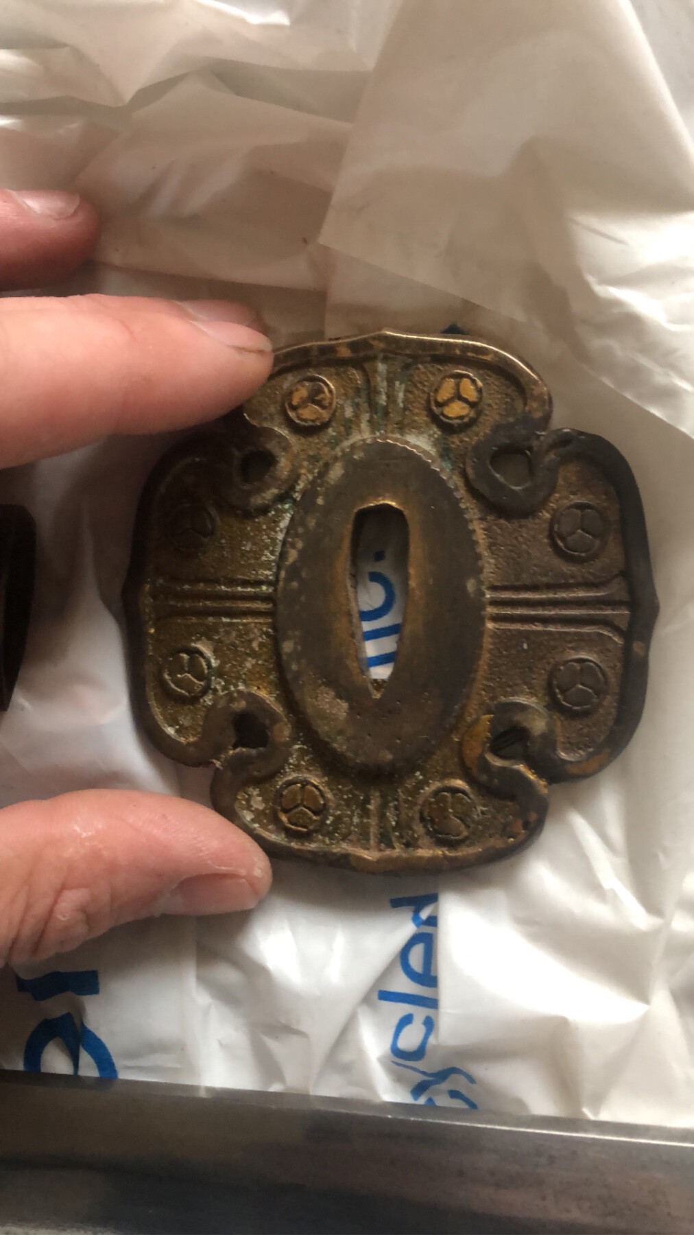

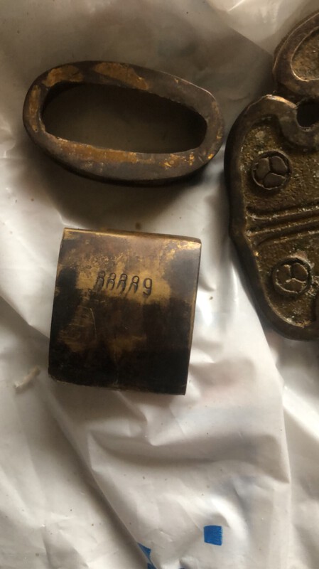

Baka Gaijin Posted May 1, 2024 Report Posted May 1, 2024 Families usually did not stamp the habaki of their ancestral swords with Arabic numerals. Quote

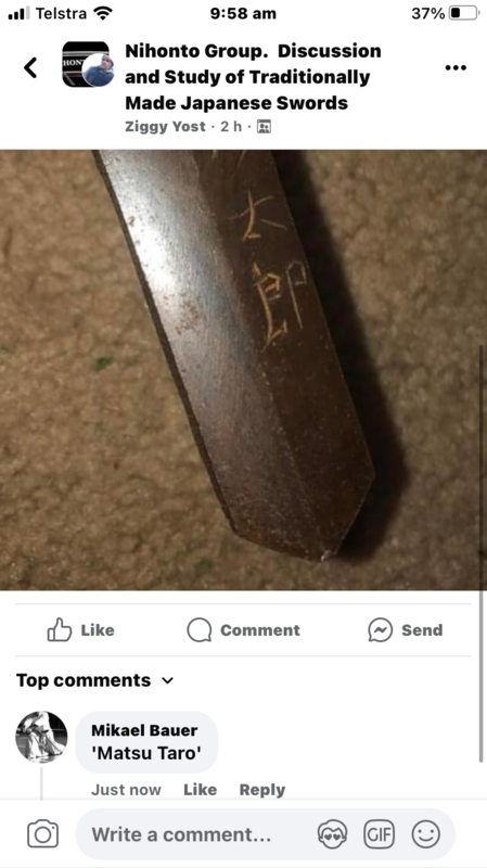

robinalexander Posted May 1, 2024 Report Posted May 1, 2024 Ziggy, I agree with all above members comments including your own (below) ............. 1 hour ago, Ziggy said: it’s got every detail to say it’s not army issue Clear pics of the blade, kissaki may help put it to bed. As an interesting aside, I note the name '" Mikael Bauer " in your OP. If he is the same MB from Montreal ? I was just wondering if he appraised this sword. Rob Quote
lonely panet Posted May 1, 2024 Report Posted May 1, 2024 Bit annoyed that my pun got overlooked. Seki-to, showa-to, murata-to..... Now entre the fake-to. Its got to a catfish post. Blind Fred knows it utter crap 6 Quote

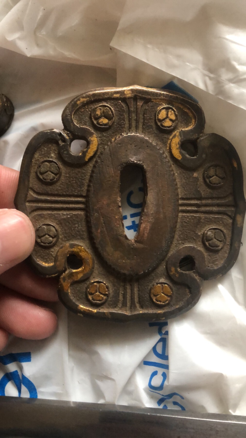

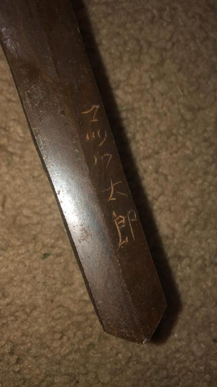

Bruce Pennington Posted May 1, 2024 Report Posted May 1, 2024 Ziggy, I'm not a nihonto guy, but I've seen a lot of Chinese fakery. The practice of stamping numbers on habaki is a Chinese practice, whether legit military sword or a reproduction, period. The nakago and tsuba/sepppa set appears to have been coated with some brown substance. You can see where it has flaked off several spots on the tsuba. Also the one shot of the combined tsuba/seppa has 'track' marks, maybe like it was held in a vise? The nakago mei is uncharateristically low towards the end, not normal for Japanese swords unless the nakago is shortened after it was made. My two cents Like the other guys said, seeing the blade might add some clarity. Quote
Abaris Posted May 1, 2024 Report Posted May 1, 2024 Also, the mei is not traditionally engraved, and the tsuba has the seppa sculpted on it. Quote
