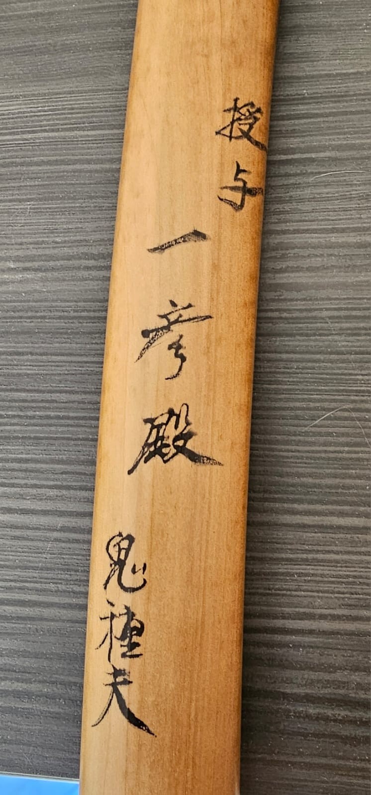

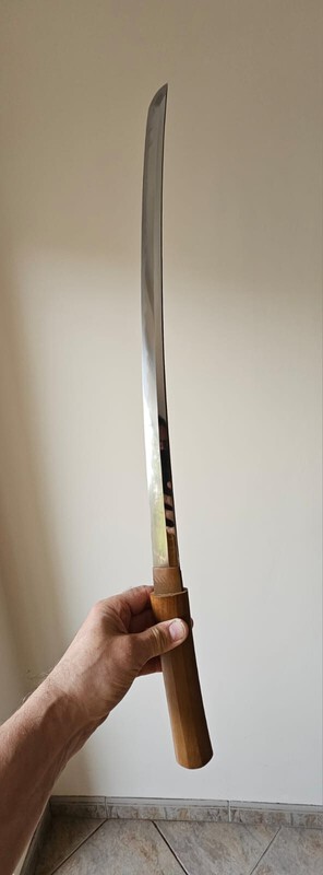

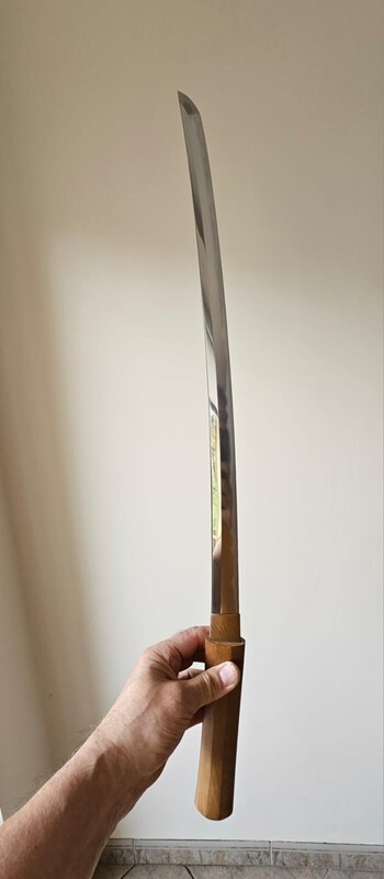

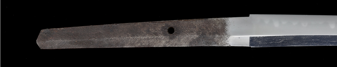

2devnul Posted April 28, 2024 Report Posted April 28, 2024 Hello, My friend has an interesting Wakizashi which we are trying to identify. From Sayagaki we understand that this sword was a gift. Can someone please provide exact translation? Sword itself is a mystery, patina on Nakago might suggest early Edo or maybe even Koto blade. However, it looks like it was 'cleaned' a bit. Maybe someone was looking for Mei (sword is Mumei)? Any comments or suggestions are appreciated. I will try to get different/better pictures. Please share any insights, thanks! Quote

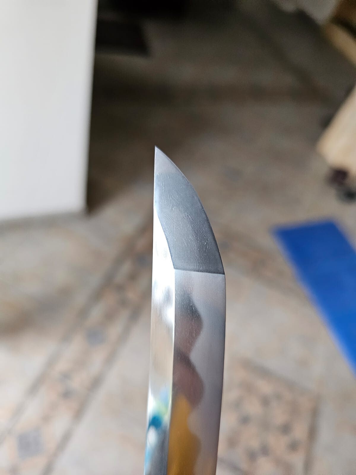

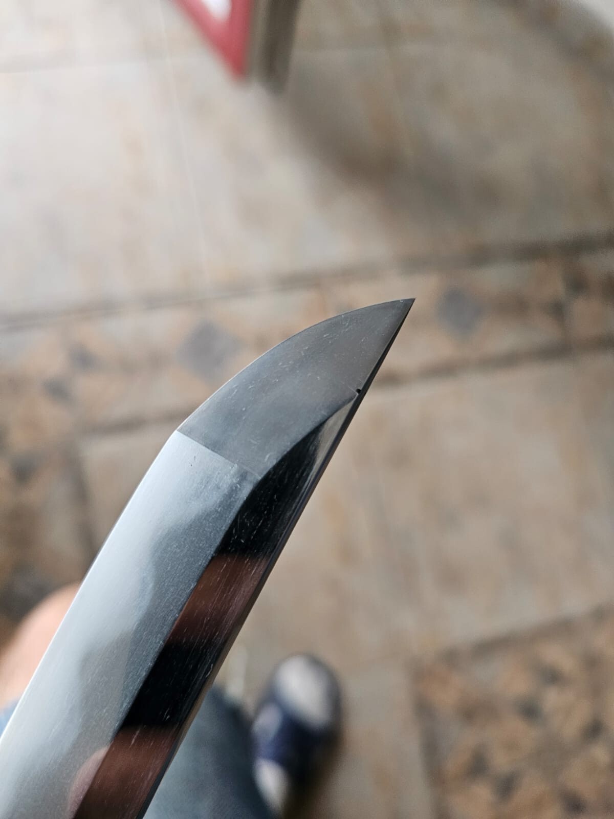

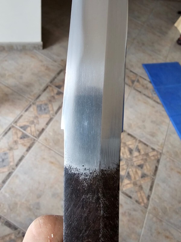

Franco Posted April 28, 2024 Report Posted April 28, 2024 Could we please see the boshi and area of the hamachi? Thank you. Regards 1 Quote
2devnul Posted April 28, 2024 Author Report Posted April 28, 2024 1 hour ago, Franco D said: Could we please see the boshi and area of the hamachi? Of course, thanks for the help. I hope this helps. Quote
Franco Posted April 28, 2024 Report Posted April 28, 2024 Shinto is probably the correct time frame. Regards 1 1 Quote
2devnul Posted April 28, 2024 Author Report Posted April 28, 2024 1 hour ago, Franco D said: Shinto is probably the correct time frame. Regards Thank you for your opinion. My guess is also Shinto, although my friend thinks that patina on Nakago is older. Do you know maybe what exactly is written on Sayagaki? Quote
ROKUJURO Posted April 28, 2024 Report Posted April 28, 2024 Looking at crude YASURI-ME, drilled, clean MEKUGI-ANA, (artificial ?) patina on NAKAGO, it is perhaps modern. SAYAGAKI: HEISEI 14 ? NAKAGO photos are upside-down. 1 Quote
PNSSHOGUN Posted April 29, 2024 Report Posted April 29, 2024 Shinto, Takanoha Yasurime and Hamon suggest Mino influence. 1 Quote
Franco Posted April 29, 2024 Report Posted April 29, 2024 9 hours ago, 2devnul said: My guess is also Shinto, although my friend thinks that patina on Nakago is older. Do you know maybe what exactly is written on Sayagaki? Well then, the patina would make the nakago older than the rest of the sword. Unfortunately it doesn't work that way. Sorry, no. You might try asking in the translation forum for a translation of the sayagaki. Regards 1 Quote
Bugyotsuji Posted April 29, 2024 Report Posted April 29, 2024 I can read it, but I'm not 100% sure what it means. Jean has the date above correct, Heisei 14, and it's April 15. 授与 (Juyo) is an awarded gift from above, someone senior to the recipient. Then it says 一彦殿, (Kazuhiko Dono, i.e. from? the esteemed Hazuhiko). 鬼種夫 (Kishuo?) seems to be the signature of the writer, but is it an Anime creature's name, 'husband of the demon'??? 1 2 Quote
Jacques Posted April 29, 2024 Report Posted April 29, 2024 Mino, probably sue koto Takanoha yasurime were not used in Shinto era. 1 Quote
2devnul Posted April 29, 2024 Author Report Posted April 29, 2024 Thank you very much gentlemen for your help. My personal feeling was also Mino related blade. That is based on the attribution. About patina and 'cleaning' of it, who knows... I will ask for Sayagaki in translation section of the forum. Cheers! Quote
Bugyotsuji Posted April 29, 2024 Report Posted April 29, 2024 See the translation above, Adam. 1 Quote

Franco Posted April 29, 2024 Report Posted April 29, 2024 Thinking aloud. This sword could be pushing early Shinto based upon shape. Perhaps, even Momoyama. Earlier, hmm. Boshi, more Shinto-ish. Do we see hints of Yakidashi on the ura? Polish, color of jitetsu, sure looks Shinto-ish. Kantei based upon images is always a risk. 1 1 Quote
Jacques Posted April 29, 2024 Report Posted April 29, 2024 4 hours ago, PNSSHOGUN said: These must be optical illusions? https://www.aoijapan...eki-sanami-kanetaka/ https://atarn.mandar...katana-fine-koshirae https://www.bonhams.com/auction/21861/lot/199/a-shinto-katana-with-koshira-e-by-fujiwara-soei-18th-century/ https://www.samuraimuseum.jp/shop/product/antique-Japanese-sword-katana-signed-by-kanetaka-nbthk-tokubetsu-hozon-certificate/ Okay, takanoha yasurime may have been used in early Edo, but it's rare even in Mino, and two of your references are unreliable. Quote Judging from the NBTHK’s appraisal that says this blade was made during the Shinto era Origami doesn't say that. 1 Quote
Rivkin Posted April 30, 2024 Report Posted April 30, 2024 Feels like shinto waki circa 1650. Can be Owari Seki, lower class smith. Nakago has been altered - cleaned or something. Maybe yasurime was redone. Not too much of an effect on price etc.. 1 Quote
2devnul Posted May 6, 2024 Author Report Posted May 6, 2024 Hello, There is an opinion of one collector/expert who examined the sword personally, that this could be Muromachi Kanemoto. What do you think? Is it possible? Quote
