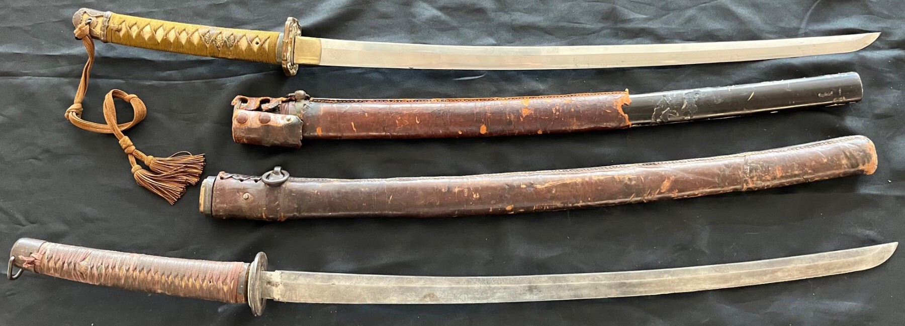

Mich Posted April 27, 2024 Report Posted April 27, 2024 Well I reckon the best way to learn is probably the hard way... I picked these up at an auction the other day and am waiting to see them up close. I believe the top one to be a Type 98 but not really sure about the bottom one. They are not in the greatest shape but they fell within budget and will join my Type 95. Appreciate any info on what you guys see. Once I get them in hand I'll try and get better pics if desired. Thanks Quote
PNSSHOGUN Posted April 27, 2024 Report Posted April 27, 2024 Is the tassel red and brown on the top sword? Page 43 of "Military swords of Japan 1868-1945" has the bottom sword as being made in Java. 2 Quote
Mich Posted April 27, 2024 Author Report Posted April 27, 2024 They should arrive next week. I also could not discern the tassel colours from the pics. The one saya is clearly in a sad state. I would appreciate any advice from you guys re removing the remaining leather - thanks Mich Quote
Matsunoki Posted April 27, 2024 Report Posted April 27, 2024 Just thinking maybe the saya for the top one is an old converted civilian/Samurai one which might mean the blade is an older one? Difficult to say from these images. I would leave the remaining leather….its part of its history. You might try to take it off, doubtless damaging it in the process only to find all the lacquer under it falls off. Saya could be split as well. Wait till yet get em and post better pics. 1 Quote
Bruce Pennington Posted April 27, 2024 Report Posted April 27, 2024 I agree with Colin, nothing to be gained by removing the leather, at at it's age, will probably do some damage. Those are just black, wooden saya, quite often used to house older, family blades. Be sure to update us when they come in! 1 Quote

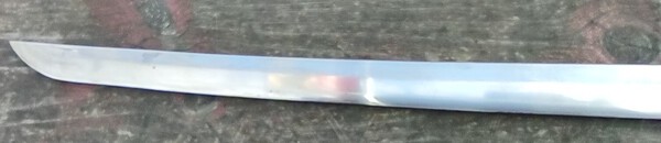

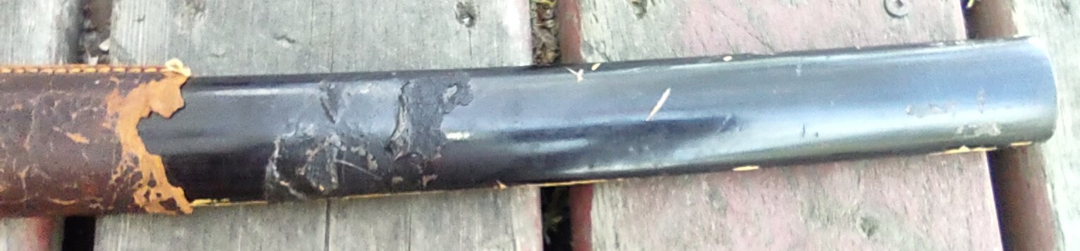

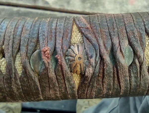

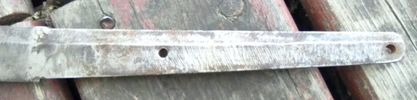

Mich Posted May 13, 2024 Author Report Posted May 13, 2024 Well finally received these two swords. Some pics of #1 which is likely from Java per PNSSHOGun Seems like someone scrawled something (a name) into the leather? She's a rough one boys! Quote

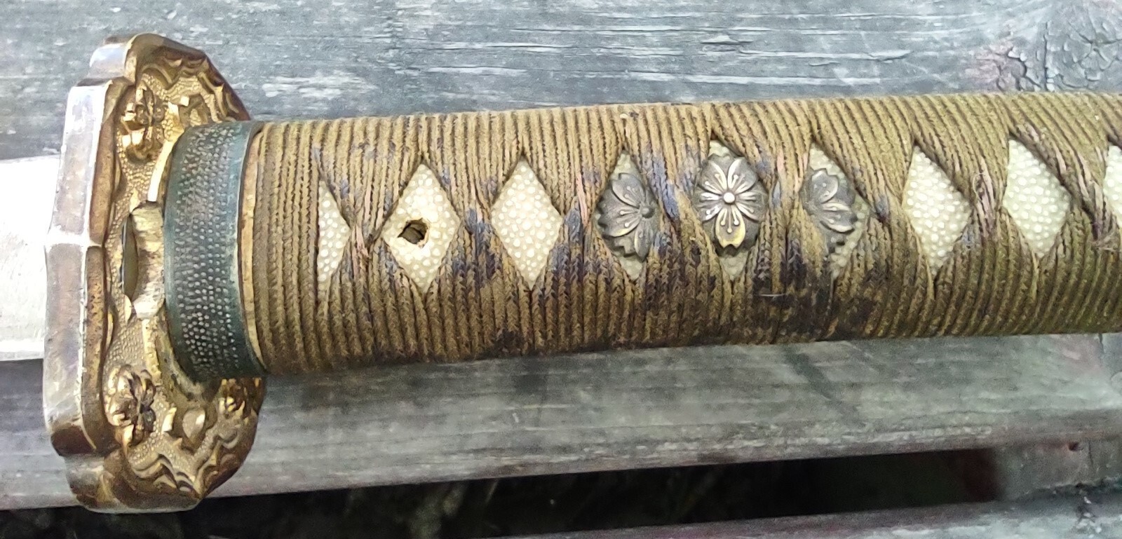

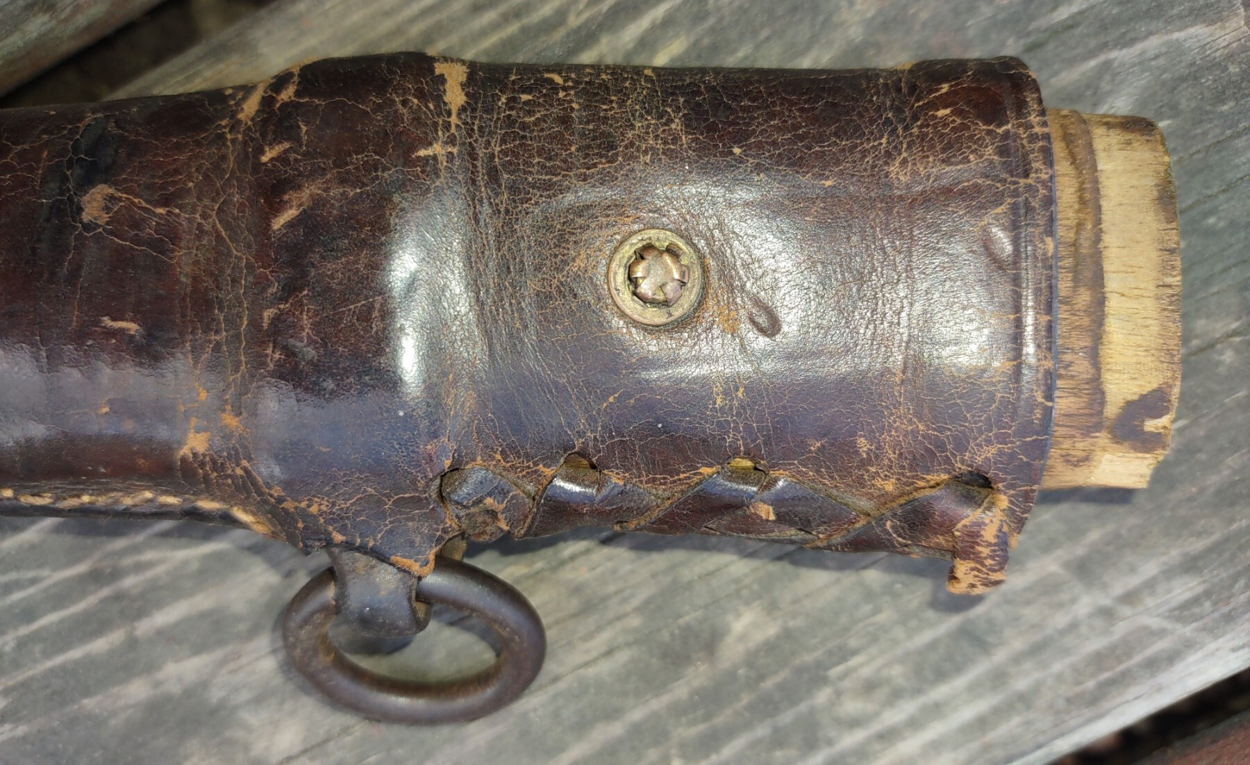

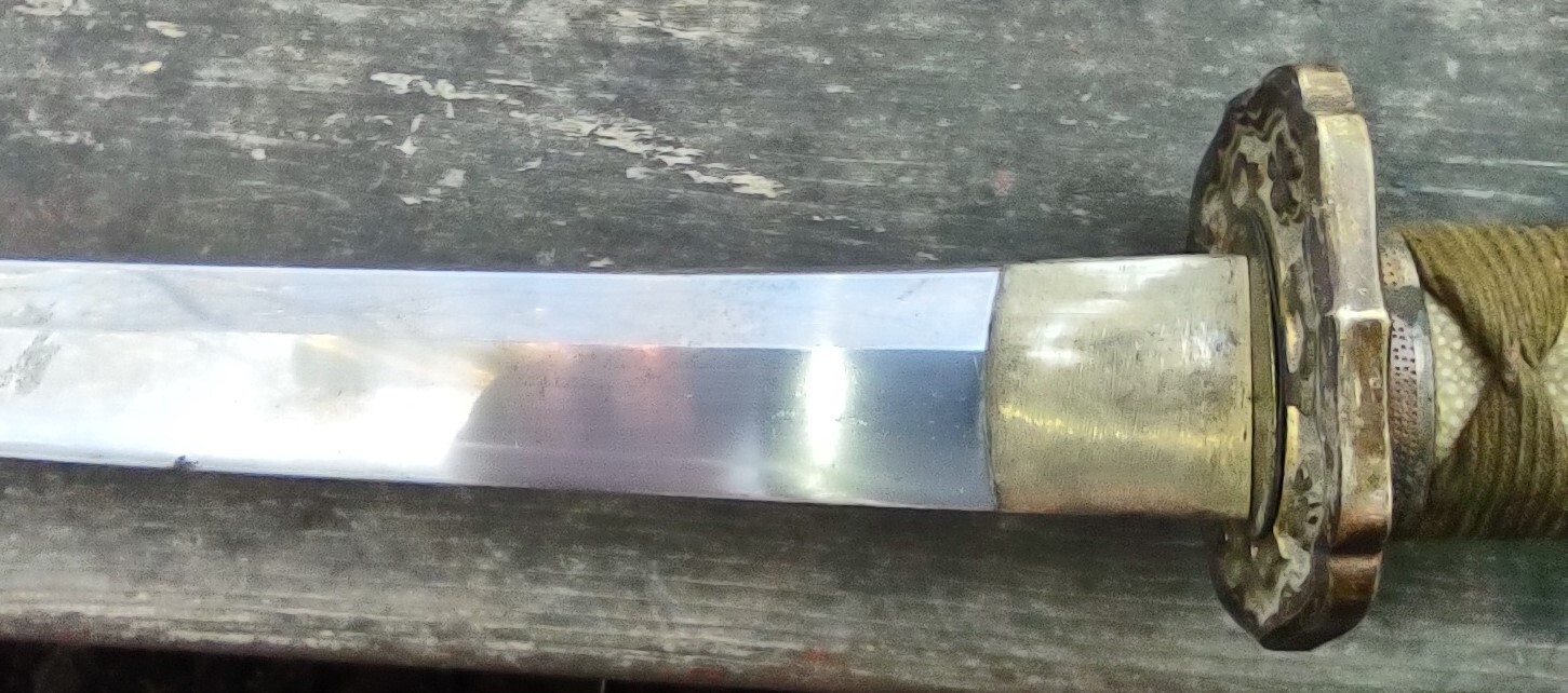

Mich Posted May 13, 2024 Author Report Posted May 13, 2024 23 minutes ago, Matsunoki said: …and #2????🙂 Sorry...here is #2 Quote
Matsunoki Posted May 13, 2024 Report Posted May 13, 2024 Was hoping you’d got an old blade but sadly not. The military sword guys will tell you all about it. Looks better than the first one! Quote
Mich Posted May 13, 2024 Author Report Posted May 13, 2024 14 minutes ago, Matsunoki said: Was hoping you’d got an old blade but sadly not. The military sword guys will tell you all about it. Looks better than the first one! Haha - yep, you never know I suppose! Quote
Kiipu Posted May 13, 2024 Report Posted May 13, 2024 1 hour ago, Mich said: Sorry...here is #2 A Word War 2 Seki swordsmith. 石原兼直 =Ishihara Kanenao 1 1 Quote
John C Posted May 13, 2024 Report Posted May 13, 2024 If the scrawling on the first one were spelled a little differently (Subedar) it could be a military rank in South East Asia. Roughly equivalent to warrant officer. John C. 1 Quote
Yukihiro Posted May 14, 2024 Report Posted May 14, 2024 8 hours ago, John C said: If the scrawling on the first one were spelled a little differently (Subedar) it could be a military rank in South East Asia. Roughly equivalent to warrant officer. John C. To me it rather looks like a surname of German origin : Subauer. Probably the name of the U.S. serviceman who brought it back home as a souvenir. 1 Quote
John C Posted May 14, 2024 Report Posted May 14, 2024 I was seeing "Subadir" so took a guess that who ever wrote it didn't spell it correctly, however you could be right. I couldn't find any references for Subauer. John C. Quote
Bruce Pennington Posted May 14, 2024 Report Posted May 14, 2024 Mich, No date or stamps on the Kanenao? Also, that brown tassel says this was carried by a Gunzoku servicemember. Oh, and for and 'island sword', that nakago on the first one is pretty well made! Quote
Mich Posted May 14, 2024 Author Report Posted May 14, 2024 49 minutes ago, Bruce Pennington said: Mich, No date or stamps on the Kanenao? Also, that brown tassel says this was carried by a Gunzoku servicemember. Oh, and for and 'island sword', that nakago on the first one is pretty well made! Thanks Bruce The only other marks I could find are as follows. (*although the second pic I am not sure is even a stamp?) Quote
Bruce Pennington Posted May 14, 2024 Report Posted May 14, 2024 Thanks Mich! Both are the large Seki stamp, likely date range for you blade is 1941-43, '42 most likely. 1 Quote
Mich Posted May 14, 2024 Author Report Posted May 14, 2024 13 minutes ago, Bruce Pennington said: Thanks Mich! Both are the large Seki stamp, likely date range for you blade is 1941-43, '42 most likely. Thanks again to the members for the help in identifying these. While in less than pristine shape overall - at least they appear to be "original" from what I can tell. I will say the first one (Island Sword) is definitely sharp! Quote

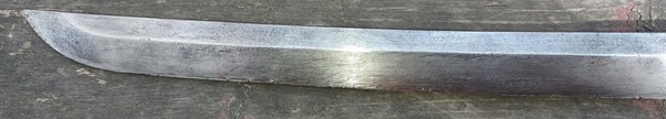

Nihonto Chicken Posted May 16, 2024 Report Posted May 16, 2024 Though not much hataraki may be seen on the "Java sword", good news is that it doesn't appear to be all that pitted. Looks like a prime candidate for a "power uchiko" treatment (just don't ride up and over the shinogi). An hour or two should reveal whatever activity is present, though the Seki stamp advises keeping your expectations modest. Quote
