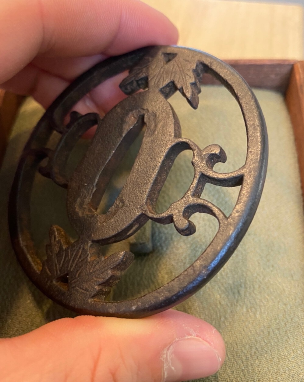

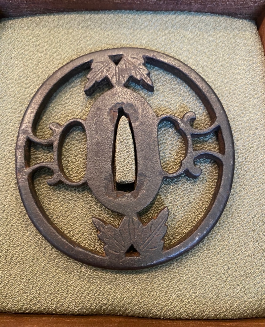

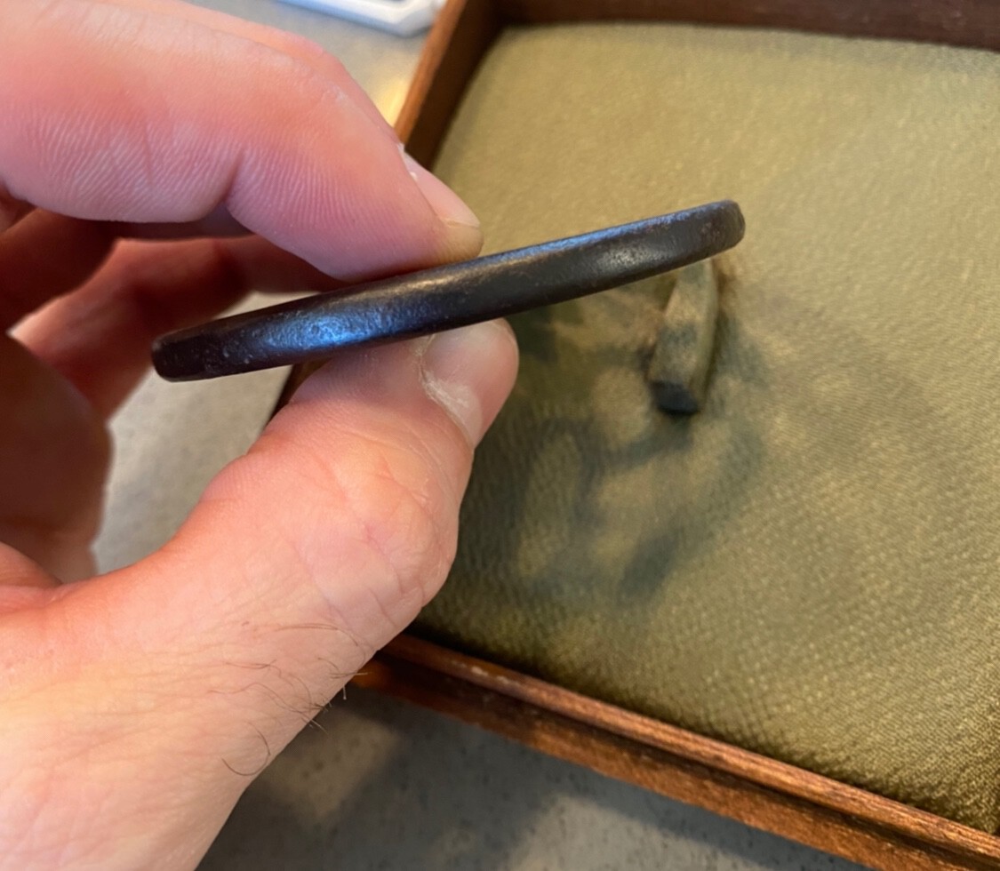

Scogg Posted April 23, 2024 Report Posted April 23, 2024 (edited) I’ve got this tsuba that I’m pretty sure is Owari. I had thought the motif was maple leaf, but I saw some similar listed as paulownia leaf. Maple or paulownia? Something else? Cheers, -Sam Edited April 24, 2024 by GeorgeLuucas Change title. Added “Cast?” 1 1 Quote
Dan tsuba Posted April 23, 2024 Report Posted April 23, 2024 Whatever leaf! My opinion is that the tsuba is cast! It looks to have several casting flaws. Take a hammer to it and see if it breaks! Onward! With respect, Dan 3 Quote

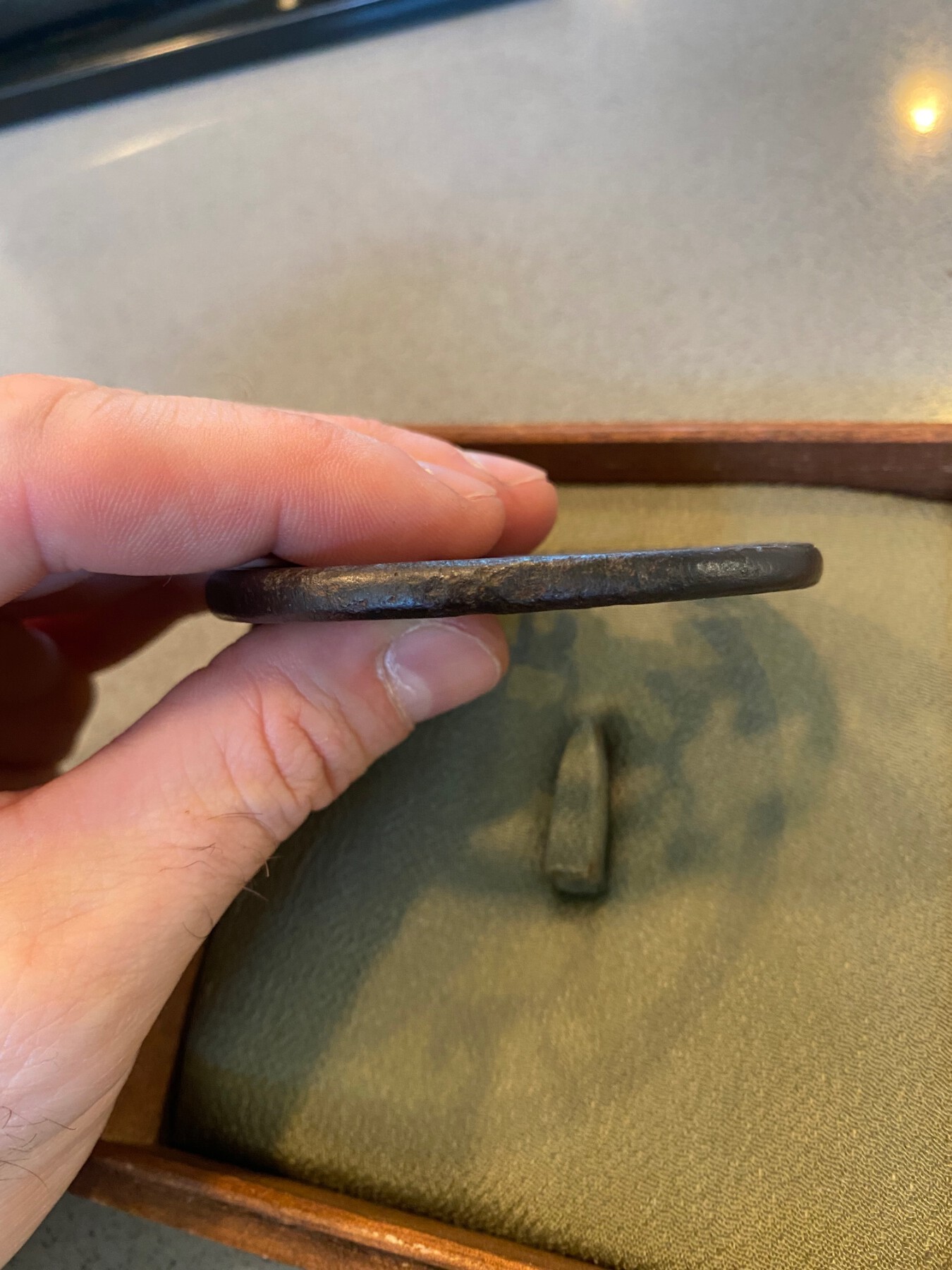

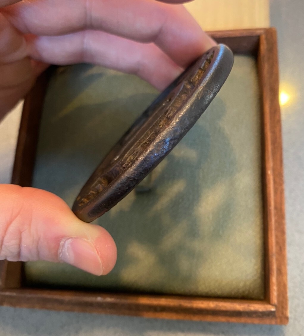

Scogg Posted April 23, 2024 Author Report Posted April 23, 2024 On 4/23/2024 at 11:15 PM, Dan tsuba said: Whatever leaf! My opinion is that the tsuba is cast! It looks to have several casting flaws. Take a hammer to it and see if it breaks! Onward! With respect, Dan Expand Bummer! Not doubting you, but would you mind pointing out where you see casting flaws so that I can see them? Admittedly, I’m not well versed in fittings Cheers, -Sam 1 Quote

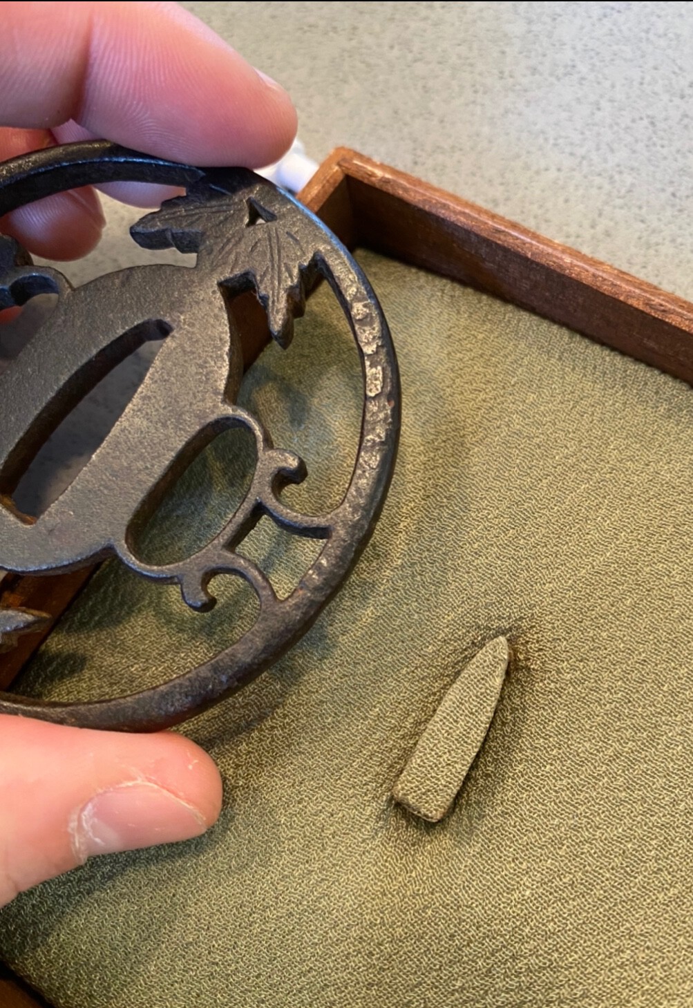

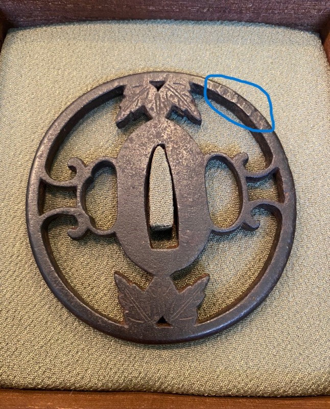

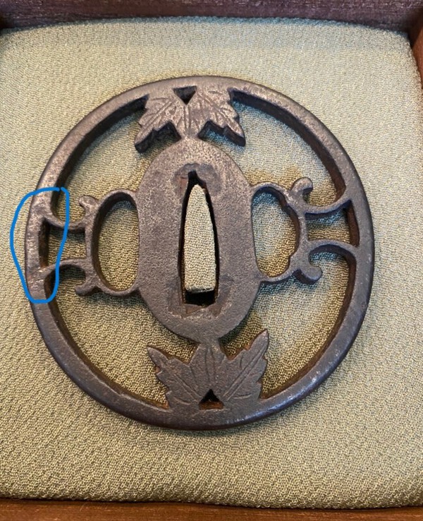

Dan tsuba Posted April 23, 2024 Report Posted April 23, 2024 Hello Sam! I am probably totally wrong and don't want to "rain on your parade" (I am certain other members will let me know!!). But this is what I see! Pictures attached. With respect, Dan 3 Quote

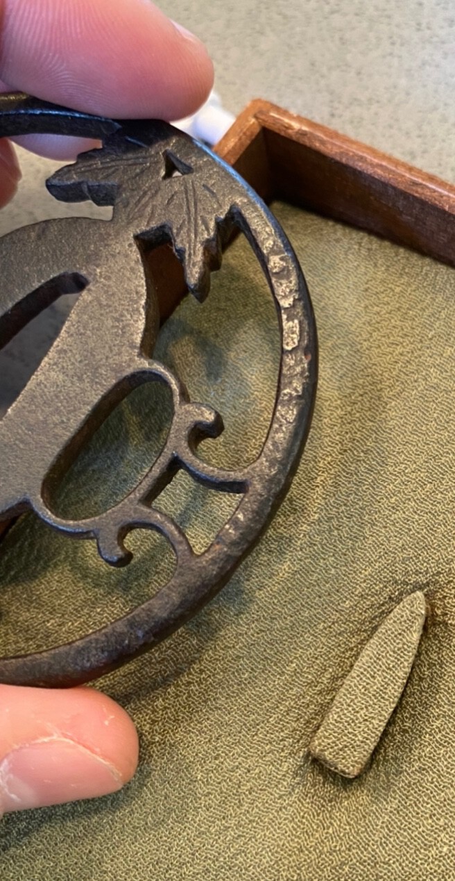

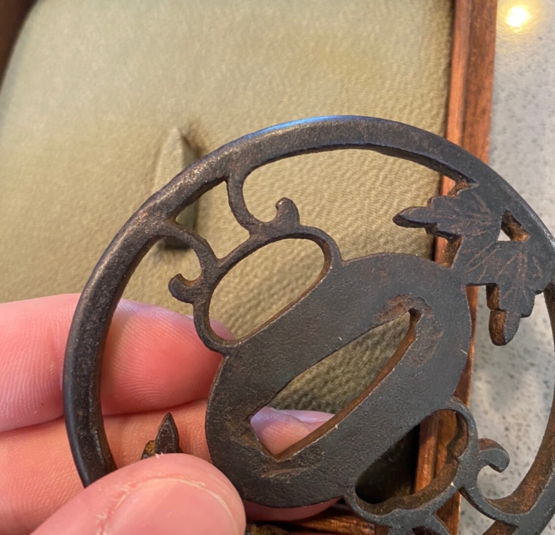

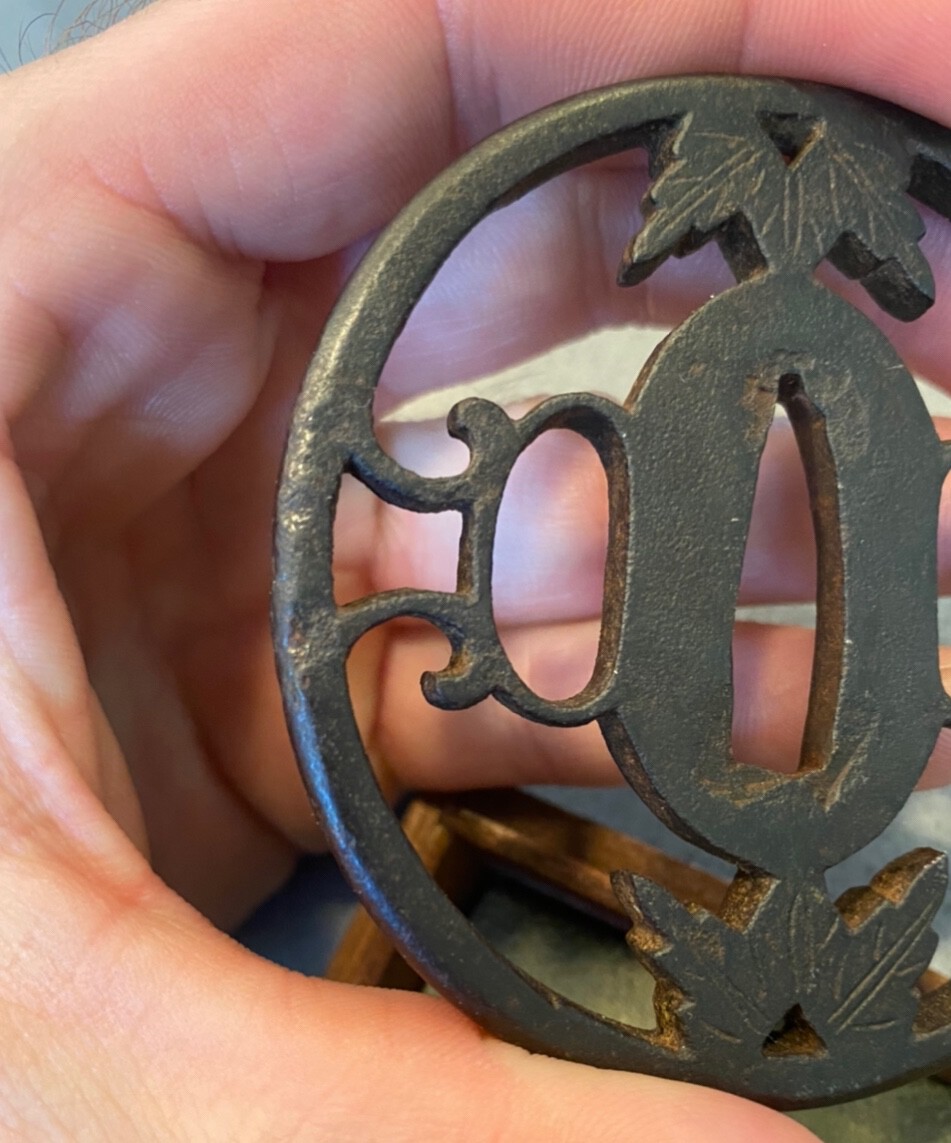

Scogg Posted April 23, 2024 Author Report Posted April 23, 2024 There’s no raining on this parade . It’s no problem at all - I’m here to learn. Hopefully I’ll get some more opinions that help confirm or deny that if it’s cast. Here’s some more photos where I focused on some of the areas you circled. I appreciate the help! It’s always a learning experience (last photo of one of the more smooth sides) All the best, -Sam 2 1 Quote

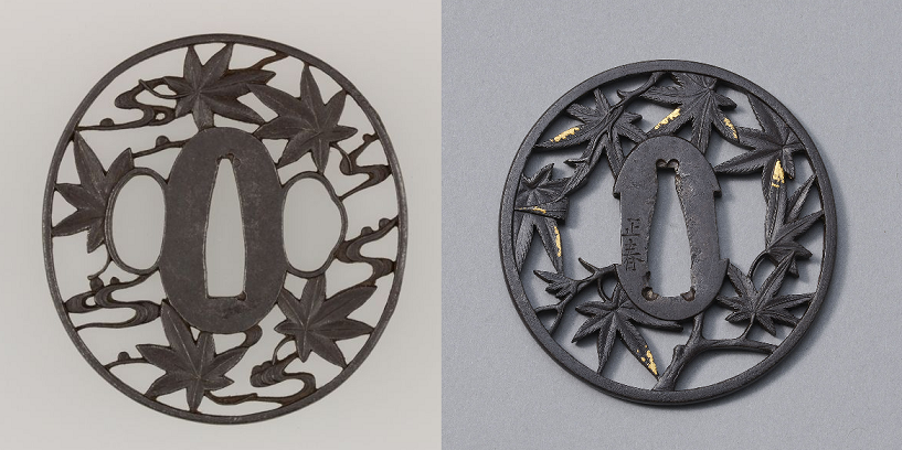

Spartancrest Posted April 24, 2024 Report Posted April 24, 2024 I think the plant design is a little ambiguous. I can see the resemblance to a Maple leaf plant motif but it also has characteristics of Kiri? The example below from the Varshavsky collection is not a million miles away from your tsuba design, the Kiri motif is just "pulled" further out of the rim and has the usual central top of the leaf which is missing on the one you have. [I have no idea why] " The Kiri (桐) pattern is generally composed of three standing straight inflorescences and three leaves." https://www.samuraimuseum.jp/shop/episode-5-design-plant②/ https://varshavskyco...collection/tsu-0259/ “Gosan no Kiri” once was used by royal families or leaders for their emblems, and it’s being used even ordinary people today as their family crests. Arabesque designs are put between “Gosan no Kiri” patterns and engraved by openwork. Arabesque pattern represents prosperity and longevity. Maples would tend to have more tips to the leaves [depends on each species] 7 Quote
ROKUJURO Posted April 24, 2024 Report Posted April 24, 2024 Sam, I would love to hold your TSUBA in hand, but just looking at the photos, I think it is a legit OWARI TSUBA. The "irregularities" on the MIMI are either TEKKOTSU, but more likely old corrosion remains. Signs of casting would look completely different. 4 1 1 1 Quote
Scogg Posted April 24, 2024 Author Report Posted April 24, 2024 Thank you Jean, and Dale! The triangular negative space ontop of the leaf is what made me think maple, for some reason. But the more kiri depictions I look at, the more I wonder. Ambiguous leaf might simply fit best. As far as the casting goes. I cannot find any discernable "seams" anywhere; and the irregularities appear to be corrosion to my novice eye. Obviously I hope it to be real, so I'm the most biased party here. If there are any photos that would help, let me know, and I will do my best. If it were real, would anyone be willing to guess on it's age? Thanks again for everyone's input. I always learn a lot, and appreciate it. Cheers, -Sam Quote
Robert S Posted April 24, 2024 Report Posted April 24, 2024 I agree with Jean Collin. I don't see any signs of casting on the tsuba. Nice one! Robert S 3 Quote
Soshin Posted April 24, 2024 Report Posted April 24, 2024 On 4/23/2024 at 11:04 PM, GeorgeLuucas said: Added “Cast?” Expand So, newbies in the USA (Dan and Sam S.) now say Owari Tsuba are "cast". I would love to see and feel this tsuba in hand. I don't see anything as such from the limited number of photos provided. What I do see looks to be rust and corrosion damage to the plate surface. There are several iron bones along the rim typical of Owari Sukashi tsuba. If this form lacks high quality examples in excellent conditions to study, I have a few that I can offer to discuss that were once or us still in my collection. 1 1 1 Quote
Scogg Posted April 24, 2024 Author Report Posted April 24, 2024 On 4/24/2024 at 11:23 AM, Soshin said: So, newbies in the USA (Dan and Sam S.) now say Owari Tsuba are "cast". I would love to see and feel this tsuba in hand. I don't see anything as such from the limited number of photos provided. What I do see looks to be rust and corrosion damage to the plate surface. There are several iron bones along the rim typical of Owari Sukashi tsuba. If this form lacks high quality examples in excellent conditions to study, I have a few that I can offer to discuss that were once or us still in my collection. Expand Thank you for your input. I am very happy to hear that it’s not cast. I originally did not think it was cast at all. I’ve enjoyed it in my collection for about a year, and never even considered it being cast. Dan made the cast suggestion, and I admittedly am too new to argue it. So I added the question to the topic for confirmation from the more experienced like yourself, Jean, Brian and Dale. Im glad I did, because y’all have helped confirm it’s not cast. I enjoy admiring it, and have developed a liking to Owari in the process. Thank you for your input and help, All the best, -Sam 2 Quote

DirkO Posted April 24, 2024 Report Posted April 24, 2024 With all respect to the OP - but this is a cast tsuba. The surface of the tsuba is showing small pitting, the lines and carving are far too evenly soft. But the thing that convinces me the most is the seppa-dai area and how it was worked. The tagane-ato punchmarks are not well-defined and too soft. Please compare this to other papered and known examples, they will not show these features. 2 Quote

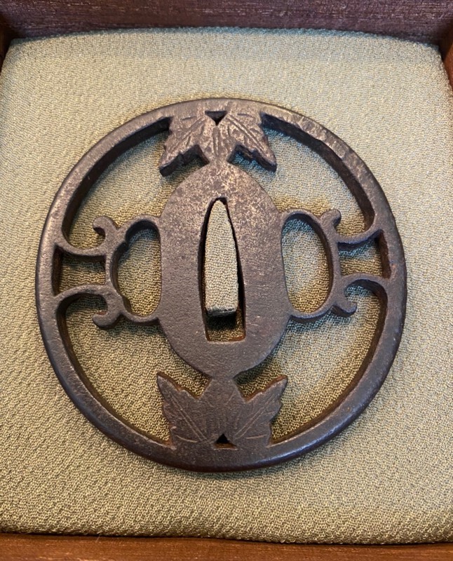

Spartancrest Posted April 25, 2024 Report Posted April 25, 2024 One tiny detail in the original images has me wondering? Is this an inclusion, a gouge mark or a sign of layering? One day in the future we might be able to "virtually" handle each tsuba and give a better conclusion. At the moment it is still informed guesswork for most of us. [still fun though! ] 1 1 Quote
