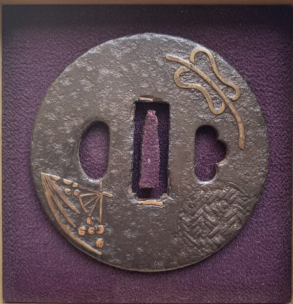

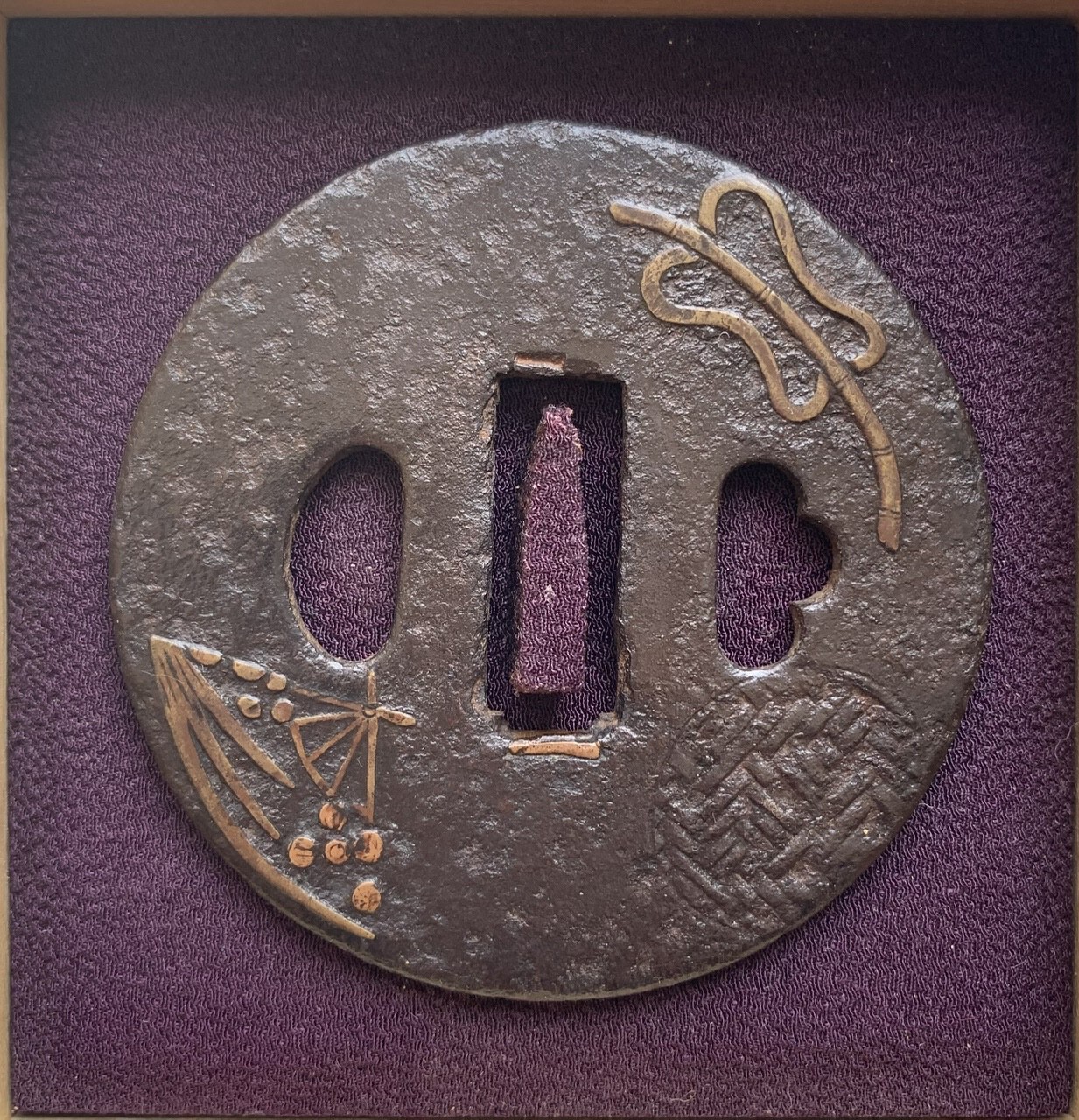

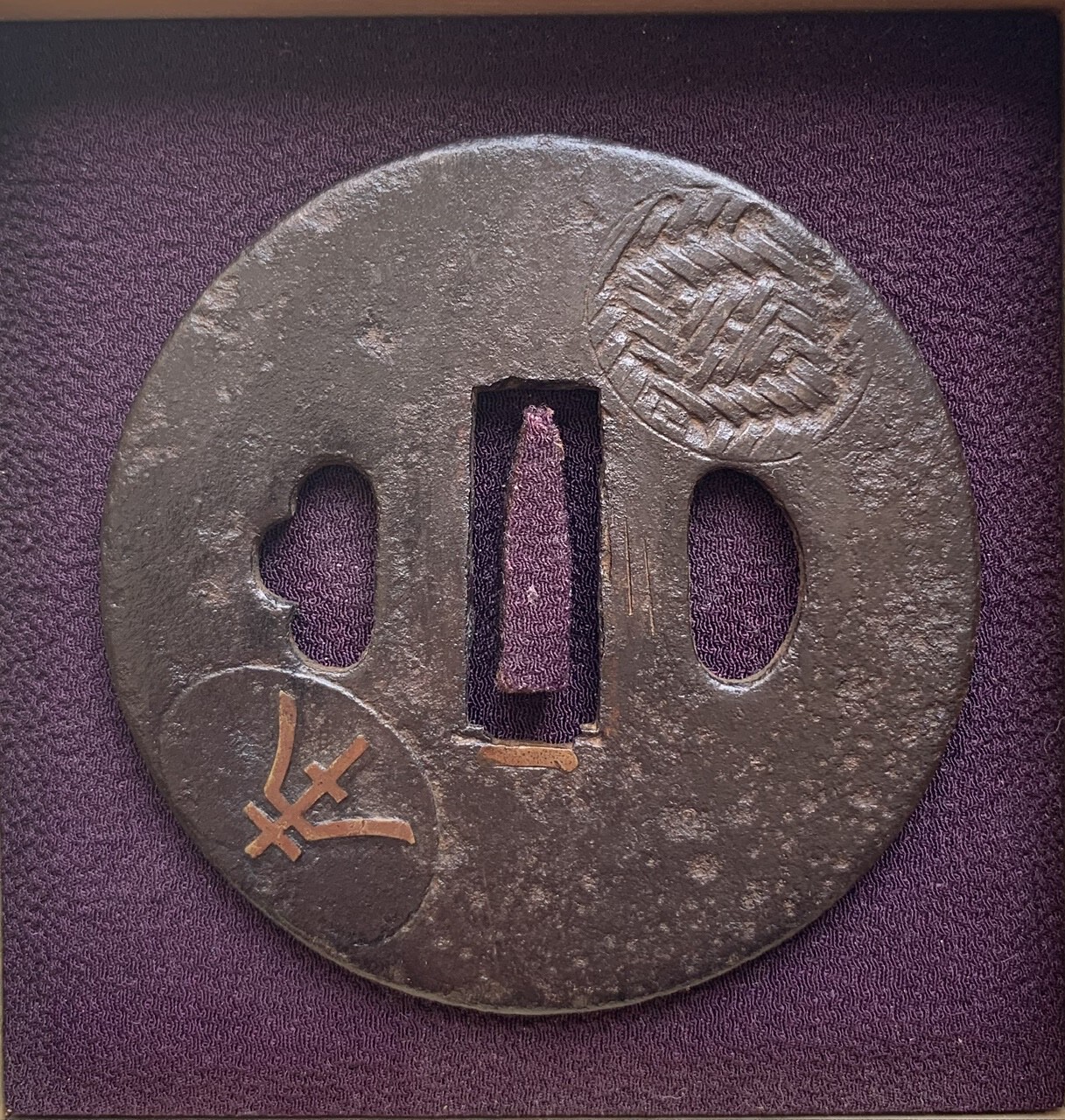

I've been trying to find source material that will tell me what the story is with older tsuba that are 'rounded' in the center of the hitsu ana.
Here is an example from a recent purchase: https://japaneseswor...unusual-tachi-tsuba/
Were these indicative of age? Any information you can share? I believe this is an early piece, but it is frustrating that of the few books I own and hours of searching, I just find second or third-hand references that say it means it's older....Why? More info.? Just trying to understand and learn more is all...
Thank you in advance and any opinions on the tsuba are welcome.
Yes, the nakago ana. Sorry for my mistake. :)
From your feedback, then this would not necessarily indicate age on a given tsuba? Again, I am just trying to learn and understand. Thank you

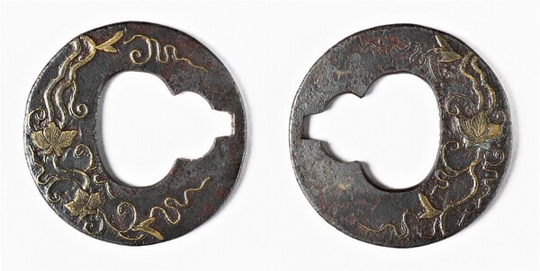

EA1978.250.jpg An extreme example from the Ashmolean museum EA1978.250 - I suspect this was altered to form a Maedate for a helmet

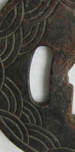

The quote from Japaneseswordbooksandtsuba  "The atypical shape of the ryo-hitsu also indicates an earlier piece"  It shows the elongated "bean" shape hitsu that were indeed found on early guards, many hitsu were also rectangular in shape and like the one you are referring to, were cut in after the guard was first made, at a much later date. Once again this tells us the hitsu is "old" but does not tell us just how much older the guard is. So I don't see the hitsu shape actually tells us how old the guard is [at least not when it is cut in later] JMO

  • There are a few tsuba with really big center holes shown above. I think these were modified to fit on a wooden sword (bokuto or bokken) and was a fad among the kenjutsu practitioners probably in the 19th and early 20th centuries.
