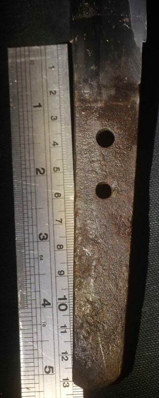

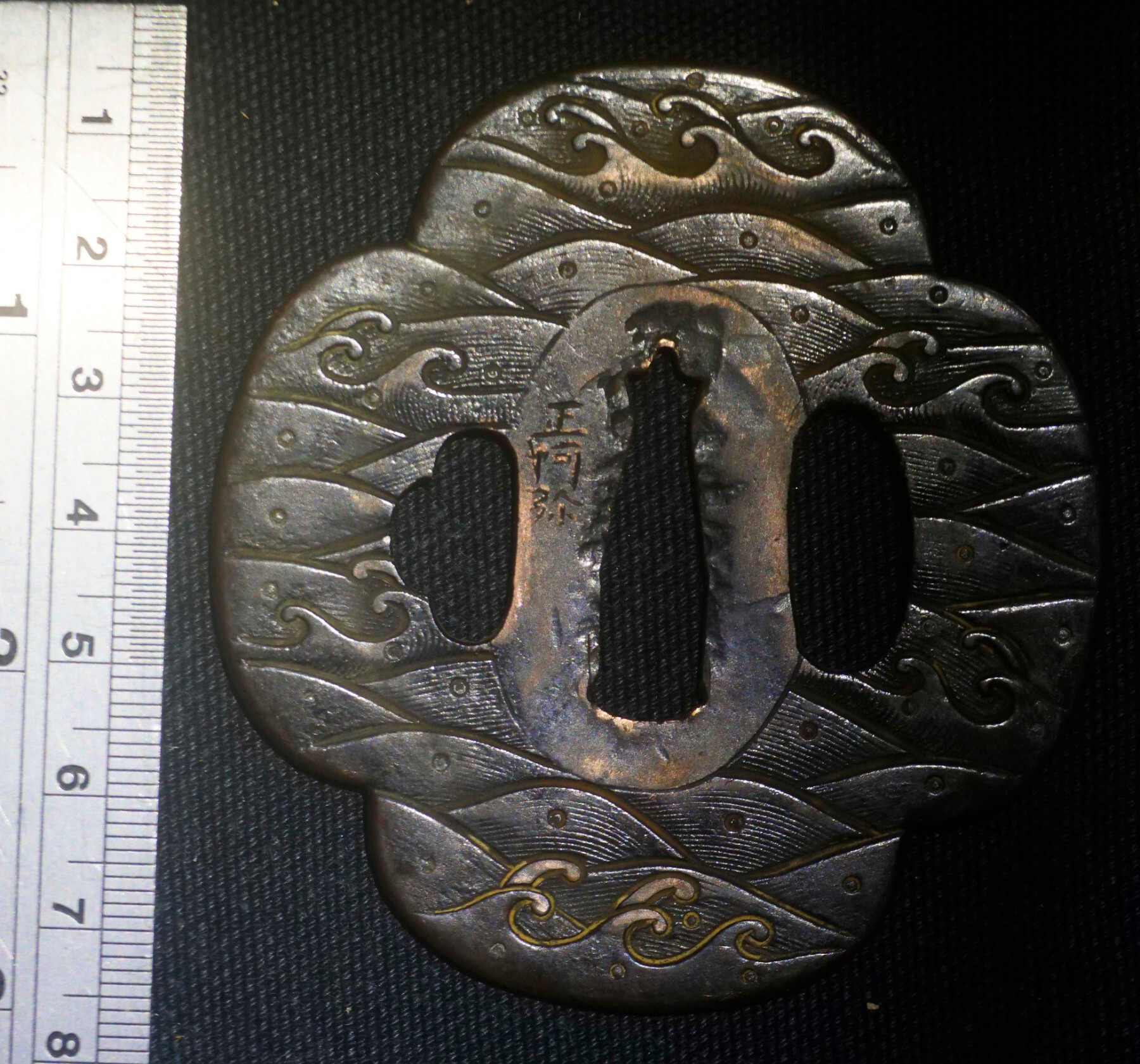

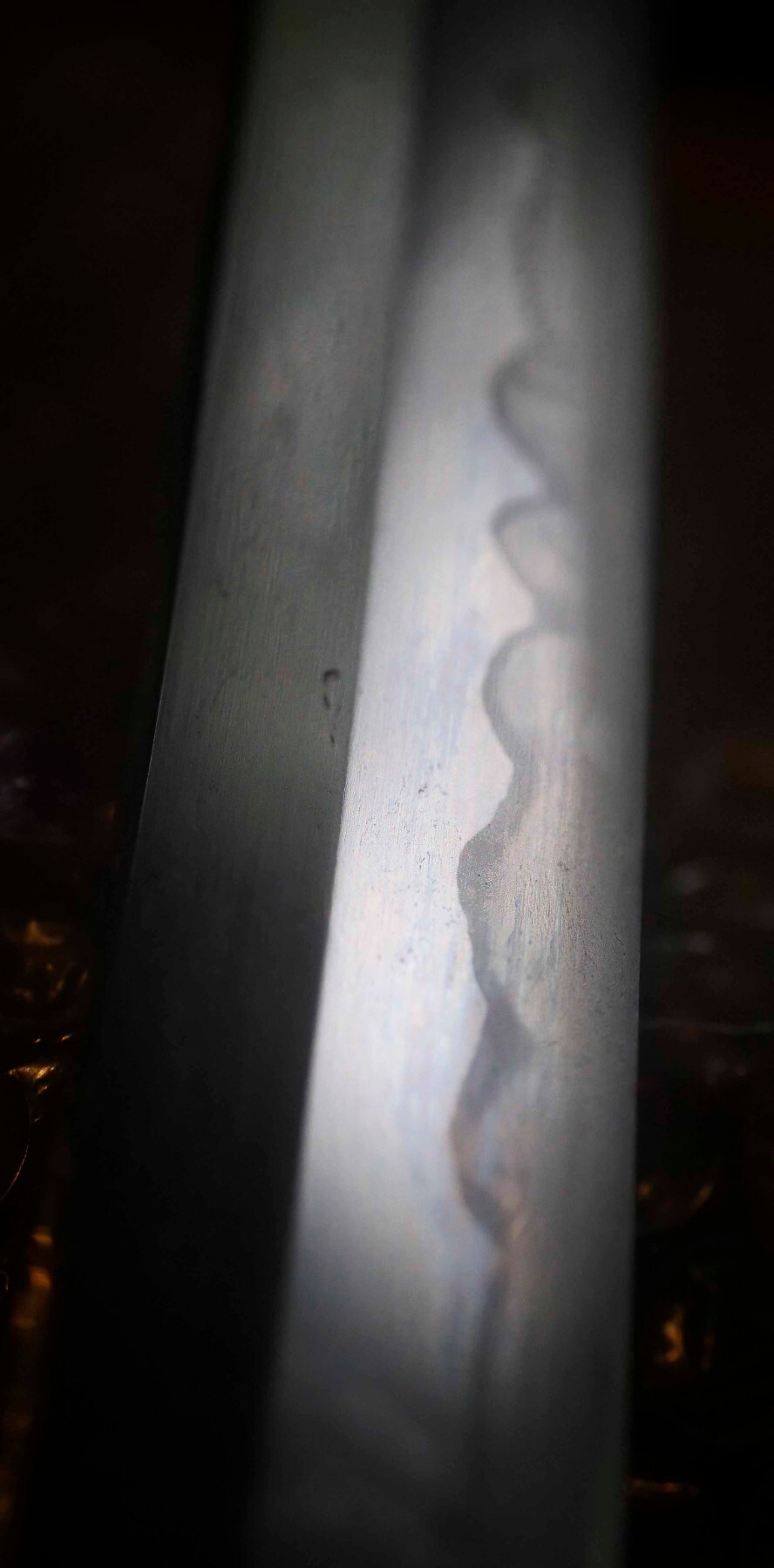

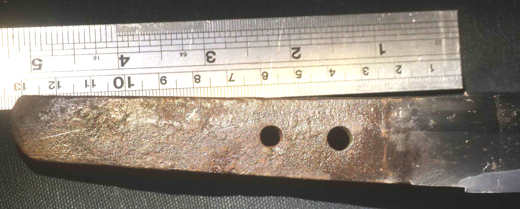

Robert S Posted April 9, 2024 Report Posted April 9, 2024 I’m looking for thoughts from this expert company on a mumei wakizashi that I just purchased from Japan. I am a complete beginner in nihonto, although I have some limited background in smithing, casting, etc I picked this nihonto because it looked like it was in “working class” (if such a thing can be said about nihonto) koshirae, in the tachi style. Sugata: Nagasa – 54cm Motohaba - 29mm, Sakihaba 18mm Motgasane - 5mm, Sakigasane 3.5mm Sori - 10mm Mune – Iori-mune Kissaki is chu-kissaki, but on the o-kissaki side, with a fukura on the scarce side of medium. Blade is in a decent sashikomi polish – better than expected, but with some scratches and defects This blade appears o-suriage (tensho-suriage). Although the polish makes it look like the hamon ends in the normal way, beneath the polish it appears to continue into the nakago. If there was a mei, it was lost. Tsuba is copper, in a simple wave pattern, with the mei on the blade side. Tsuba appears to have originally been fitted to a tachi, with the nakago-ana later inverted. Tsuba mei is “Shoami”, but with an unusual variant of the simplified character for “mi”. I can’t tell if the hitsu-ana were original, or added later. Without the signature I would have called it probably ko-kinko… I wonder if it is possible that it was signed by the smith doing the conversion? Tsuba fit is quite loose. Saya appears to be wrapped with a course fabric and lacquered with possibly a vermillion lacquer, and has Ishizuki and Kashiwaba. There is no provision for a kuzuka or kogai. Fittings are all workmanlike rather than fancy. Menuki is a nice running boar (in shakudo?) As to the blade, here my extreme lack of experience means that I may be way off track. My thoughts: Jigane & Jihada Itame mixed with mokume, only visible in some areas beneath the sashikomi polish. Distinct ha-hada. No evidence of Chikei. Hamon & Boshi Hamon is gunome-midare, tending towards koshi no hiraita. Fairly bright nioiguchi, with nie in both the ha and ji, and islands of nioi/nie in the ha. One area of distinct midari utsuri, but otherwise absent or not visible. There are dark lines cutting through the nioi/nie – part of the forging structure, but not distinct kinsugi. Kissaki boshi is Notare-komi, tending toward Kaen. When and where? My wild guesses as to date/area: If this is the lower half to two thirds of a tachi, as I guess, the slender form and taper feels Heian, but the hamon more early to mid Muromachi (Oei Bizen?). I’m guessing that the sword broke, and the length remaining was only sufficient for a wakizashi length blade. Possibly the saya was also shortened, keeping the original tachi fittings. These fittings could also be bakamatsu, but the style and simplicity makes me think not, and the O-suriage appears to have occurred a long time ago, given nakago condition. I look forward to your thoughts Robert S 1 Quote
DoTanuki yokai Posted April 9, 2024 Report Posted April 9, 2024 The blade looks unshortned Ubu, the Hamon clearly starts directly at the Hamachi. The polish also does not really look right, maybe it is some kind of Hadori or acid etched but not Sashikomi in my opinion. What you see before the Hamon could be some kind of mizukage, also the Nakagojiri does not look like a typical shortned one. 1 2 Quote
Franco Posted April 9, 2024 Report Posted April 9, 2024 49 minutes ago, Robert S said: Blade is in a decent sashikomi polish Not sashikomi. 49 minutes ago, Robert S said: This blade appears o-suriage (tensho-suriage). Looks ubu, machi-okuri. 49 minutes ago, Robert S said: Tsuba is copper No, this is shakudo. Looks copper because the patina is worn off. 2 2 Quote
Robert S Posted April 9, 2024 Author Report Posted April 9, 2024 Thanks so much for the really useful feedback already! Like I said, total beginner here. Anything you can tell me about what you are seeing that leads you to certain conclusions would be greatly appreciated for my learning! Quote
Robert S Posted April 9, 2024 Author Report Posted April 9, 2024 I think I see what Christian S and Franco D mean about not sashikomi, now that I've been pointed in that direction! Quote

Nihonto student Posted April 10, 2024 Report Posted April 10, 2024 Dear Robert, I agree with Kirill about the dating but personally I have more of a bizen den feeling, shinogi-ji hada looks itame and I would expect to find masame in a Mino blade, lack of nie and general soshu den features, kurijiri nakago call Bizen den but was popular also in Mino den at the end of Muromachi...if it is a Mino blade it still has a marked influence of Bizen. Giordy 1 Quote
Jussi Ekholm Posted April 10, 2024 Report Posted April 10, 2024 Like others I would think ubu late Muromachi blade. 1 Quote
2devnul Posted April 10, 2024 Report Posted April 10, 2024 Hi, Nothing to add about Sugata, but polish seems odd. Definitely not Sashikomi, looks like a Hadori wanna be with acid. Quote
vajo Posted April 10, 2024 Report Posted April 10, 2024 For me the blade looks shortend. The hamon is treated with acid, bad polish. Late muromachi/ early shinto. 4 Quote
Robert S Posted April 10, 2024 Author Report Posted April 10, 2024 Thanks again everyone for the guidance and thoughts - really helps me learning what I am seeing - it's so easy to get way off track when you know as little as I do :-) . I think I'll consider whether to get it a proper polish - I know it's probably not monetarily worth it, but it feels like it would be rewarding to see what that would bring out. I did wonder whether those nioi/ni islands in the ha would be diagnostic of a particular maker or school? Quote
