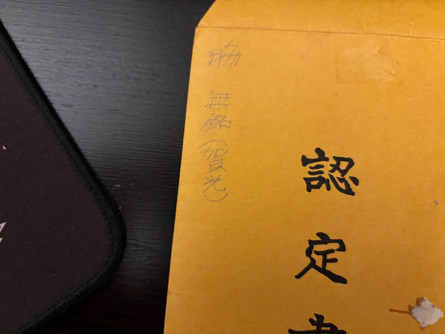

Reinier Posted April 4, 2024 Report Posted April 4, 2024 Hello, Can someone please translate this old NBTHK Kicho origami for me? I am also curious what is written in pencil on the envelop. Thank you very much! Reinier Quote
Ray Singer Posted April 4, 2024 Report Posted April 4, 2024 Wakizashi, mumei Yoshimitsu (賀光). nagasa: 1 shaku 7 sun 8 bu 1 Quote
Bugyotsuji Posted April 4, 2024 Report Posted April 4, 2024 And in pencil, quick short-form note to remind the owner what paperwork is inside the envelope. “Waki Mumei (Yoshimitsu)” Quote
