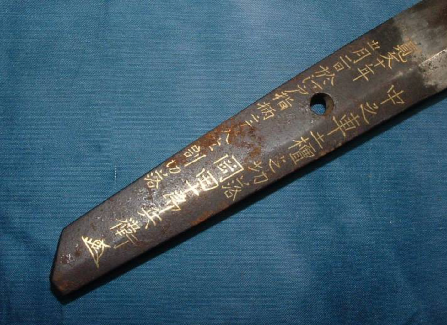

John C Posted April 3, 2024 Report Posted April 3, 2024 Just curious what you all think about the legitimacy of this cut test. Trying to learn more about them. The tester is not listed in Guido Shiller's "List of popular sword testers in saidan-mei". https://www.ebay.com/itm/166679064949 John C. Quote
PNSSHOGUN Posted April 3, 2024 Report Posted April 3, 2024 It may be correct, it has been inlaid with some degree of skill. The issue is the Mei is very suspect, which pulls everything into question. Quote
John C Posted April 3, 2024 Author Report Posted April 3, 2024 On 4/3/2024 at 2:28 AM, PNSSHOGUN said: it has been inlaid with some degree of skill. Expand I was trying to look for signs of it being inlaid or written on the surface. I found a couple of spots where I can see a shadow (indicating inlay) and the rust is covering some characters but I'm still learning what to look for. Does it seem "too" nice for 1670?? John C. p.s. not interested in buying just learning. Quote

Salvatore Posted April 3, 2024 Report Posted April 3, 2024 Hello, I don't know too much but I think this is gimei. Because the inscription of testing is not so good, the inscription of Kotetsu is a little bit different in letter by letter and the nakago jiri is different too from other genuine Kotetsu. 1 Quote
Bruce Pennington Posted April 3, 2024 Report Posted April 3, 2024 I checked @Markus Sesko's book, Tameshigiri. He has 100 names in the Edo period that did testing, but Jurobei is not on the list. He points out that some of them had other jobs and did testing on the side. I found a Jurobei, a samurai, in this Myths and Legands - The Quest of the Sword. If he was a real person, and not a myth, he could have done a testing on the side. Or the Japanese faker that sells through Komonjo took the name from the myth. No way to know. 1 Quote
Nobody Posted April 3, 2024 Report Posted April 3, 2024 Here is an NBTHK Hozon mumei katana with Okada Jurobei’s kiritsukemei. So, he seems to be a real person, though Kotetsu mei may be questionable. Ref. 日本刀 刀 無銘(越前関)(銀象嵌)下ヲケス工落岡田十郎兵衛重長(花押)試焉 (金象嵌)ニツ胴入土壇村井三丞長止(花押)試焉 |日本刀 刀剣販売 e-sword 1 1 Quote

Tengu1957 Posted April 3, 2024 Report Posted April 3, 2024 As a person who collects test cut swords I would say without a NBTHK paper all test cuts are suspect. If it's on a big name blade without a paper then it's a high chance it's fake as well. The test cuts were very expensive so it doesn't have to be a big name on the sword to be true but why would you want a legit test cut on a gimei sword ? 2 Quote
DoTanuki yokai Posted April 3, 2024 Report Posted April 3, 2024 I did not know Kotetsu signed Wakizashi with Tachi Mei and another guess is that the blade could be Mumei when it was tested 1 Quote
