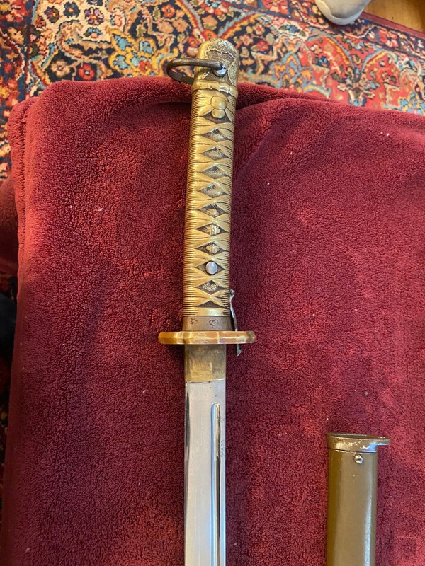

I knew as soon as I saw the brass handle…😢😭
guy paid $500 for it. I showed him the difference between brass (yellow) and copper (reddish brown) and also pointed out all the other problems with it.
No rare item for me. 😫

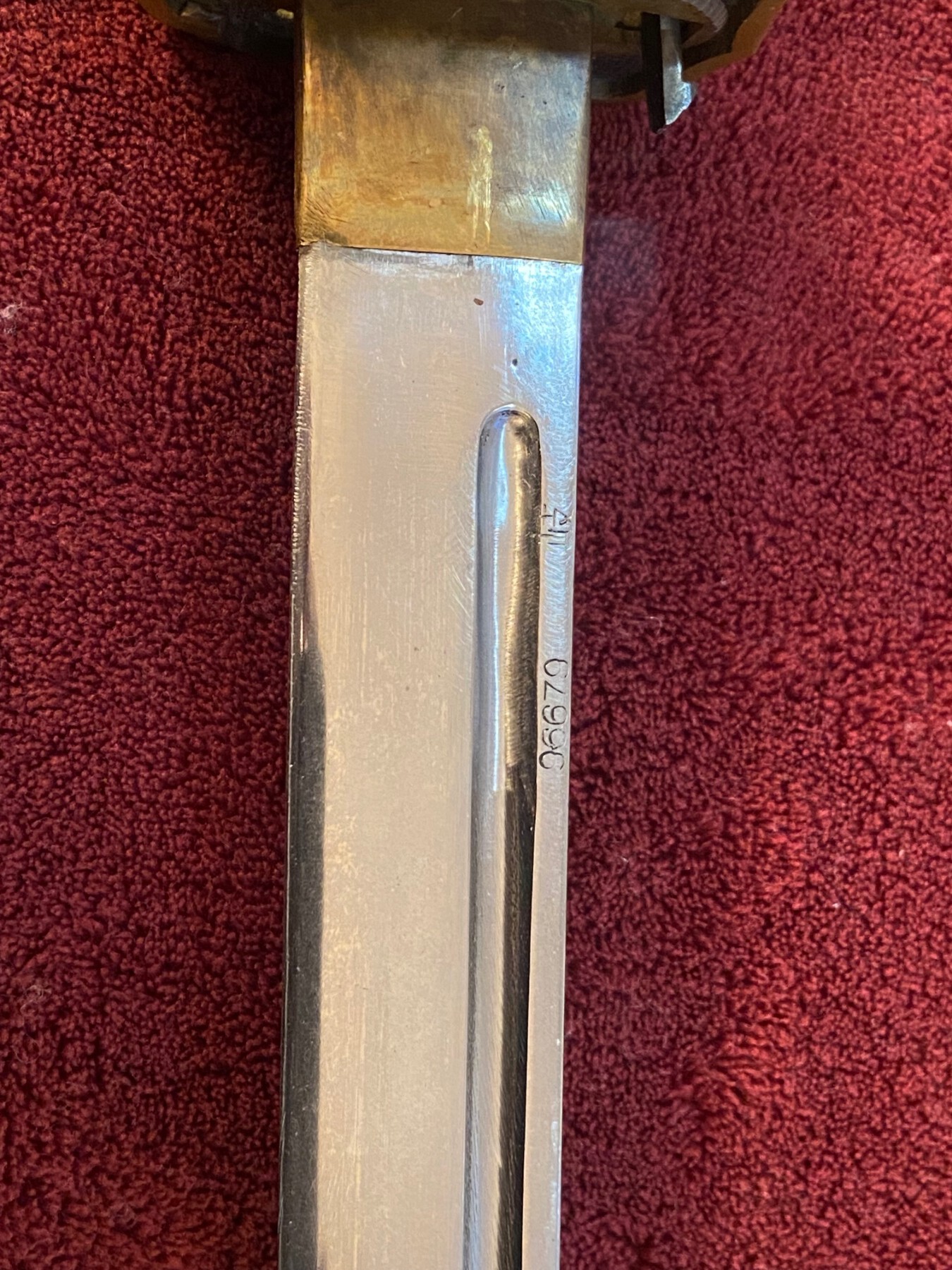

I have to say, they did a nice clean start on that bohi.  It starts too far from the habaki and there's a myriad of other problems, but that is the cleanest start on a bohi that I have seen on one of these brass handled fakes.  From the extra tooling marks in the end of the bohi, it looks like they got in there and cleaned it up to make it look a bit more legit at a glance.
The pictures shows a authentic clear fake type 95. It is to less in quality to call it a good replica.
Speaking of the bohi, not sure if anyone has ever looked but I noticed the beginning and ends of the bohi are not the same on both sides. As I looked at the blade with the edge facing me, I could see the two sides were different.
