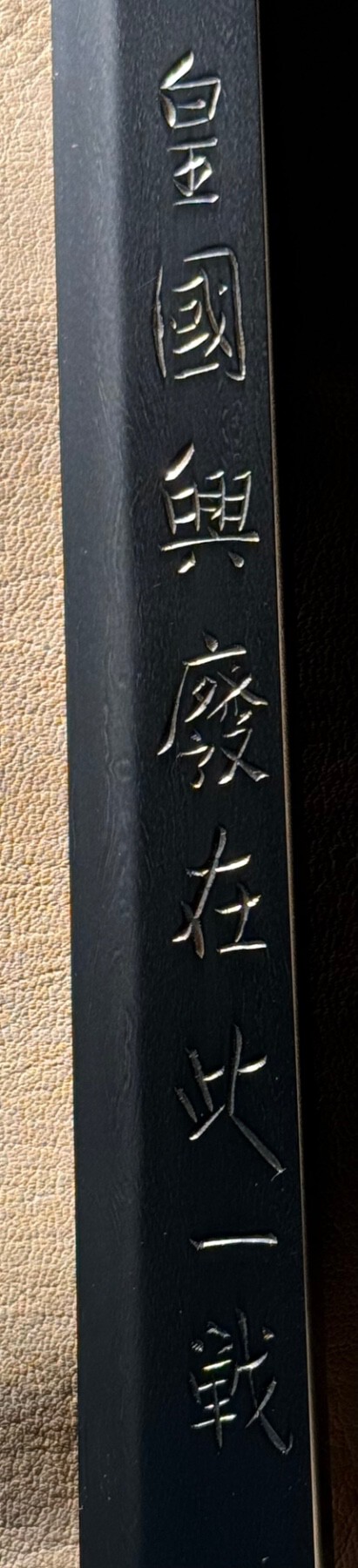

Nicholas Posted April 2, 2024 Report Posted April 2, 2024 Hello all. I just picked up this sword signed Hideaki but that’s about all I can translate. 1 Quote
Bruce Pennington Posted April 2, 2024 Report Posted April 2, 2024 Year is 1940, someone else will give you the rest of the mei. Update: Thanks to Matt, date is 1930. Quote
Nicholas Posted April 2, 2024 Author Report Posted April 2, 2024 2 hours ago, Bruce Pennington said: Year is 1940, someone else will give you the rest of the mei. Thanks Bruce, I think this is a Horri Hideaki partially made from gun steel off of the battleship Mikasa. Quote
oli Posted April 2, 2024 Report Posted April 2, 2024 Some Signatures from Mikasa-tos http://ohmura-study.net/912.html Maybe you can compare, regards Oliver 1 Quote
mdiddy Posted April 2, 2024 Report Posted April 2, 2024 Nice pick-up! A Mikasa-to by Horii Hideaki will usually brighten up a day. Please share pics of the blade and mounts. Here is the mei and nengo as I see it: Mei: 以軍艦三笠砲鋼秀明 (made with Battleship Mikasa cannon steel, Hideaki) Nengo: 昭和五年五月日 (a day in May 1930) 3 1 Quote
Nicholas Posted April 3, 2024 Author Report Posted April 3, 2024 4 hours ago, mdiddy said: Nice pick-up! A Mikasa-to by Horii Hideaki will usually brighten up a day. Please share pics of the blade and mounts. Here is the mei and nengo as I see it: Mei: 以軍艦三笠砲鋼秀明 (made with Battleship Mikasa cannon steel, Hideaki) Nengo: 昭和五年五月日 (a day in May 1930) That’s what I thought it was. From what I’ve read they only made 229 long swords. Some have engraving on the blade and some don’t. Does anyone know how many were made with the engraving. The sword is in shirasaya. I believe that’s how they came encased in a box which I don’t have. 3 Quote
