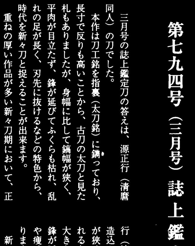

I've attached an example of an image that I've been using as reference from a Juyo Token article.

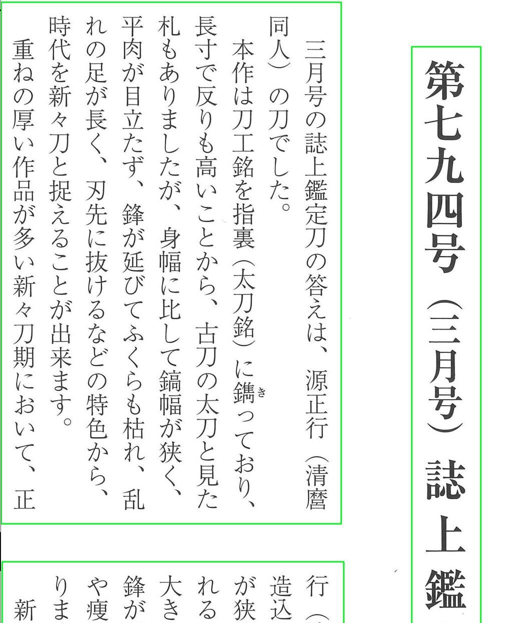

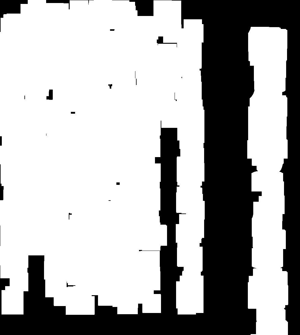

Part of the experimentation, and need for photos is to be able to test the paragraph, text block detection.  As seen below, are the different stages for detecting and grouping blocks of text into paragraphs so that the OCR engine doesn't read across multiple paragraphs turning the output into garbage. The colors are inverted, and then a boundary is drawn around them to see proximity, and then this proximity is used to draw green rectangles which then splits the image up into various sub-images which are then all fed into the engine and the output has been accurate so far provided you have good reference images.

The engine output for the large green rectangle in this test becomes:
三月号の誌上鑑定刀の答えは、源正行(清麻
同人)の刀でした。
本作は刀工銘を指裏(太刀銘)に魚っており、
長寸で反りも高いことから、古刀の太刀と見た
札もありましたが、身幅に比して錦幅が狭く、
平肉が目立たず、外が延びてふくらも枯れ、乱
れの足が長く、刃先に抜けるなどの特色から、
時代を新々刀と捉えることが出来ます。
重ねの厚い作品が多い新々刀期において、正
