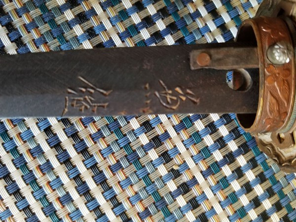

Lookin4answers Posted March 31, 2024 Report Posted March 31, 2024 I was just taking a closer look at some of my swords and decided I would finally try to get some information regarding the information on the tang of one of them. Please see the attached photographs. I tried to make some headway myself, but the complexity of the problem is a bit daunting. I would appreciate any information anyone could provide. I'd also be interested in knowing what the kanji script in white paint says as well. Thank you for your assistance. 1 Quote
ROKUJURO Posted March 31, 2024 Report Posted March 31, 2024 Hunter, the date is probably 1943, the MEI is KANE...something (-TOSHI? -TSUGU?). Your pictures are lying on the side, so I had to break my neck to read the inscription. To help us reading, please post pictures of the NAKAGO - with tip (KISSAKI) pointing upwards -- no hardware on the blade - taken directly from above - with light from the side - well focused - against a dark background to get a good contrast - preferably presented as cut-out so nothing is distracting from the item Quote

John C Posted April 1, 2024 Report Posted April 1, 2024 23 hours ago, Lookin4answers said: any information Hunter: It looks like the painted assembly numbers are 819. Is this number stamped on any of the parts? John C. 1 Quote
Kiipu Posted April 1, 2024 Report Posted April 1, 2024 昭和十八年 1943. 兼継 Kanetsugu. See for example the link below. Translation Request Quote
Kiipu Posted April 1, 2024 Report Posted April 1, 2024 The first white painted character could be the katakana character NE ネ? ネ八一九 = NE 819 Quote
John C Posted April 1, 2024 Report Posted April 1, 2024 42 minutes ago, Kiipu said: NE ネ? I was thinking NU at first, but you are probably right with NE. John C. Quote
SteveM Posted April 1, 2024 Report Posted April 1, 2024 Hard to tell. I was thinking 子 or something along those lines, but if these numbers are generally preceded by katakana characters, then ネ is a possibility. 1 Quote
Lookin4answers Posted April 1, 2024 Author Report Posted April 1, 2024 Thank you all for your time, knowledge and information you provided. Being a complete neophyte leaves my head spinning a bit when I see the depth and breadth of information there is about these swords. 4 hours ago, Bruce Pennington said: I have found that if you crop your photo, even just a little bit, then post it, it’s off the problem. Thank you sir. I'll try that approach on any further picture attachments. 3 hours ago, John C said: Hunter: It looks like the painted assembly numbers are 819. Is this number stamped on any of the parts? John C. I can not find the number 819 on any other part of the sword. 1 hour ago, Kiipu said: 昭和十八年 1943. 兼継 Kanetsugu. See for example the link below. Translation Request Thank you for the translation information. 1 Quote
