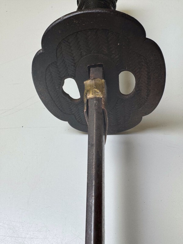

John C Posted March 28, 2024 Report Posted March 28, 2024 Thomas: There should be a metal collar here called a fuchi. Did the tsuka come with one? John C. Quote
WISDOMSEEKER Posted March 28, 2024 Author Report Posted March 28, 2024 Hi John C this is exactly the condition the sword was in when I got it. I'm wondering also if anyone might know what the inscription or etching on the habaki might translate? Quote

WISDOMSEEKER Posted March 28, 2024 Author Report Posted March 28, 2024 15 hours ago, WISDOMSEEKER said: Would anyone have any idea about what this mark would be? It's located on the Habaki? Quote
ROKUJURO Posted March 28, 2024 Report Posted March 28, 2024 Yes, I think it is a craftman's assembly mark, usually not visible under the (now missing) bottom part of the damaged HABAKI. It has nothing to do with the swordsmith nor the owner of the sword. Quote
