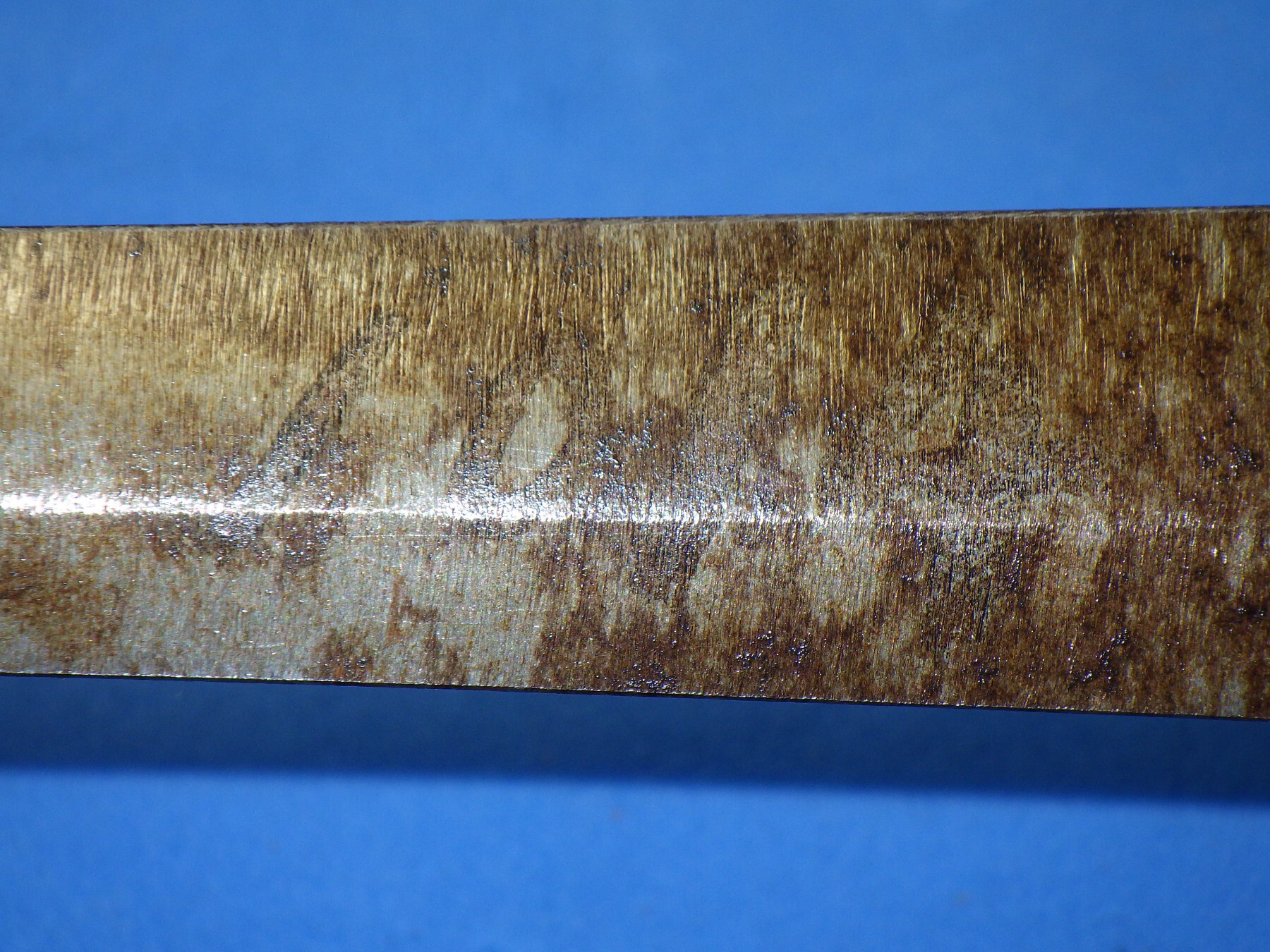

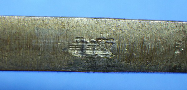

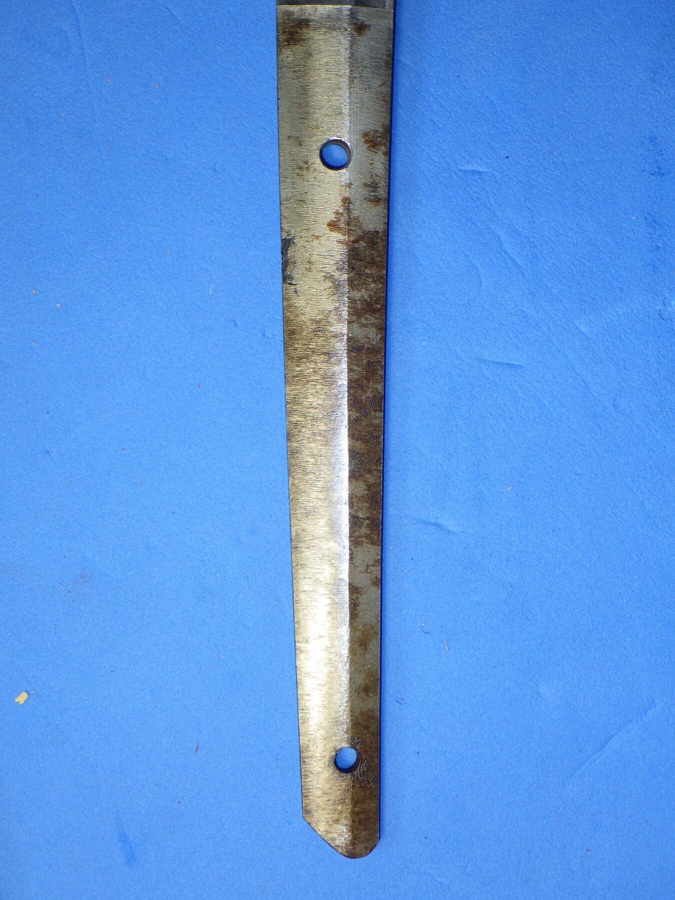

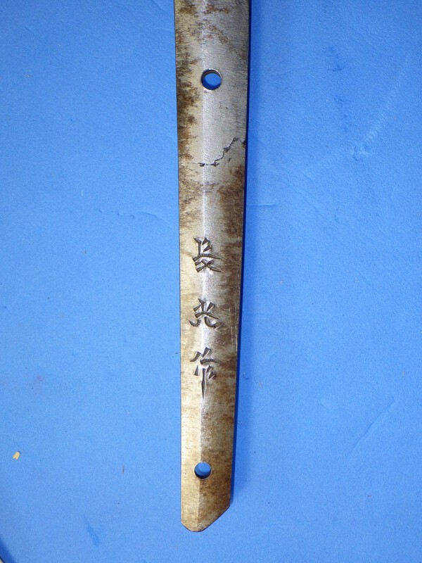

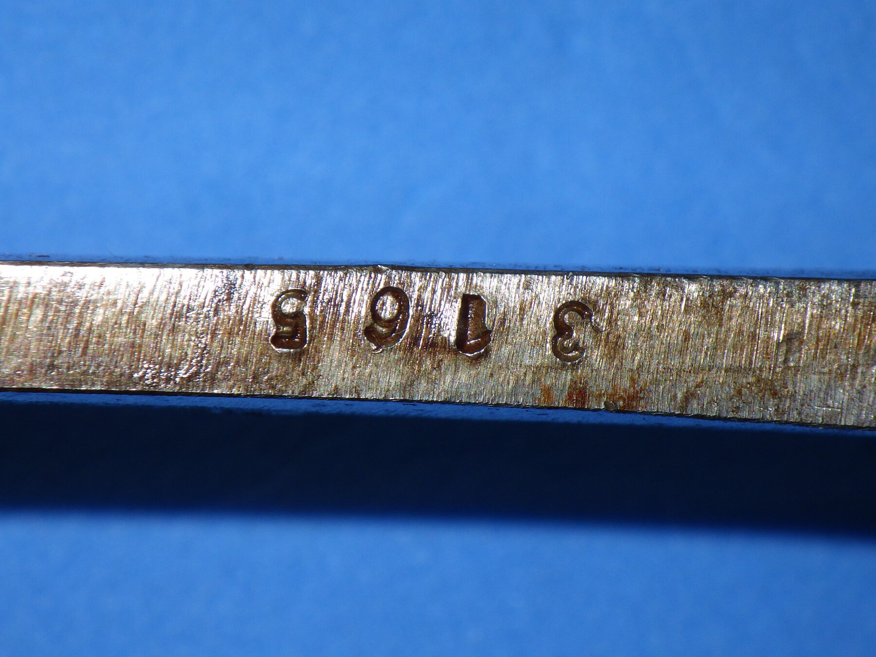

My late father acquired this gunto while serving in the U.S. Army during the Korean War. He was stationed in both Korea and Japan. He went to the PX for cigarettes, saw a pile of these in the back, and asked the guy if he could have one. I removed the handle and found these characters and numbers. Can the year and maker be identified from these?

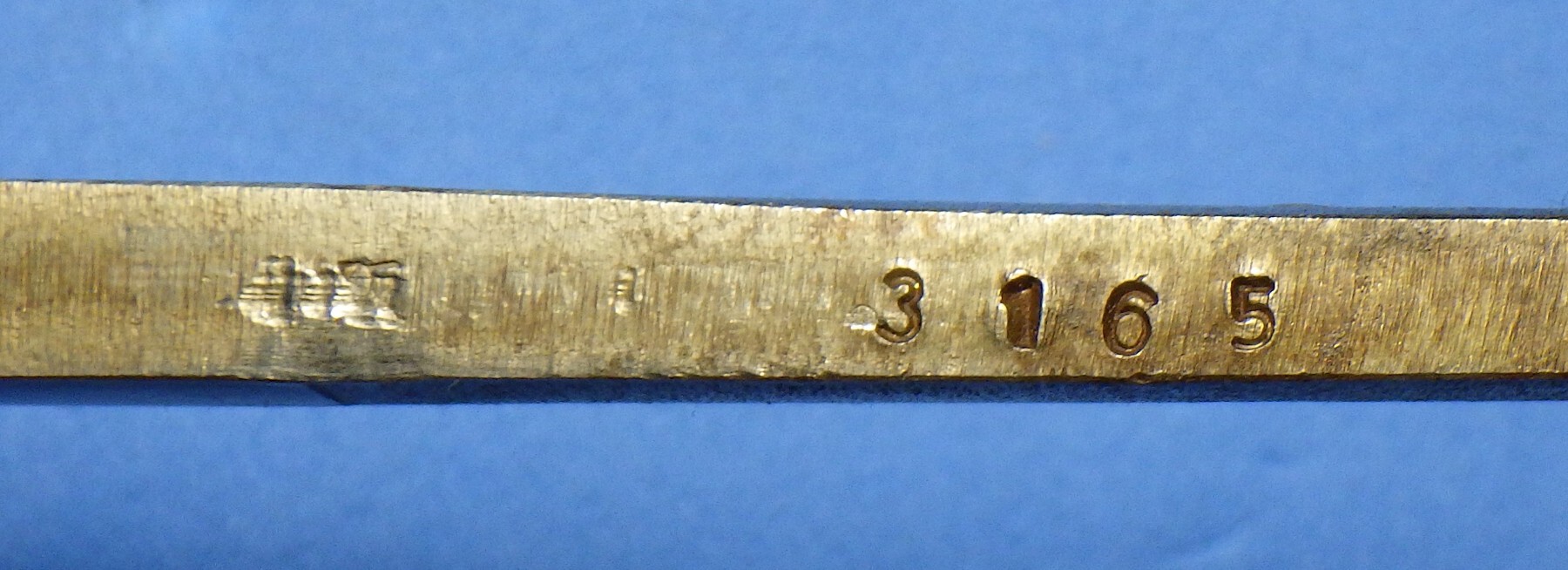

Number stamped

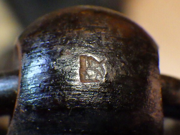

And the faintest Saka stamp just before!
Hello Deborah!
This Nagamitsu (there were a couple of them during the war) made quality blades.  He was qualified by the RJT program and many of his blades were traditionally made.  Can we get full-length photos of the nakago (tang), both sides?  There may be a faint "star" stamp above the name, too.

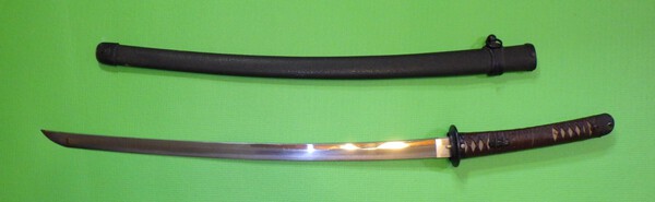

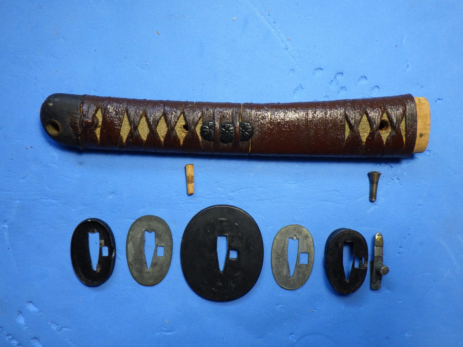

Also, many of us live vicariously through other peoples swords and would love to see the fittings as well.
Thank you all for your feedback. I'll take additional photos next weekend. I can't do it now because I've suddenly been drafted to lead a 4WD camping trip starting Tuesday, so I need to formulate a route and map some coordinates.

I like Nagamitsu RJT, signature looks legit, same with yasurime, thanks for sharing! Looking forward to more photos if possible.
@Bruce Pennington can you point out the faint saka stamp?
Eric,
After cropping and flipping and comparing to another Saka stamp, I may have been premature about that.  If it's a Saka, it's smaller than normal and a bit out of place.  Probably just a random mark.

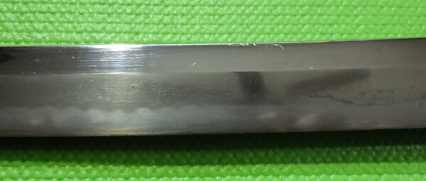

Deborah, looks like a very nice sword. Great pictures. If it were mine I would be proud to own it. You came to the right place for information as this forum is full of great, knowledgeable people always willing to share that knowledge. Thank you for sharing.
  MikeR

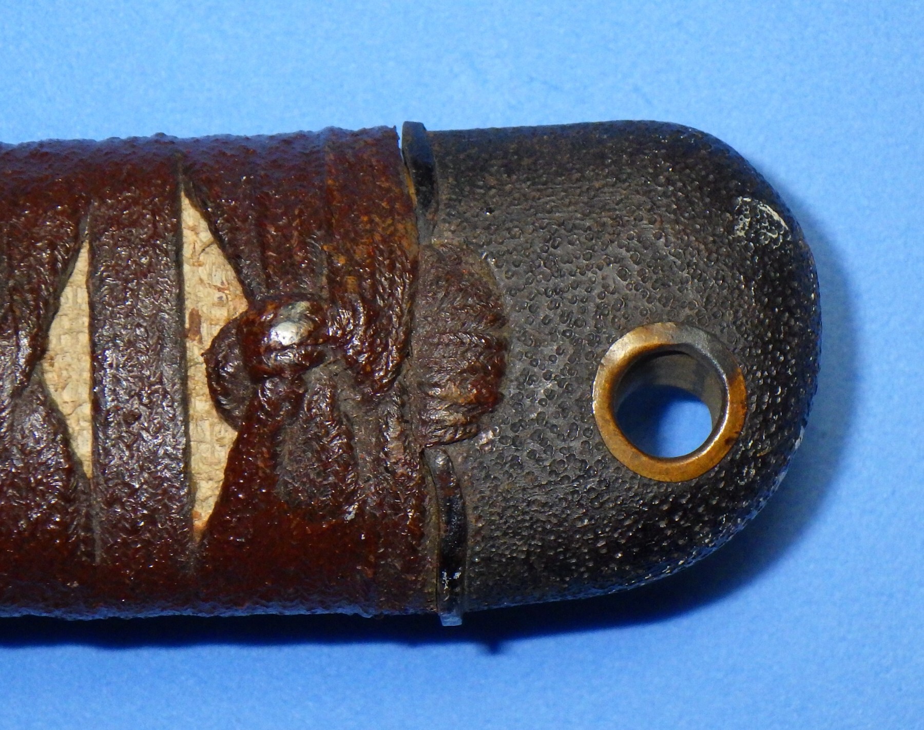

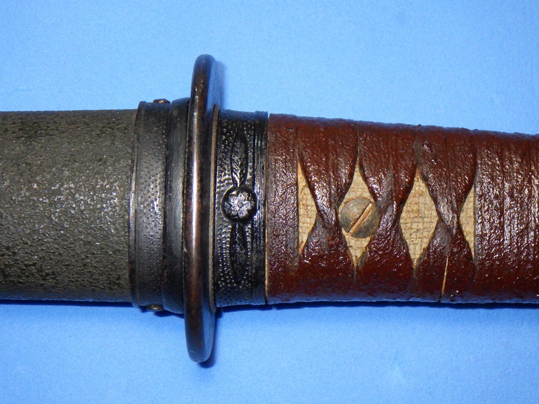

2 hours ago, vajo said:

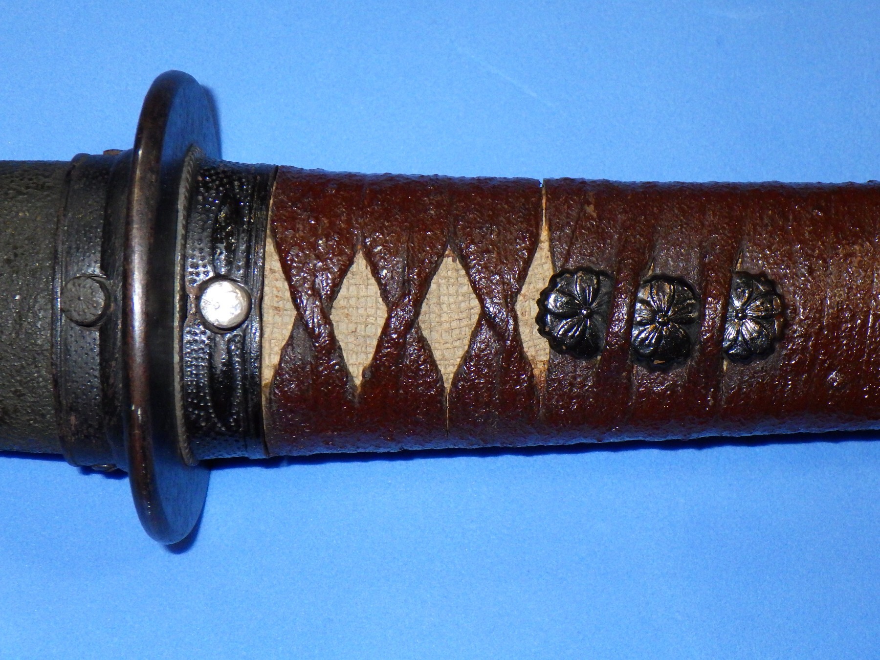

burlap same
Ah. Thanks, Chris. I have the exact same set up on my type 3 gendaito and was wondering what the same' was made out of.
John C.

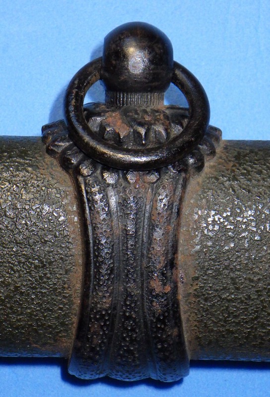

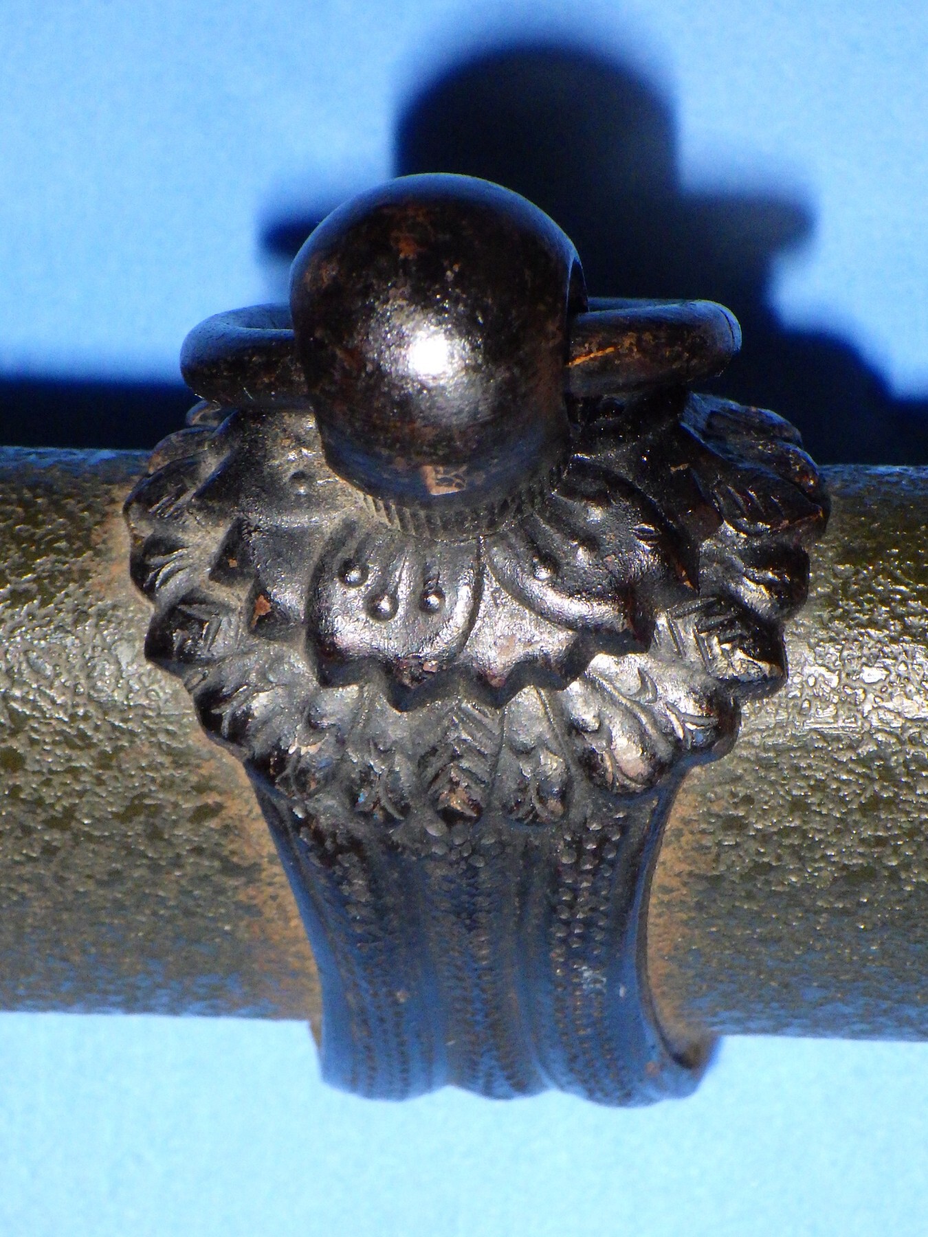

Thanks to @Beater (I hadn't noticed it before), you can see the stamp on the neck of the haikan (belt hangar loop assembly) also!
Deborah,
Each arsenal, both army and navy, had their own quality inspectors who used approval stamps.  The "Saka" stamp is the inspector stamp of the Osaka Army Arsenal.  They are simply approval/acceptance stamps.  You'll find them on other weapons as well.  An intact Saka stamp would look like this:

Wow, I did not notice that little mark! Thank you!
