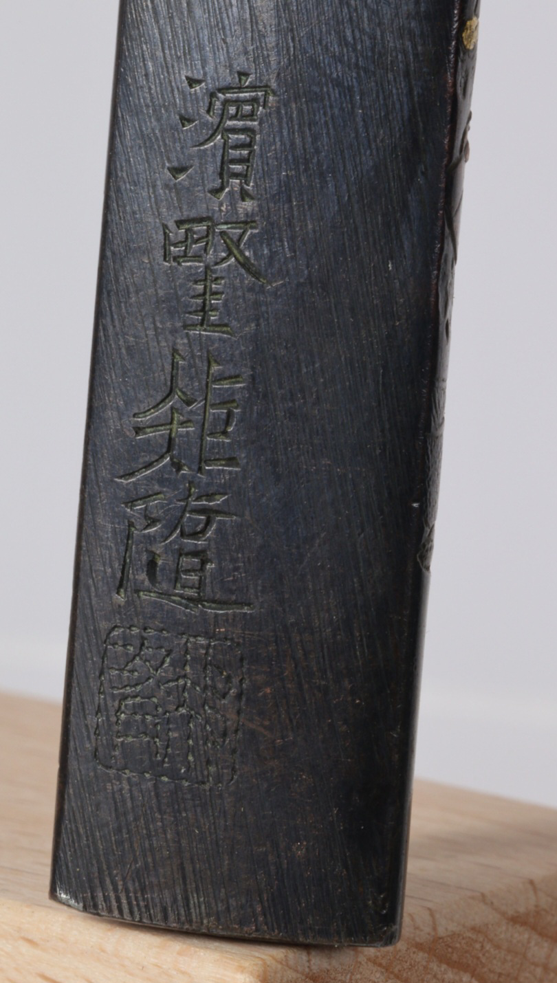

Kurikata Posted March 22, 2024 Report Posted March 22, 2024 Hi, I recognized one Kanji being "NORI" but I cannot find the other ones. Can someone help me ? Thank you Quote
Kurikata Posted March 22, 2024 Author Report Posted March 22, 2024 Thank you Peter! You were fast ! Here it is , I can recognize the kanji as 浜野 矩随 1 Quote
Bruce Pennington Posted March 22, 2024 Report Posted March 22, 2024 Any idea what that square is at the bottom? It's square like a shrine seal. Quote
uwe Posted March 22, 2024 Report Posted March 22, 2024 On 3/22/2024 at 9:38 AM, Kurikata said: Thank you Peter! You were fast ! Here it is , I can recognize the kanji as 浜野 矩随 Expand First two are “濱𡌛”, Bruno! 1 1 Quote
uwe Posted March 22, 2024 Report Posted March 22, 2024 On 3/22/2024 at 1:20 PM, Bruce Pennington said: Any idea what that square is at the bottom? It's square like a shrine seal. Expand A seal, Bruce. You can find it on several works of Noriyuki. Guess it bears his name in seal script…. 1 1 Quote
