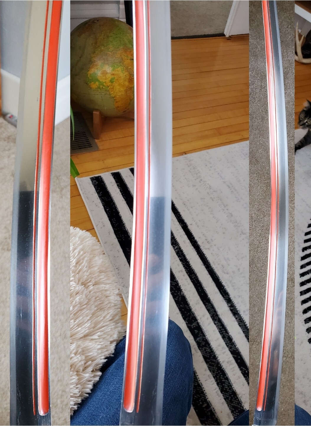

JakeNYC Posted January 19, 2022 Report Posted January 19, 2022 (1830, and with a sword this time) Quote

Bugyotsuji Posted January 22, 2022 Report Posted January 22, 2022 Yes, a very interesting thread here. Jake, part of the problem is the limited number of colors/colours that an ukiyo-e artist works with. Notice that 藍 ai (indigo) blue is used here and there, including to indicate steel on the blades. Not very accurate, but we accept the convention and get the general idea. I suspect that much more can be written about the usages of the various traditional 'reds' in Japan. 小豆 紅花 赤 紅 朱 臙脂 https://en.wikipedia.org/wiki/Traditional_colors_of_Japan There are 98 here: https://irocore.com/category/red/ Quote

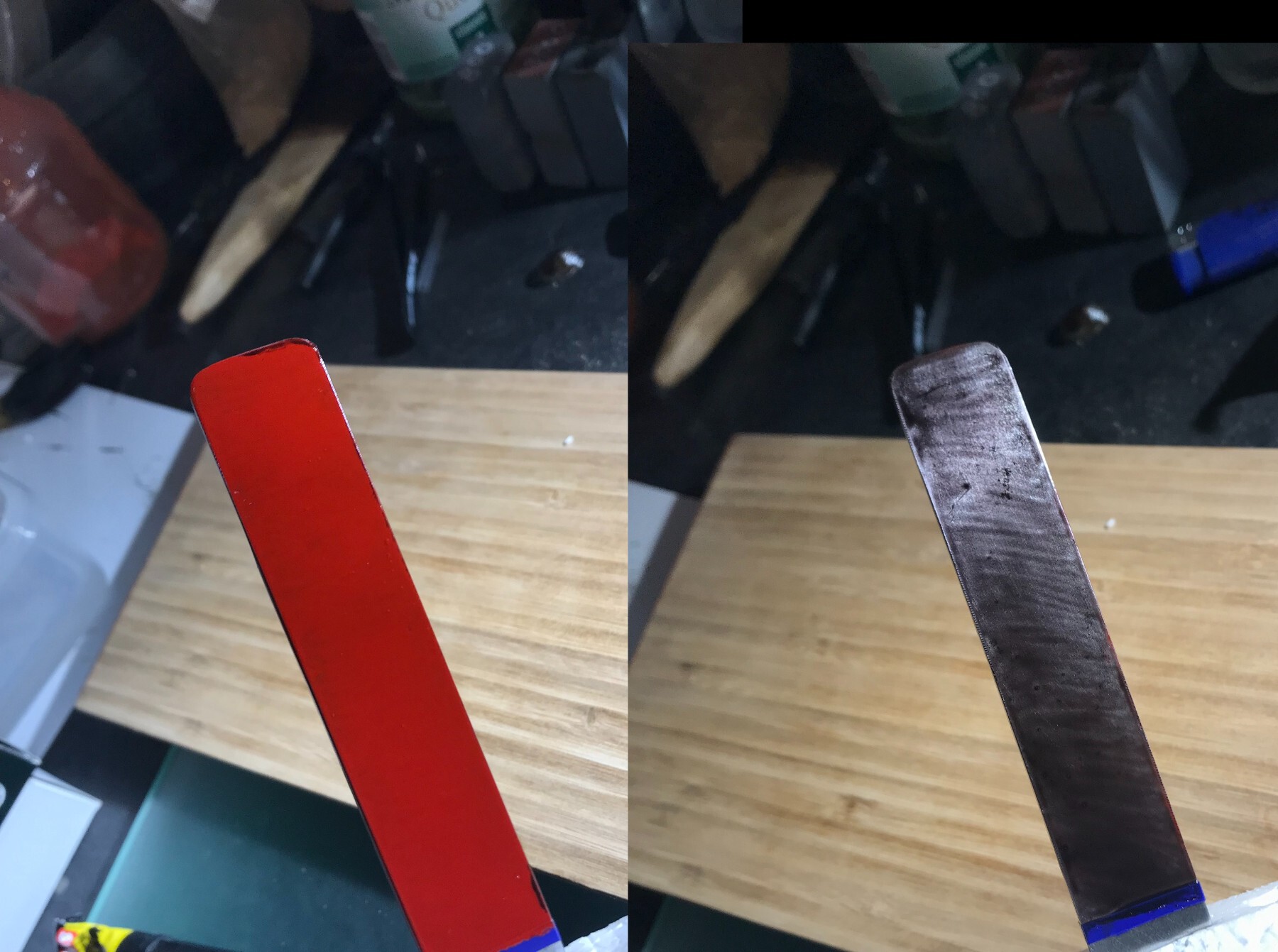

DoTanuki yokai Posted January 29, 2022 Report Posted January 29, 2022 On 12/5/2009 at 10:49 AM, IanB said: Here is a slightly different take. Lacquer is an aqueous medium and hence will not readily adhere to steel which is hydrophobic. When armour is being lacquered the plates have to be heated to a temperature above 100 C. so that it sizzles when applied. This effectively bakes the first bonding coat onto the metal. Presumably the same had to be the case with sword and yari blades. I can imagine many would hesitate waving a blade over a charcoal fire to get it hot enough. Ian Bottomley Mhh im confused, I thought if you heat Urushi over 65celsius it will start to destroy the enzymes that are needed to harden. I have also lacquered many metal surfaces with lead free modern red Urushi and it definitely feels like red has no problems to stick to metal. I have also lacquered the bohi of my Iaito that was polished and the Urushi was easy to apply. Urushi with different colors react different because the color itself interacts with the Urushi. I will try other colors on polished surface to find out what’s going on Quote
DoTanuki yokai Posted January 29, 2022 Report Posted January 29, 2022 I will update the post after polymerization and im fully aware of the uglyness of the black layer and think the answer why they use red could be this easy ? Quote
waljamada Posted January 30, 2022 Report Posted January 30, 2022 Personally, I love them. Have two katana and a Wakizashi with red urushi bohi. The first katana has a darker shade of red while the other two blades have the brighter red in the second katana. Always thought there had to be more to these than just covering a flaw. 2 1 Quote
