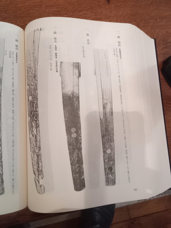

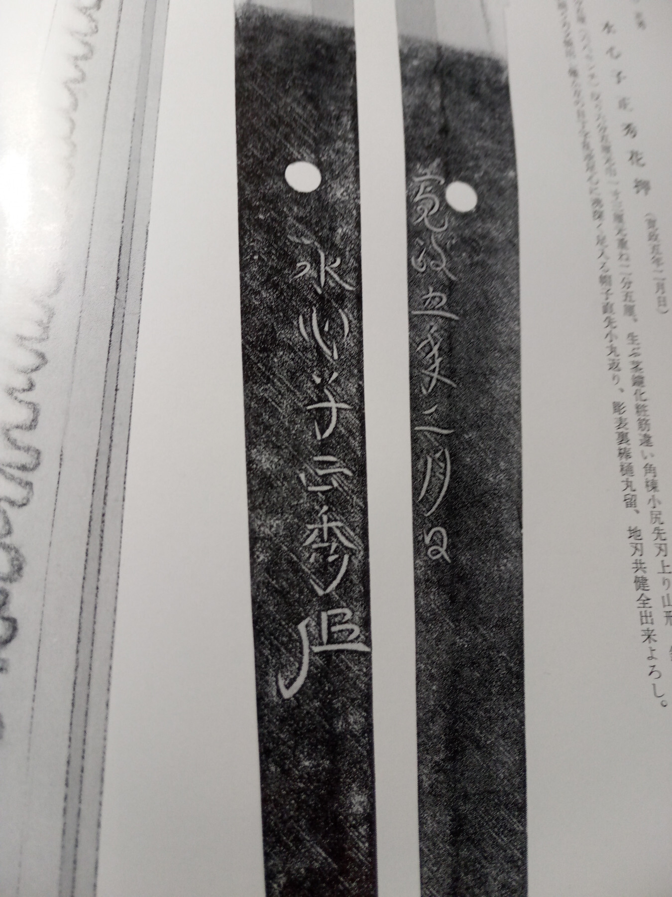

Toryu2020 Posted March 21, 2024 Report Posted March 21, 2024 The first thing to note is the Yasuri-me - they are not clear cut kesho yasuri - Masahide always has a very clean clear finish to his nakago. The SUI kanji is just wrong. The horizontal strokes all have a slight curvature - the shoshin shows strokes that are straight. The spacing of the kanji is off - the KAO should almost be touching the HIDE kanji. There is NO kokuin. The closest thing to correct here are the characters for TSUKI and HI - maybe the faker had some relationship to Masahide? Kajihei perhaps? The horimono is just wrong. 2 2 Quote
Jacques Posted March 21, 2024 Report Posted March 21, 2024 Brian, In Masahide's mei, as in that of other smiths, there are characteristics that are permanent throughout the career, and knowing them helps to determine whether or not the mei in question is authentic, which is where a good library is important. Quote
Jacques Posted March 21, 2024 Report Posted March 21, 2024 8 hours ago, Toryu2020 said: The first thing to note is the Yasuri-me - they are not clear cut kesho yasuri - Masahide always has a very clean clear finish to his nakago. The SUI kanji is just wrong. The horizontal strokes all have a slight curvature - the shoshin shows strokes that are straight. The spacing of the kanji is off - the KAO should almost be touching the HIDE kanji. There is NO kokuin. The closest thing to correct here are the characters for TSUKI and HI - maybe the faker had some relationship to Masahide? Kajihei perhaps? The horimono is just wrong. Hum Quote

Jacques Posted March 23, 2024 Report Posted March 23, 2024 There are two reasons to see that sword is gimei : The first is that the way it's engraved (as shown by the osnigata I've provided) doesn't correspond to the Bunka period. The second is essentially to be found in the Masa kanji, whose base is always engraved in an angular manner, whatever the period. ps some are best ignored 1 Quote

Toryu2020 Posted March 26, 2024 Report Posted March 26, 2024 I would be very surprised to find that the NBTHK had a database of all the swords they have seen - Perhaps all the swords they have papered, and even so I would not think they have them compiled by smith so that you can reference them (oshigata?). I have been to the research room at the old sword museum and it was full of books - the usual books we all have access to, there were not however file cabinets full of oshigata or ledgers from past shinsa - just the usual books. Thats not to say they don't compile oshigata and make them available to the general public, however that is only at the Juyo level - Juyo To-ken Nado Zufu - an excellent reference if you are collecting at that level... -t 1 Quote

Jacques Posted March 26, 2024 Report Posted March 26, 2024 7 hours ago, Toryu2020 said: I would be very surprised to find that the NBTHK had a database of all the swords they have seen - Perhaps all the swords they have papered, and even so I would not think they have them compiled by smith so that you can reference them (oshigata?). I have been to the research room at the old sword museum and it was full of books - the usual books we all have access to, there were not however file cabinets full of oshigata or ledgers from past shinsa - just the usual books. Thats not to say they don't compile oshigata and make them available to the general public, however that is only at the Juyo level - Juyo To-ken Nado Zufu - an excellent reference if you are collecting at that level... -t I don't think you have any idea how much documentation the NBTHK has. I bought this book at the NBTHK museum 1200 pages, nothing but oshigatas and it's only an exemple Quote
