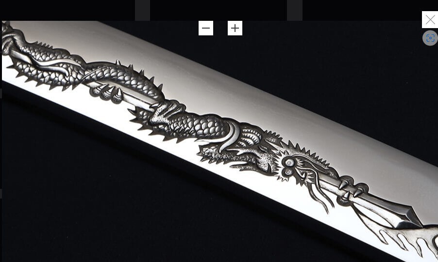

Guest footslime69 Posted March 19, 2024 Report Posted March 19, 2024 10 hours ago, Ray Singer said: As mentioned earlier, there is a lot of information online. If you search and find one with an associated paper then it is likely an authentic example you can study for reference. https://www.google.com/search?q="suishinshi+Masahide"+site%3Aaoijapan.net&rlz=1C1GCEU_enUS954US954&oq="suishinshi+Masahide"+site%3Aaoijapan.net&gs_lcrp=EgZjaHJvbWUyBggAEEUYOdIBCDY4MDNqMGo3qAIAsAIA&sourceid=chrome&ie=UTF-8 I mean close up photos of Masahide’s artist work like the dragons. I’m not sure what time period that photo is from that Brian shared before. It would make sense to compare Masahide’s proven artistry work from the same time period as mine 1806. Quote
Guest footslime69 Posted March 19, 2024 Report Posted March 19, 2024 11 hours ago, Brian said: This is the sort of quality you'd want to be seeing on a high end sword by a good smith. Compare the details closely, especially the scales and undercutting. Not quite sure we are there. But again, just throwing thoughts out. Sword is still a nice piece either way. Though is your example by Masahide from earlier 1800’s? It would make sense to compare an authentic sword made by Masahide from the same time period as mine. Quote
Guest footslime69 Posted March 19, 2024 Report Posted March 19, 2024 12 hours ago, Brian said: Wipe off all the old oil, it is not doing the sword any favors, it wasn't made like that and it is obscuring all the work that needs to be seen, it doesn't add anything to the value. It's wartime grease. Masahide is an important and valuable maker. This wasn't made for the war, but mounted for WW2 later if it's correct. The problem is that Masahide's signature is extremely often faked, we call this gimei and it was done often from hundreds of years ago. So common in fact, that there are likely far more fake signatures than real ones, and they are very well done. You would need to clean off the oil, and submit it to a professional body to have it authenticated. The carving (horimono) on the blade looks only of average quality, and this may lead to a later made wartime sword signed with a famous name. Clean the horimono with isopropyl alcohol and post good pics of it, so we can get an idea if it's the quality to be on a sword made by him. That motif was common on wartime swords too. But until we can see more of the blade etc, it's only educated guesses. The sword is a genuine Japanese sword, the question is whether it's a Masahide or a later sword signed with his name. Thanks so much for all your info Brian. Really appreciate it. I’ve uploaded some more photos of parts of the sword until I can get back to clean the blade and take better photos. Would you know what those small engraved dots on the habaki mean? They were some engraved on the other side as well but I didn’t get photos of that. Thanks again Quote
Guest footslime69 Posted March 19, 2024 Report Posted March 19, 2024 12 hours ago, Brian said: This is the sort of quality you'd want to be seeing on a high end sword by a good smith. Compare the details closely, especially the scales and undercutting. Not quite sure we are there. But again, just throwing thoughts out. Sword is still a nice piece either way. This sword is from 1860. Mine is 1806.. Quote

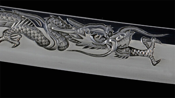

Toryu2020 Posted March 19, 2024 Report Posted March 19, 2024 Footslime - is there something better we should call you? Here is a genuine signature and carving - 1806 and 1807 respectively. Hope this helps… 1 1 Quote
SteveM Posted March 19, 2024 Report Posted March 19, 2024 Hello Footslime Here is another one. Bunka 3 (1806) https://www.touken-s...6/K-masahide-02.html Quote
Guest footslime69 Posted March 19, 2024 Report Posted March 19, 2024 10 minutes ago, Toryu2020 said: Footslime - is there something better we should call you? Here is a genuine signature and carving - 1806 and 1807 respectively. Hope this helps… Haha yeah sorry my name is Matt. Awesome. Thanks so much for these. They look less refined like the ones on my sword. Most swords I have seen online from the early 1800’s look less detailed and refined than more recently made ones. I’m not taking anything away from the earlier swordsmiths, but would I be right in assuming the technology and process of the engraving may have evolved over time? Quote

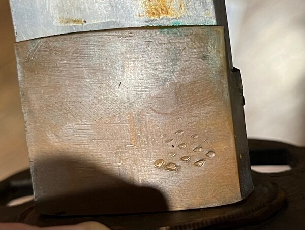

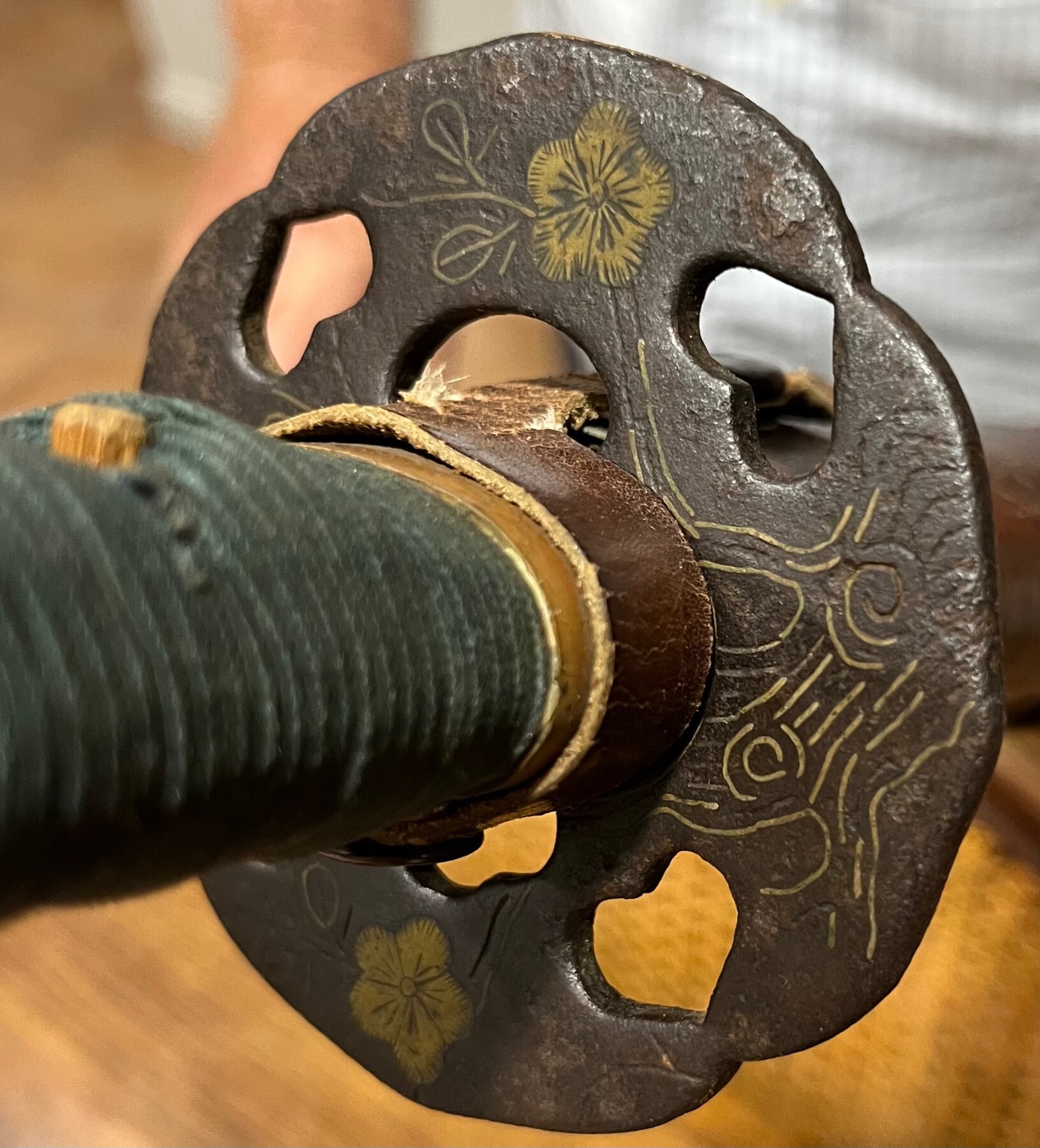

John C Posted March 19, 2024 Report Posted March 19, 2024 1 hour ago, footslime69 said: Would you know what those small engraved dots on the habaki mean? I could be wrong here, however if those same dots are on the other side I would be thinking a vise. I've seen that before on habaki when the blade was stuck. But as I said, I could be wrong and maybe it's just a design that wasn't completed. Another possibility are punches like on a tsuba nakago-ana to tighten it up on the blade. John C. 1 2 Quote
Brian Posted March 19, 2024 Report Posted March 19, 2024 2 hours ago, footslime69 said: Haha yeah sorry my name is Matt. Awesome. Thanks so much for these. They look less refined like the ones on my sword. Most swords I have seen online from the early 1800’s look less detailed and refined than more recently made ones. I’m not taking anything away from the earlier swordsmiths, but would I be right in assuming the technology and process of the engraving may have evolved over time? That would be incorrect. You don't see horimono from good smiths really changing over time. Just didn't happen that way. Also, the ones in the pics shown are by no means cruder, just poorly represented. They are top class work, with fine detail and overlapping scales. Light years above the ones we see on your sword. I can't comment on the mei, but I'd be surprised if that horimono was done by him. Takes viewing lots of good works be to be able to spot the differences. The marks on the habaki are damage, not intentional. Not a big deal. 2 Quote
The Blacksmith Posted March 19, 2024 Report Posted March 19, 2024 The marks on the habaki are, as mentioned by John, certainly vise marks, made by the unprotected jaws of a vise. Possibly, someone has had it in a vise and perhaps hammered the tsuba to free the tsuka at some point. 1 1 Quote
Nobody Posted March 19, 2024 Report Posted March 19, 2024 4 hours ago, footslime69 said: Haha yeah sorry my name is Matt. Awesome. Thanks so much for these. They look less refined like the ones on my sword. Most swords I have seen online from the early 1800’s look less detailed and refined than more recently made ones. I’m not taking anything away from the earlier swordsmiths, but would I be right in assuming the technology and process of the engraving may have evolved over time? This sword was made by Masahide in 1785. It was made 21 years before your Masahide was made. Ref. 刀 銘 水心子正秀 天明五年二月日彫同作/ホームメイト (touken-world.jp) 2 1 2 2 Quote
Guest footslime69 Posted March 19, 2024 Report Posted March 19, 2024 16 minutes ago, Nobody said: This sword was made by Masahide in 1785. It was made 21 years before your Masahide was made. Ref. 刀 銘 水心子正秀 天明五年二月日彫同作/ホームメイト (touken-world.jp) That’s awesome! Thanks for that. Quote

Brian Posted March 19, 2024 Report Posted March 19, 2024 2 hours ago, footslime69 said: Thanks alot Brian, I’ll definitely do that. I’ve just found this one of Masahide’s from 1806. Same year as mine and the design and horimono style looks extremely similar to mine( thick carvings) https://www.bonhams....masahide-dated-1806/ And that one is 100% gimei. Even stated as such. Quote
ROKUJURO Posted March 19, 2024 Report Posted March 19, 2024 Matt, besides the fact that the BONHAMS photo is not very good in magnification, the HORIMONO quality is not comparable. And in addition to the carving work, you have to consider that the HORIMONO changes with every polish! Please sign all posts with at least your first name plus an initial. It is a rule here. You can also show your name in the profile under 'location' instead of 'footslime'. 2 Quote
Brian Posted March 19, 2024 Report Posted March 19, 2024 Quote Please note this sword is after Masahide Which is auction-speak for counterfeit. Quote

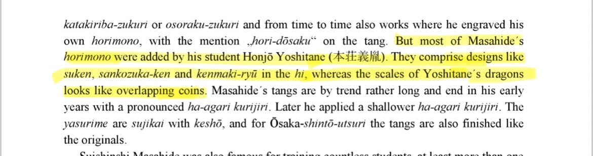

Guest footslime69 Posted March 19, 2024 Report Posted March 19, 2024 (edited) From Markus Sesko’s book Nihon-shinshinto-shi - The History of the shinshinto Era of Japanese Swords. Wouldn’t this mean there’s Masahide horimono on some swords and then others that were done by his student Yoshitane? Edited March 19, 2024 by footslime69 Quote
Brian Posted March 19, 2024 Report Posted March 19, 2024 Again, confirmation that the horimono is not by him or his student. He didn't do it....no hori-dosaku...and not by Yoshitane (No overlapping scales) Matt, you have to accept it at some point. We have all been there, but sometimes it's best to accept the evidence. Show the sword to Andrew, he'll tell you for sure. 2 Quote
