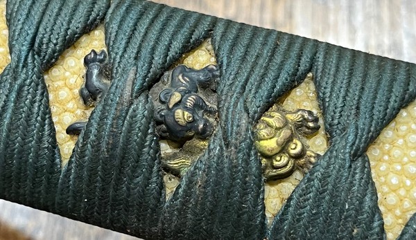

Guest footslime69 Posted March 18, 2024 Report Posted March 18, 2024 Hello, I have an old Suishinshi Masahide samurai sword made in 1806 from WW2. I’m struggling to find info about him online so I was hoping someone here could help me please. Thanks Quote
Ray Singer Posted March 18, 2024 Report Posted March 18, 2024 I'm surprised that you would struggle to find information, he was an extremely famous smith and there is quite a bit of material online and here within this group if you search. You said that your sword was made in 1806 and from World WWII. You are saying that it is in WWII gunto koshirae? https://www.google.com/search?q="suishinshi+Masahide"&oq="suishinshi+Masahide"+&gs_lcrp=EgZjaHJvbWUyBggAEEUYOTIHCAEQABiABDIHCAIQABiABDIICAMQABgWGB4yCAgEEAAYFhgeMggIBRAAGBYYHjIICAYQABgWGB7SAQg2ODM3ajBqN6gCALACAA&client=ms-android-google&sourceid=chrome-mobile&ie=UTF-8#ip=1 Quote

Guest footslime69 Posted March 18, 2024 Report Posted March 18, 2024 9 minutes ago, Ray Singer said: Your translation is correct. Suishinshi masahide (KAO) Bunka san nen hachi gatsu hi (a day in the eighth month of 1806). Yes that’s correct. Are you able to tell me anything about this one? I’ve uploaded some photos for you. Cheers mate Quote
Ray Singer Posted March 18, 2024 Report Posted March 18, 2024 From what I can see this is a traditional bukezukuri koshirae (mounting) which was adapted to be carried into World War II. I would suggest shinsa if you would like to validate the inscription. 1 Quote

Guest footslime69 Posted March 18, 2024 Report Posted March 18, 2024 14 minutes ago, Ray Singer said: From what I can see this is a traditional bukezukuri koshirae (mounting) which was adapted to be carried into World War II. I would suggest shinsa if you would like to validate the inscription. Do you know is these swords were considered to be good swords? And were they only used for WW2? I read somewhere Masahide wasn’t known for his artistry but more for the functionality of the sword, is this true? Quote
Brian Posted March 18, 2024 Report Posted March 18, 2024 Wipe off all the old oil, it is not doing the sword any favors, it wasn't made like that and it is obscuring all the work that needs to be seen, it doesn't add anything to the value. It's wartime grease. Masahide is an important and valuable maker. This wasn't made for the war, but mounted for WW2 later if it's correct. The problem is that Masahide's signature is extremely often faked, we call this gimei and it was done often from hundreds of years ago. So common in fact, that there are likely far more fake signatures than real ones, and they are very well done. You would need to clean off the oil, and submit it to a professional body to have it authenticated. The carving (horimono) on the blade looks only of average quality, and this may lead to a later made wartime sword signed with a famous name. Clean the horimono with isopropyl alcohol and post good pics of it, so we can get an idea if it's the quality to be on a sword made by him. That motif was common on wartime swords too. But until we can see more of the blade etc, it's only educated guesses. The sword is a genuine Japanese sword, the question is whether it's a Masahide or a later sword signed with his name. 1 Quote

The Blacksmith Posted March 18, 2024 Report Posted March 18, 2024 it is not a fake sword, just the signature was often faked to get a better price from unsuspection buyers. As has been said Masahide was a rather famous and important smith, so his signature was often faked, and this is called gimei. It may still be an extremely nice blade! 1 Quote
DoTanuki yokai Posted March 18, 2024 Report Posted March 18, 2024 When Masahide made functional swords that is the highest art after form follows function. Just in case it wasnt mentioned don’t clean the Nakago (tang) of the blade. 1 Quote
Brian Posted March 18, 2024 Report Posted March 18, 2024 Fake signatures exist in the hundreds of thousands. The swords are genuine swords, just not made by the person on the tang. It's something you get used to when you study Nihonto. Not saying it is or isn't, but it was common and not seen as a "fake" sword, it was a tradition that was often accepted. Swords with big names and no papers are best considered gimei (false signature) until proven otherwise. Would not be in the least bit unusual for a Japanese officer to carry a nice sword with a false signature. But let's see more of it and we all hold thumbs it's ok. 3 Quote

Brian Posted March 18, 2024 Report Posted March 18, 2024 This is the sort of quality you'd want to be seeing on a high end sword by a good smith. Compare the details closely, especially the scales and undercutting. Not quite sure we are there. But again, just throwing thoughts out. Sword is still a nice piece either way. 3 Quote
Guest footslime69 Posted March 18, 2024 Report Posted March 18, 2024 15 minutes ago, Brian said: This is the sort of quality you'd want to be seeing on a high end sword by a good smith. Compare the details closely, especially the scales and undercutting. Not quite sure we are there. But again, just throwing thoughts out. Sword is still a nice piece either way. Would you have any photos of his authentic work from the 1800’s by any chance? My cousin told me he was signing his work with a different signature in 1805 by adding a made up letter to the end. He would oftenly do this apparently. Quote

Paz Posted March 18, 2024 Report Posted March 18, 2024 As Oliver mentioned seskos book Nihon shinshinto shi has great much info. Generally masahide is seen as the originator of the shinshinto era of sword making. His famous students such as chousai tsunatoshi and tsunahide worked with hamons such as toranba. Masahide believed that shinto period swords were inferior to koto (old) swords, and tried to imitate swords from koto periods. (Am I right ) I think he even tested a bunch of swords and recorded the ones that broke. But yes he's a big name. Regards Quote

Rivkin Posted March 18, 2024 Report Posted March 18, 2024 Don't know about the signature but horimono looks too crude. One can try using one of NTHK shinsa in the US or have someone submit it to NBTHK in Japan. 1 Quote
