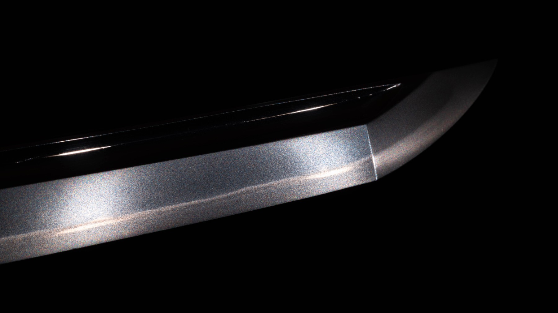

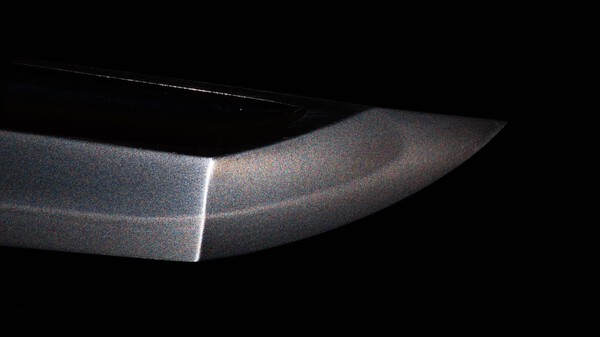

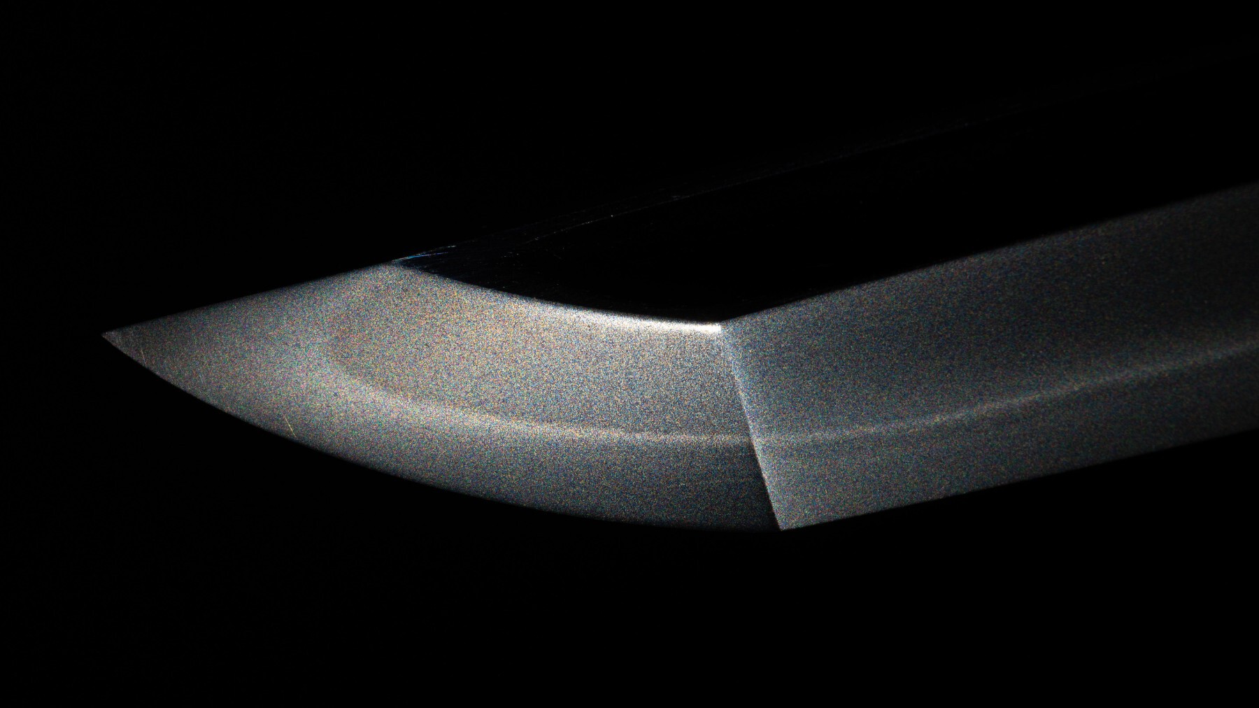

Above all, it requires the right equipment for photography and PATIENCE
Maybe some will not agree with me, but forget about the camera in your mobile phone
You shoot in "bad" lighting conditions (longer shutter speed), you need to capture very fine details (low ISO)
I recommend a dark room to minimize reflexion from the surroundings
What you need: a tripod, a camera with full manual control (focusing, ISO setting, aperture, shutter speed, white balance ...), ideally a high-quality macro lens of at least 70mm (I use 180mm), a remote shutter release is a good aid against camera shake
For photographing from the top, I use two flat LED light sources (left and right) if I want to photograph the blade without reflection
( I couldn't find a way to insert photos between the text, so the photos will be at the end )
However, you can also use a spot light and even by slightly changing the position of the light (its reflection from the surface of the blade) you will achieve different photo results
Different light sources (LED, halogen, classic light bulb, warm LED, cold LED...) achieve different results
Likewise, the distance of the light source from the blade changes the result of the photo
So experiment and what suits you best
Several spotlights for shooting at an angle
The same applies to choosing a light source as I wrote above (type of light, light temperature, distance from the blade...)
And then achieving the "correct position" of the blade is sometimes a difficult task
You have two options: move the lights and camera, or the blade
Sometimes a change of position of only a few millimeters is necessary to achieve the correct reflection of the martensitic structures
The hardest part is taking the first few good photos
Then you will only get better
But it requires PATIENCE

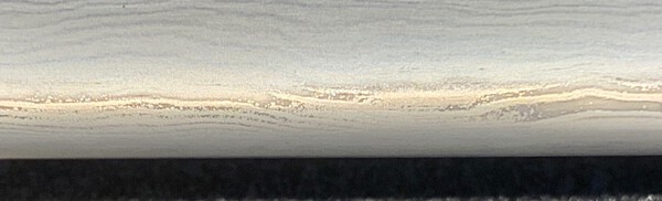

Depends so much on the lighting. I took these on a quite old iPhone XS Max using just daylight.
Tap the images to get a better look. Not sure how you would improve on them

That looks like shinshinto. For whatever reason Suishinshi Masahide rendered Hosho style in this way with drastically different steel layers and everyone else in shinshinto seemed to follow. It reacts well to white light (directly from above), reacts well to sidelight, its relatively insensitive to all conditions.
Challenges begin when its Kamakura, complex utsuri, nioi based hamon with plenty of ashi.
