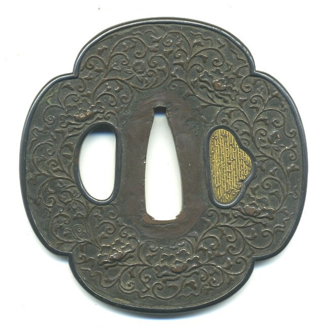

Dan tsuba Posted March 14, 2024 Report Posted March 14, 2024 I just received this (what I consider). a beautiful sanmai tsuba! Purchased from Japan for $63.00 U.S. (which included shipping!). It makes a great addition to the collection! Just wanted to share! Show me yours, and let's have some fun! With respect, Dan 3 Quote

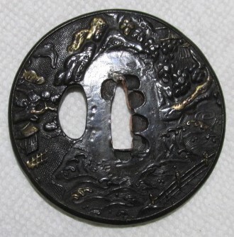

Dan tsuba Posted March 15, 2024 Author Report Posted March 15, 2024 Another one of my sanmai tsuba. Bridge, water, and mountain scene. Onward! With respect, Dan 1 Quote

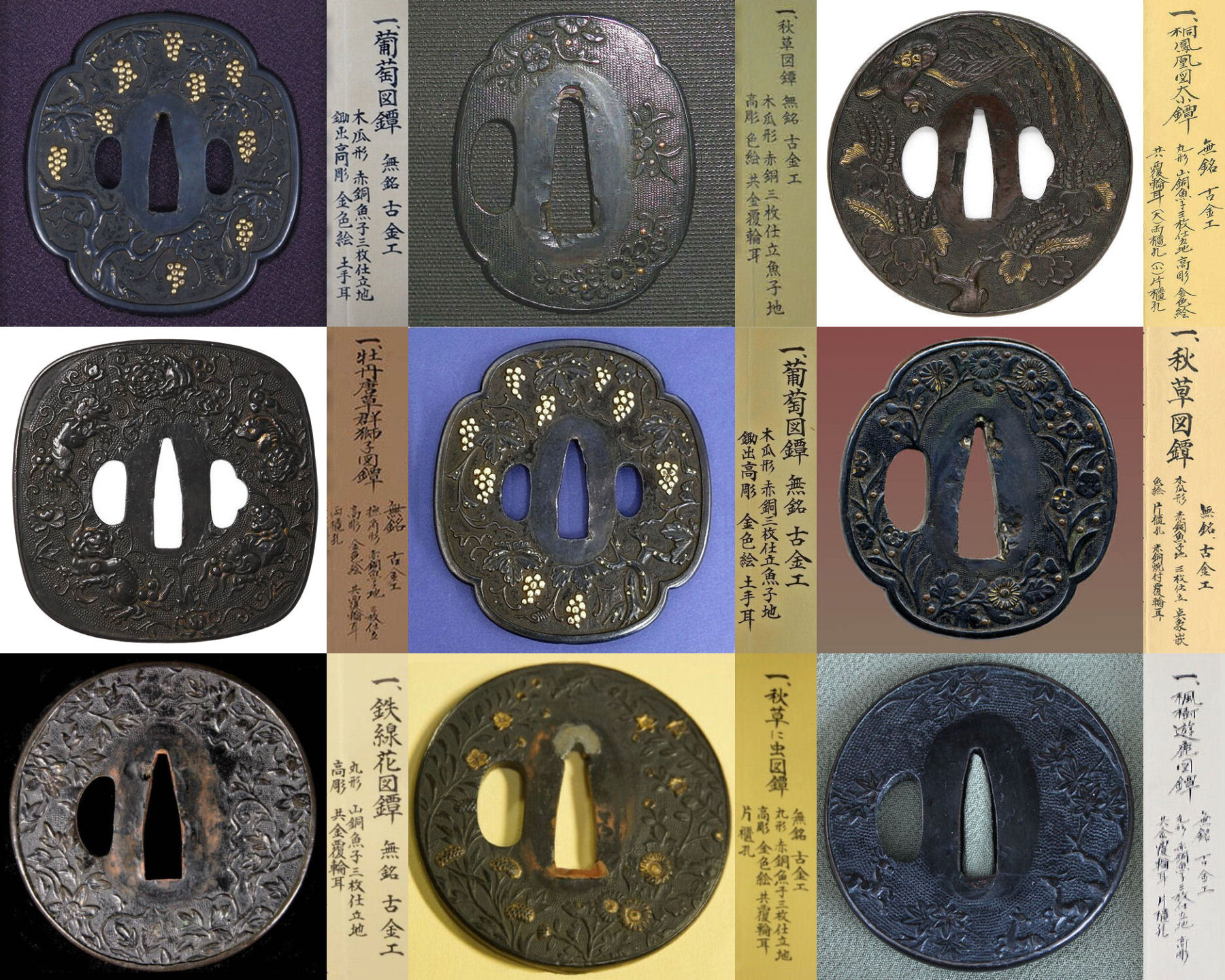

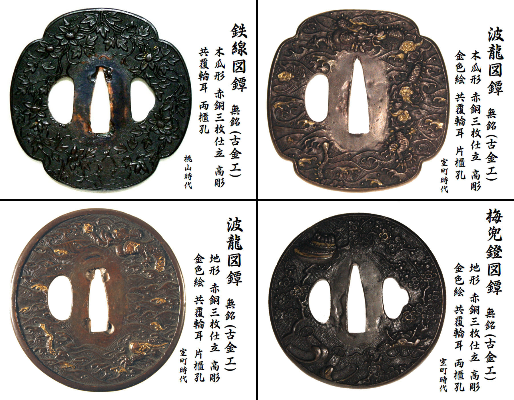

MauroP Posted March 16, 2024 Report Posted March 16, 2024 I like sanmai tsuba, and I've just realized I got more than I remember. Here below some more examples papered as ko-kinkō: 5 2 Quote

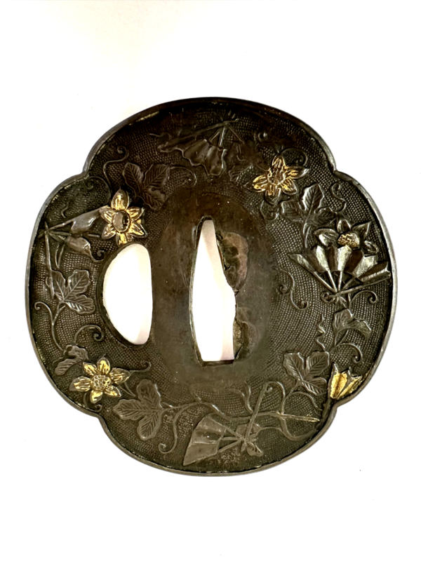

Rodenbacher Posted March 17, 2024 Report Posted March 17, 2024 An unaltered Muromachi or Momoyama period San Mai Tsuba. 5 Quote
Soshin Posted March 22, 2024 Report Posted March 22, 2024 Here is an early one I think, I have submitted for NBTHK shinsa this year. The surface has a nice layer of black lacquer applied to it. The design is a plain textured surface with copper and lead inlays. The plate construction is made up of three layers with rim clover holding everything together very tightly. 7 2 Quote
Iekatsu Posted March 23, 2024 Report Posted March 23, 2024 For the last two, do you have an images from an angle showing the plates in the Nakago or Hitsu-ana? Quote
Soshin Posted March 23, 2024 Report Posted March 23, 2024 4 hours ago, Iekatsu said: For the last two, do you have an images from an angle showing the plates in the Nakago or Hitsu-ana? Unfortunately, I don't have the tsuba in hand or I would try to provide photos of inside surfaces of the nakago and hitsu-ana. I remember seeing a distinct three-layer construction to the plate. The texture you see was applied to the surface of both thinner outer most plates. All three plates (the two thinner outer and one thicker inner plate) are I think held together by the rim cover. An interesting design to what I think is an older pre–Edo Period soft metal tsuba. Quote

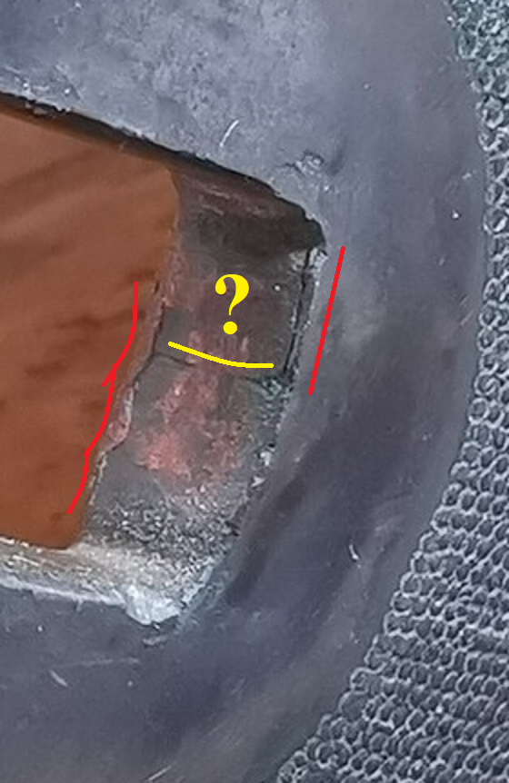

Rodenbacher Posted March 23, 2024 Report Posted March 23, 2024 It's a bit difficult to see the three layer construction here, I guess 4 Quote
Spartancrest Posted March 24, 2024 Report Posted March 24, 2024 Thick core with thin sheets. What is the line at the bottom of the nakago-ana? 1 1 Quote
Rodenbacher Posted March 24, 2024 Report Posted March 24, 2024 8 hours ago, Spartancrest said: Thick core with thin sheets. What is the line at the bottom of the nakago-ana? Honestly, I don't know... 1 Quote
Iekatsu Posted March 24, 2024 Report Posted March 24, 2024 Hello Peter, thanks for the additional photos. As I suspected, I don't think your Tsuba or David's Tsuba are San-mai, both are nice Ko-kinko Tsuba though. The area you have highlighted at the back of the Nakago-ana appears to just be minor delamination. 1 1 Quote
Ron M Posted March 24, 2024 Report Posted March 24, 2024 Here are my only two sanmai tsuba. Thanks for the thread to see others 2 Quote
Rodenbacher Posted March 25, 2024 Report Posted March 25, 2024 12 hours ago, Iekatsu said: Hello Peter, thanks for the additional photos. As I suspected, I don't think your Tsuba or David's Tsuba are San-mai, both are nice Ko-kinko Tsuba though. The area you have highlighted at the back of the Nakago-ana appears to just be minor delamination. The more I study this Tsuba the more I think you are right... Quote
Kurikata Posted October 27, 2024 Report Posted October 27, 2024 Another one in my collection I had forgottten... 2 1 Quote
ROKUJURO Posted October 27, 2024 Report Posted October 27, 2024 On 3/24/2024 at 10:43 PM, Iekatsu said: .......The area you have highlighted at the back of the Nakago-ana appears to just be minor delamination. There are no laminations in soft-metal. The core is always cast. 2 Quote
Iekatsu Posted October 28, 2024 Report Posted October 28, 2024 You are correct, flaking material might be a better description. It can happen when force is applied. Quote
ROKUJURO Posted October 28, 2024 Report Posted October 28, 2024 Thomas, could you show an example of it? Quote
Iekatsu Posted October 29, 2024 Report Posted October 29, 2024 No problem, you will have to excuse the poor photography, I do not have a macro lens. All of these are Ko-kinko, none of them are San-mai in construction. 3 Quote
