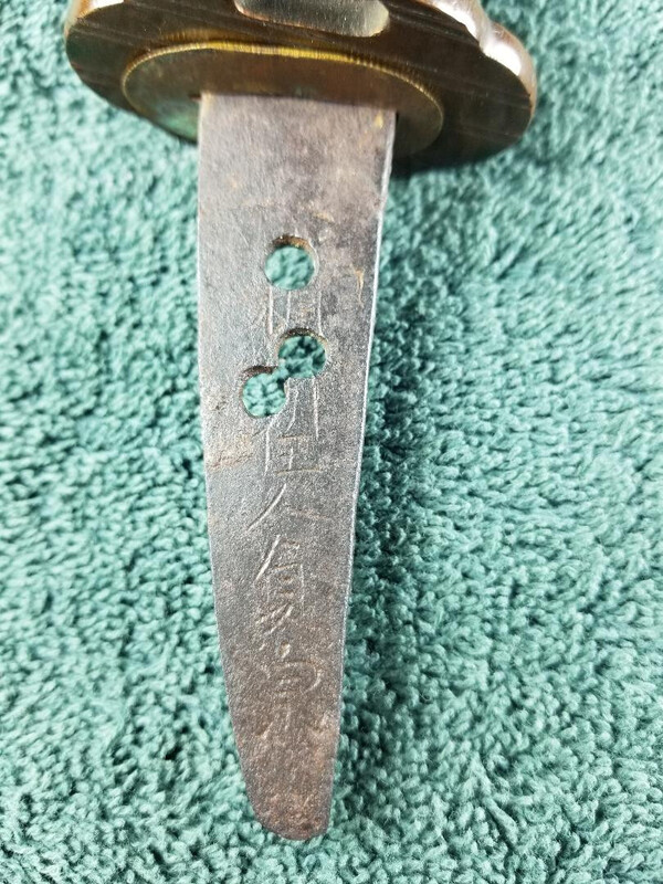

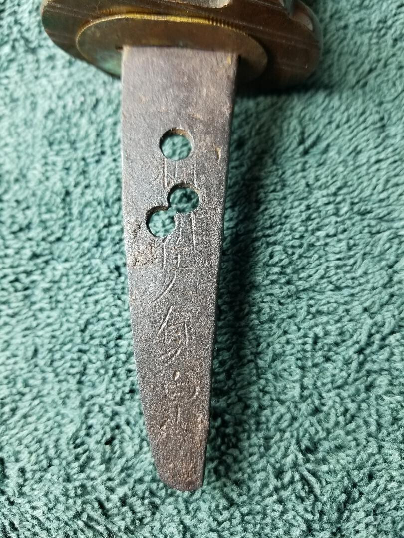

The dealer provided a translation of the mei but not the inscription on the reverse side of the tanto's tang, nor did they translate the inscription on the kozuka.  Can anyone hazard an interpretation from the these pictures?  I can provide further if these prove to be inadequate.
Thanks in advance for any assistance.

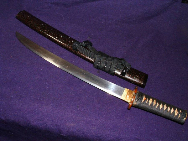

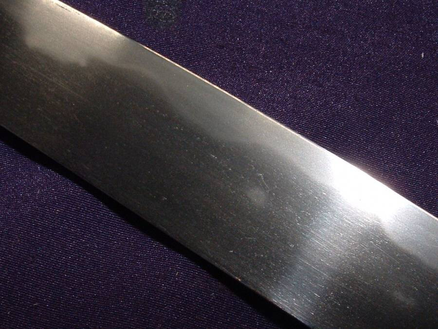

Thank you for the assistance and I will try to put up some better pictures of the inscriptions on my tanto per Rokujuro's instructions.  One of my katanas has the same tsuba as the one pictured in "Nobody's" signature.  Here are a few general pics in the meantime.

Here are some additional pictures of the reverse side tang inscriptions.  Can anyone make them out from these pictures?  Happy to retake with different lighting/background if that will help.  I have also included a few of the obverse side inscriptions, which I am told translate to "Soshu junin Sadamune."

相州住人貞宗
Sō-Shū Jūnin Sadamune.
On the other side of the Nakago
“A day in February in the second year of…” (someone has obliterated the date name with mekugi holes. Might be possible to piece it together with a bit of circumstantial detective work.)
