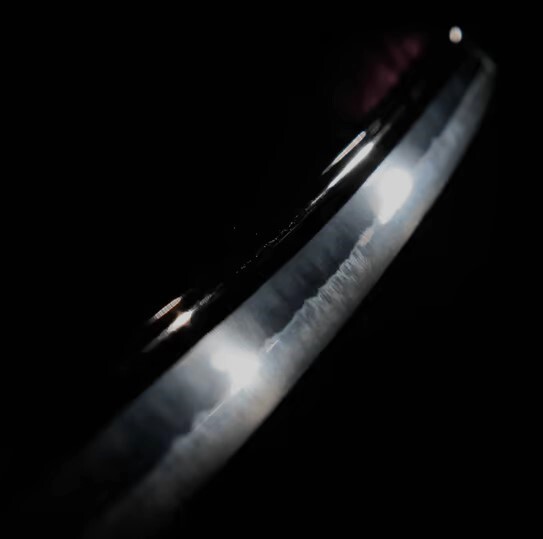

Can anyone recommend a book (or website) about utsuri? Ideal would be a discussion about the different types, with examples, and something about the metallurgy.
Bizen style utsuri. Osafune Kagemitsu tachi.
Photo by Darcy Brockbank. Copyright Darcy Brockbank estate.
