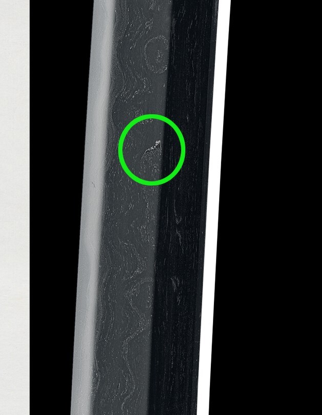

KyleH Posted March 10, 2024 Report Posted March 10, 2024 Hi, I am new to the boards and fairly new to Nihonto collecting. There is a sword I am considering purchasing that has a few Kizu on it. It has Hozon paperwork, but I wanted to know some thoughts on the Kizu and whether they would be considered to be serious flaws or not. The blade itself is a mid Muromachi period Katana. I would appreciate any thoughts and insights. Quote
Katsujinken Posted March 10, 2024 Report Posted March 10, 2024 I thought that looked like Gassan work. :-P It's not a bad package for 600,000 JPY (especially with the weak yen). The kizu are about what I would expect for a blade of this age at that price point from Aoi Art. Seems like a good example of the school's work. You could certainly do a lot worse. 1 Quote
John C Posted March 10, 2024 Report Posted March 10, 2024 Kyle: Not sure if you have this already, but this page lists which flaws are fatal and which are normal. http://www.japaneseswordindex.com/kizu.htm John C. Quote
Rivkin Posted March 10, 2024 Report Posted March 10, 2024 Only the first is an issue. Expected for rough Gassan. There are fine example ofcoarse, but this one is average. Putting a link to seller's page would save us time. Quote
Katsujinken Posted March 10, 2024 Report Posted March 10, 2024 On 3/10/2024 at 8:40 PM, Rivkin said: Only the first is an issue. Expected for rough Gassan. There are fine example ofcoarse, but this one is average. Putting a link to seller's page would save us time. Expand It’s Aoi. You can tell from the photos. https://www.aoijapan.com/katana:mumeigassannbthk-hozon-token/ Quote
Ooitame Posted March 11, 2024 Report Posted March 11, 2024 Not a bad piece, look up kizu and/vs ware, this looks more like ware from time and polish. Hard to tell via photo, first pic and last pic inorder look like loose nice nie maybe well... down the road some handa, nothing a Togishi can not handle. Second looks to be nie exposed by polish. A nice blade. Quote
KyleH Posted March 11, 2024 Author Report Posted March 11, 2024 Thanks everyone. It is Aoi. Sorry for not putting a link to the auction, I thought the photos with the areas circled would be easier. I appreciate the feedback and I will definitely go to those sites listed with more information on kizu vs ware. Quote
DoTanuki yokai Posted March 11, 2024 Report Posted March 11, 2024 On 3/11/2024 at 12:07 AM, Ooitame said: Not a bad piece, look up kizu and/vs ware, this looks more like ware from time and polish. Expand Just want to clarify that because it sounds a little misleading. Time does not open layers if the blade has ware it has it from the time when It was forged, maybe it is hidden underneath flawless layers but when it shows up after polish it was there from the beginning. 1 Quote
Ooitame Posted March 11, 2024 Report Posted March 11, 2024 @DoTanuki yokai, thanks was trying to keep it high level. Quote
