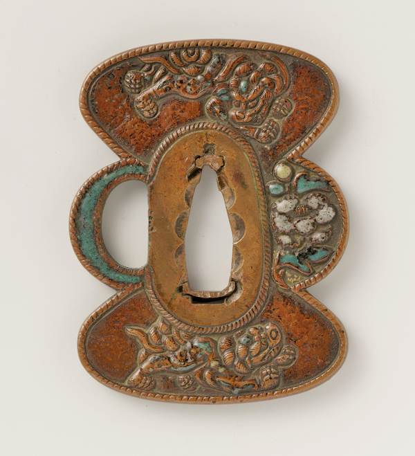

Hannah Posted March 5, 2024 Author Report Posted March 5, 2024 On 3/5/2024 at 2:30 PM, Brian said: Files fit fine. Any of them. Google free image resizers, takes a minute to resize down to a reasonable size Expand If I have them on my desktop, how can I do that? I want to make this as accessible as possible so that the photos are seen on the post. Thanks Quote
Hannah Posted March 5, 2024 Author Report Posted March 5, 2024 On 3/5/2024 at 2:40 PM, Bugyotsuji said: We have to ask you Hannah, what kind of camera were you using? Those are some of the fuzziest, strangely colo(u)red photos I have seen. Expand The ones with the red background were taken about 10 years ago by a previous group that did this tsuba, the others by an iPad. The reason they look bad is due to the 3D camera we had to use. Still trying to find the lost images, those were taken with the normal camera. Quote
Hannah Posted March 5, 2024 Author Report Posted March 5, 2024 Finally figured it out. Here are the pictures with a decent resolution. H. 1 Quote
DoTanuki yokai Posted March 5, 2024 Report Posted March 5, 2024 I think i see some gaps inside the Hitsuana and Nakagoana that could be signs of a multi layer construction or shadows of the overflowing cloisonne. I dont think it looks fire damaged with the new pictures but more like an early work but i really don`t know much about cloisonne. Here a picture that show the lines that could show the layers. (some of the new pictures show it better i think) 1 1 Quote

Infinite_Wisdumb Posted March 6, 2024 Report Posted March 6, 2024 Pretty clearly looks like a tourist iron Cloisonne piece to me. That has had the cloisonne ruined. Quote

Brian Posted March 6, 2024 Report Posted March 6, 2024 Much better. Shape of the nakago ana is also a lot better than the previous pics and is closer to what a tsuba should be. Still an odd shape though, would have to be modified to fit a blade. I think we can be certain this wasn't any Shogunate piece. I'm still in the "made for the Dutch trade" camp here. Something flashy with cloissone for the Western market, maybe anywhere from 1600's to 1800's. 2 Quote
Spartancrest Posted March 6, 2024 Report Posted March 6, 2024 On 3/6/2024 at 6:30 AM, Brian said: "made for the Dutch trade" Expand And a few have ended up in a Dutch museum - so no surprises there! Personally I like this little cloisonné from the same museum https://www.rijksmus...llection/AK-MAK-1118 3 1 Quote
Hannah Posted March 6, 2024 Author Report Posted March 6, 2024 On 3/6/2024 at 3:38 AM, Spartancrest said: the Rijksmuseum in Amsterdam Expand If it had been in this museum, how would it have gotten out? Did the museum sell objects to people or might it have got lost? H. Quote
Matsunoki Posted March 6, 2024 Report Posted March 6, 2024 Museum closes. Stuff gets de-accessioned. Stolen. Sometimes private museums sell stuff to raise funds. My feeling is that it is old though judging by the enamel colours and pitting and definite nod towards Chinese Ming cloisonné 1 Quote
Spartancrest Posted March 6, 2024 Report Posted March 6, 2024 On 3/6/2024 at 9:31 AM, Hannah said: Did the museum sell objects to people or might it have got lost? Expand There is a downloadable book here on the sale of "excess" tsuba from the Metropolitan Art Museum. Yes some museums do sell some [ or even all ] of their collections. There is even one odd case of the Wolverhampton Museum being forced to give back a donated collection of tsuba which was then put up for private auction only to be bought in its entirety and donated back to the same museum [1924]. Tsuba can do a lot of moving about. 2 2 Quote

Spartancrest Posted March 8, 2024 Report Posted March 8, 2024 Some extra data from a Japanese book - similar "shippo" guard. I can't get a translation but it might be somewhere to have a look. [I don't know why this example has the three holes through the plate (?) Perhaps some sort of 'O' seppa may have been fitted to reinforce the nakago-ana (?)] 2 2 Quote
Brian Posted March 8, 2024 Report Posted March 8, 2024 Excellent find Dale! If someone can work on a translation of that, I think that's your answer. It is too similar to not be related. I suspect this is the same age and history of the one under discussion. 1 1 Quote
Bugyotsuji Posted March 8, 2024 Report Posted March 8, 2024 It suggests the end of Edo, a kenjohin for one of the three great Tokugawa families. Sandwich with a middle iron layer, doro shippo on the external plate. The holes look to be for pinning on solid gold seppa, the author thinks. The print is so faint at maximum magnification, that it's actually quite difficult to read. 15 mm x 9.1 cm. 1 Quote
Matsunoki Posted March 8, 2024 Report Posted March 8, 2024 Hmmmm……I doubt that’s for “one of the great Tokugawa families” . Solid gold seppa…..doubtful? It does clarify the construction method which is interesting. Date??…..more likely to be late than early?? Not all old books are totally accurate maybe? Great find @Spartancrest 1 Quote
Spartancrest Posted March 8, 2024 Report Posted March 8, 2024 On 3/8/2024 at 6:47 AM, Bugyotsuji said: so faint at maximum magnification, that it's actually quite difficult to read. Expand Yes sorry the book is small format and I am stuck with a poor camera- sorry about that, wish I had a scanner. Odd how I just got the book delivered in time for this thread - funny how the universe works! Try these images they are the best I can manage. 1 1 Quote
EdWolf Posted March 8, 2024 Report Posted March 8, 2024 On 3/8/2024 at 6:25 AM, Brian said: Excellent find Dale! If someone can work on a translation of that, I think that's your answer. It is too similar to not be related. I suspect this is the same age and history of the one under discussion. Expand Using Google Lens gives you a pretty good translation. 1 1 Quote
Hannah Posted March 8, 2024 Author Report Posted March 8, 2024 On 3/8/2024 at 9:41 AM, EdWolf said: Using Google Lens gives you a pretty good translation. Expand On 3/8/2024 at 6:47 AM, Bugyotsuji said: It suggests the end of Edo, a kenjohin for one of the three great Tokugawa families. Sandwich with a middle iron layer, doro shippo on the external plate. The holes look to be for pinning on solid gold seppa, the author thinks. The print is so faint at maximum magnification, that it's actually quite difficult to read. 15 mm x 9.1 cm. Expand On 3/8/2024 at 3:27 AM, Spartancrest said: Some extra data from a Japanese book - similar "shippo" guard. I can't get a translation but it might be somewhere to have a look. [I don't know why this example has the three holes through the plate (?) Perhaps some sort of 'O' seppa may have been fitted to reinforce the nakago-ana (?)] Expand Hi, thank you so much. You said that the tsuba in question and this one are far too similar to not be related. But this would mean that both tsubas would be related to the Tokugawa Gosanke which I thought we established that it was far too low of a quality to have been. Just a little confused Hannah Quote
