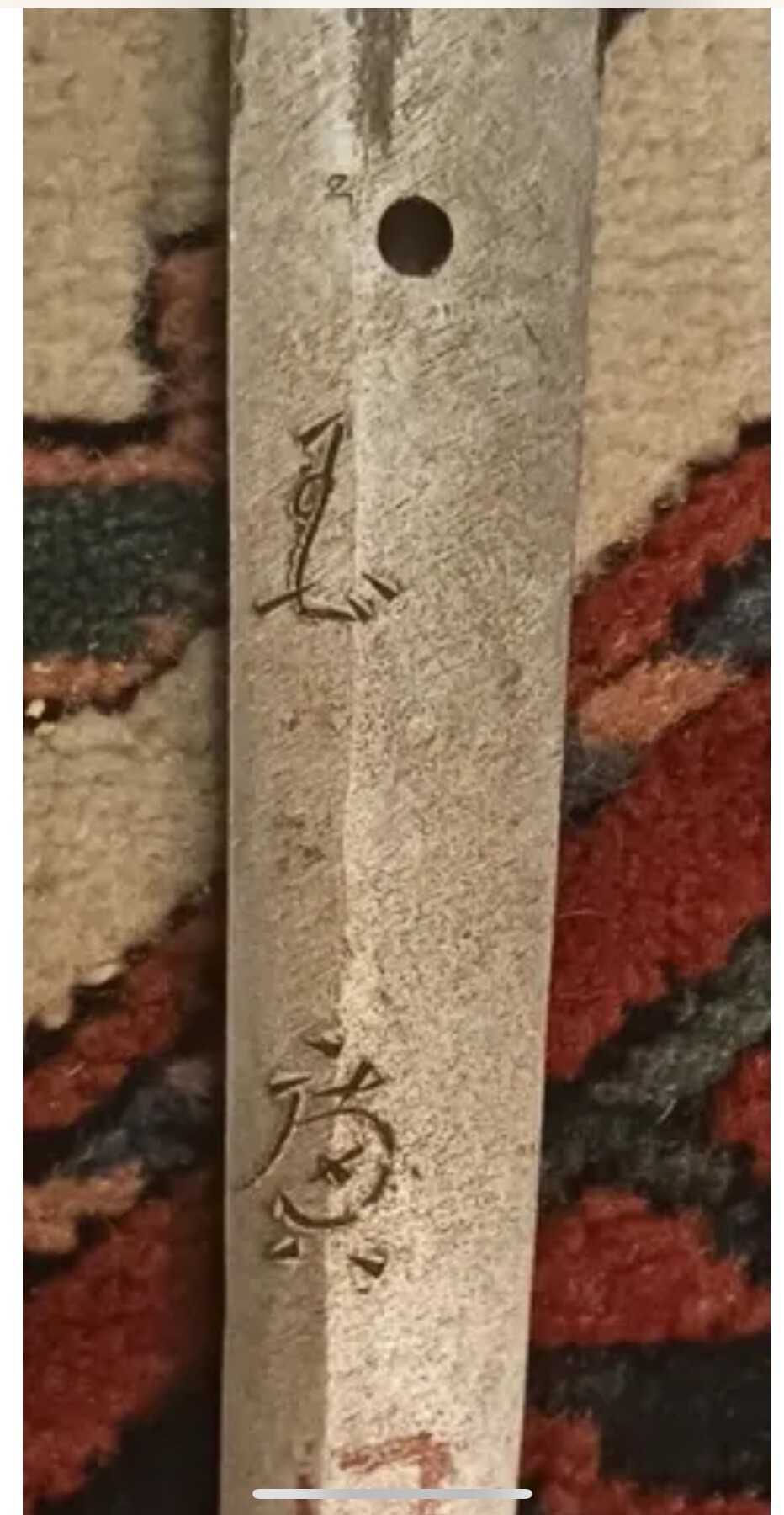

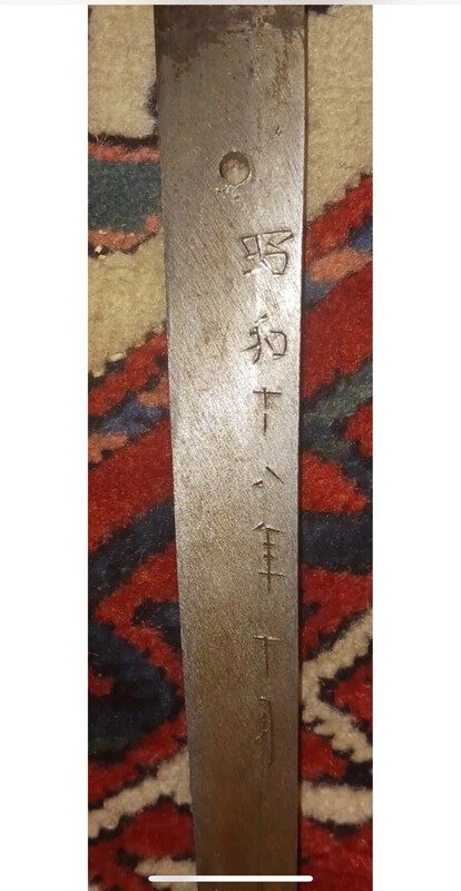

Josharic Posted March 2, 2024 Report Posted March 2, 2024 Hello! I was hoping you all might have some input on this inscription. It’s on a type 98 shin Guntō. I’ve looked through some of the pages here and they are really helpful. However, I can’t make much of this out. 1 Quote

Josharic Posted March 2, 2024 Author Report Posted March 2, 2024 I’m not sure how one can determine if the signature is authentic or not. Quote
John C Posted March 2, 2024 Report Posted March 2, 2024 I can see part of a nagoya stamp, so most likely machine made (is there a star stamp?). You can match the mei (signature) to known examples, however there would be no need to fake a signature on this type of blade, so most likely genuine. John C. Quote
ROKUJURO Posted March 2, 2024 Report Posted March 2, 2024 Josh, by the looks of the NAKAGO, it might even be a stainless steel blade for the marine, so not traditionally made. More pictures of the blade might confirm that. It is signed TACHI MEI as so many military blades. Quote
Bruce Pennington Posted March 2, 2024 Report Posted March 2, 2024 On 3/2/2024 at 3:50 AM, Josharic said: I’m not sure how one can determine if the signature is authentic or not. Expand I have 3 other of his blades, 2 of them Oct '43, and the mei is the same. I have not seen any Na-stamped blades that were traditionally made. 1 Quote
