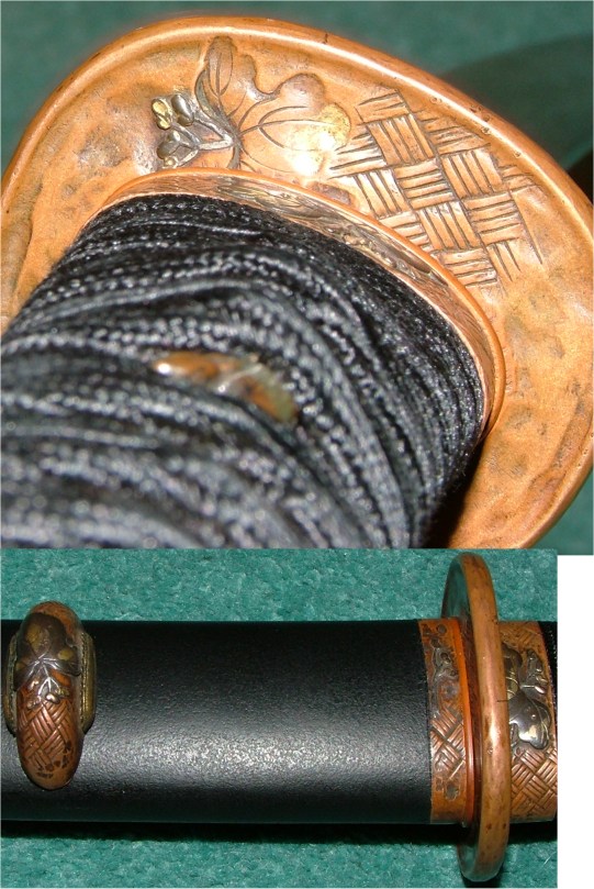

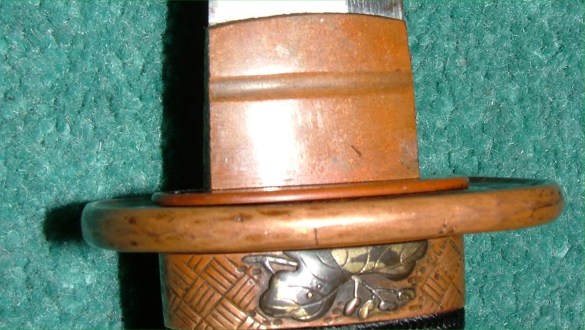

I have been reading up and studing. I am wanting to see if I am on the right path for what to look for in a sword. The art work is questionable, but the cloth wrap and blade struck my eye. Feed back? And yes its an Ebay one... I know the 99.99% rule. About .01% are real. And for those of you who saw my last post. I used the link with the same sword, and went after the guy with pay pal. Hopefully they get rid of the Jerk.
nor to me.
I can just advise you not to buy your first swords on ebay (unless you are really sure what it is). When you had the chance to look at real and good blades holding them in your hands (at a sword club or dealer) you will soon know what to look for and how to distinguish a fake from a real sword.
Just my two Euro-Cents ;)
cheers,
Martin
I'm pretty sure it's fake.
A higher quality fake..but fake anyways.
The wrap is bad. Those middle diamonds should be even and perfect..not sloppy like this one. The shape of the kogatana is wrong..the fittings are too flashy without the quality. The temper line shows no hataraki (features in nie and nioi) and I bet the tip gives it away too.
The nakago is wrong, and shows no age..the mei is sloppy.
Closer...but no cigar :)
Good for you to ask first though. Remember that if it is out of China...there is little chance you are going to find the exception to the rule.
Regards,
Brian

Definite fake..... another dremel mei I think....

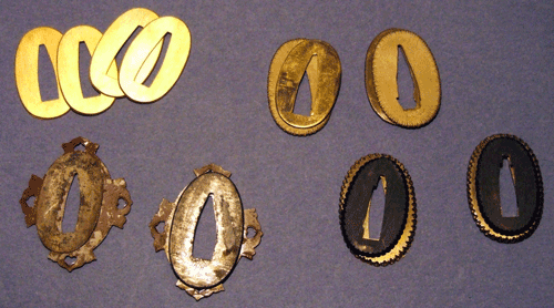

Hi Guido, I include a pic of some seppa I have. I forgot to mention the copper and foiled ones but also the steel ones found on Gunto. In the pic in the upper left corner are seppa purchased from a Japanese company to replace worn ones, on the upper right an older set. The bottom set is a contrasting set and the gunto set on the bottom left is steel. These are mostly brass. John

John, I know next to nothing about Guntô, but would be surprised if the Seppa were made of steel - hard to work with, and ineffective when it comes to their purpose. Also, modern replacement Seppa are for sure made out of copper, Namikawa - who probably has the widest selection of restauration items - doesn't sell anything else.
Anyhow, I looked the topic up in some books of mine, and they all say that Seppa are made of copper. Here's a quote from the only English lanuage source that I could find, B.W. Robinson's "The Arts of the Japanese Sword":
The Seppa, or washers, are a pair of oval metal plates encircling the tang on either side of the guard. Almost invariably of copper, plain, gilt, silvered, or loosely overlaid with gold or silver foil, on their outer surfaces they may be plainly polished or covered with light striations; their edges are usually milled or crenellated.

Hi Guido, I shall not belabour the point but I shall add a point or two. The gunto seppa are steel for sure, as they are highly magnetic. I do not collect gunto per say but have one just as a representative example, like the kaigunto I have that has the traditional European leather washer. I don't know if it was a later ww II saving copper thing or not. It wouldn't be a good shock absorber. The seppa that are new are from Namikawa, I know they are gold plated but did not know the core metal. The foil covered seppa I have definitely are copper inside, one is delaminating fairly bad. That set of black and brass seppa really are brass with the one being chemically blackened. Those were placed by a restorer and maybe they aren't traditional?? I have another sword that has a solid siver habaki that has some kind of alloy seppa that is bleeding into the silver. I can not get the tsuka off that one. Anyhow, thats what I have run into. John
