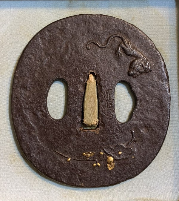

Iaido dude Posted February 26, 2024 Report Posted February 26, 2024 These are from among a small group of shakudo tsuba acquired while I was living in Singapore from 1998-2005. The remainder will be posted separately. I think I purchased them from eBay without any real knowledge about tsuba—not unlike my present state. They have just resurfaced from a forgotten old box at the back of a closet. I’d appreciate any help in identifying the materials, school, period, and current value. I intend eventually to offer these for sale to NMB members. My collecting focus is early sukashi tsuba especially the kanayama and owari schools. The plates are all iron. Tsuba #1 (78.6, 72.7, 4.8) The theme of this large tsuba is birds (geese above, plover below?) flying over waves with a beautiful deep dark brown patina (different exposures front/back), pleasing design, and skilled execution. The condition is excellent throughout. Tsuba #2 (72.7, 69.2, 4.7, 3.3 at mimi) Similar theme as # 1 with crane over waves. Silver and gold colored mixed metal with very high relief crane with finely detailed feathers on shoulders of wings. 1 Quote
Iaido dude Posted February 26, 2024 Author Report Posted February 26, 2024 Tsuba #3 (71.6, 67, 4.4 with raised edge on rim) Some kind of bird amidst reeds or cat tails ?). Quote
Iaido dude Posted February 26, 2024 Author Report Posted February 26, 2024 Tsuba, #4, 5 (Daisho) Katana (73.2, 68.6, 4.5, 4 at mimi) Wakizashi (69, 62.8, 4.0, 3.2 at mimi) Theme appears to be plum blossoms and reed (?). 1 Quote
Bugyotsuji Posted February 26, 2024 Report Posted February 26, 2024 Tsuba #3, usually these are quail and millet. Depiction of millet heads was considered to be a challenge for Kinko artisans. Quote

ROKUJURO Posted February 26, 2024 Report Posted February 26, 2024 Steve, you wrote "the plates are all iron" but which one is SHAKUDO (= not magnetic) ? The surfaces do not look typical for SHAKUDO. 2 Quote

Iaido dude Posted February 27, 2024 Author Report Posted February 27, 2024 11 hours ago, ROKUJURO said: Steve, you wrote "the plates are all iron" but which one is SHAKUDO (= not magnetic) ? The surfaces do not look typical for SHAKUDO. You've unmasked my complete ignorance. They are indeed magnetic. So, Shakudo inlays of varying alloys of copper, silver, gold on an iron plate? I need to read up a bit. 1 Quote

Iaido dude Posted March 2, 2024 Author Report Posted March 2, 2024 So is this Shakudo? Non magnetic. Hammered effect on back. Theme appears to be boat and oar under moon and stars. I have posted the other iron plates for sale. I’m just throwing up a price and will see how it goes. I’ll post this one as well. 1 Quote
Spartancrest Posted March 2, 2024 Report Posted March 2, 2024 4 hours ago, Iaido dude said: So is this Shakudo? I don't think the base plate for that tsuba is Shakudo, but some of the inlay is very likely, the hull of the boat and many of the reeds are the blue/black colour of Shakudo. Have a look at this link for the many types of alloyed metals used by the Japanese. https://en.wikipedia.org/wiki/Irogane The plate is most likely Yamagane or Suaka but the patina can often disguise the actual metal underneath. Quote
Iaido dude Posted March 3, 2024 Author Report Posted March 3, 2024 It turns out to be a brass plate with mixed alloy colored inlay/overlay. I get it now. Thanks. I listed all of these tsuba for sale now on NMB. Quote
